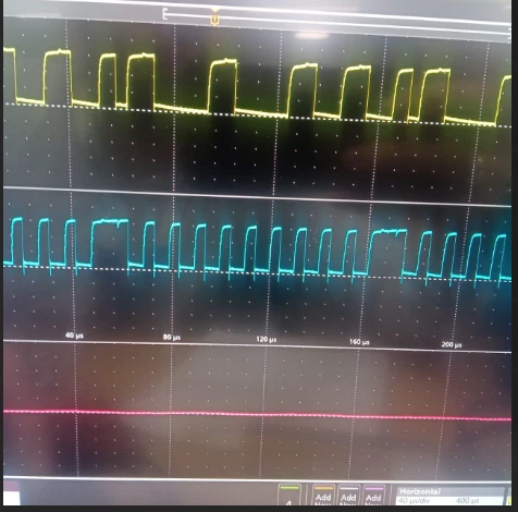

Hello @ishu ,
Could you please share a screenshot from the analyzer?

SDA-YELLOW ,SCL-GREEN,PIN P0 =RED

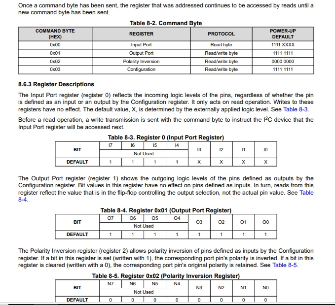

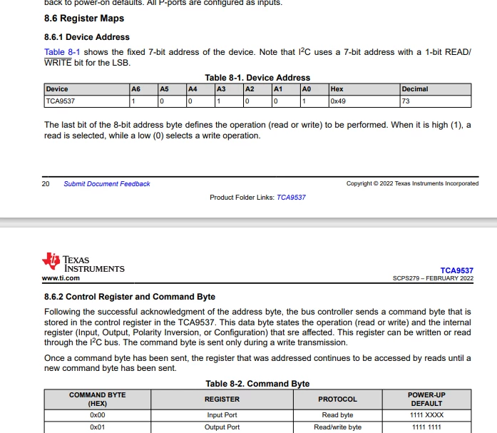

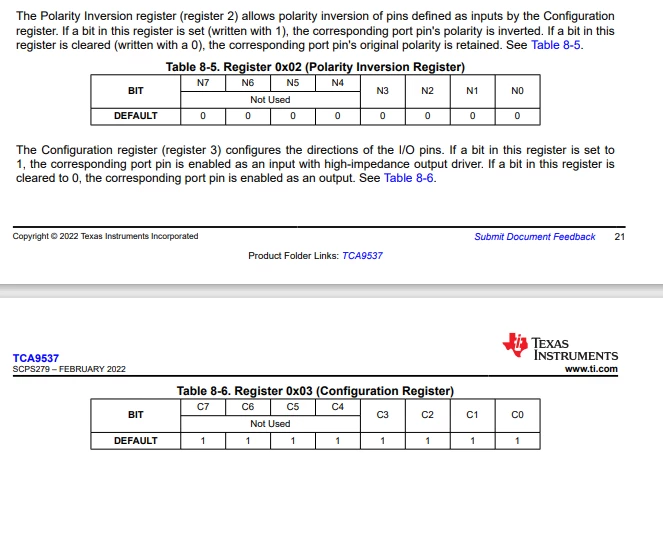

Verify the TCA register addresses your using relative to Table 8-2.
