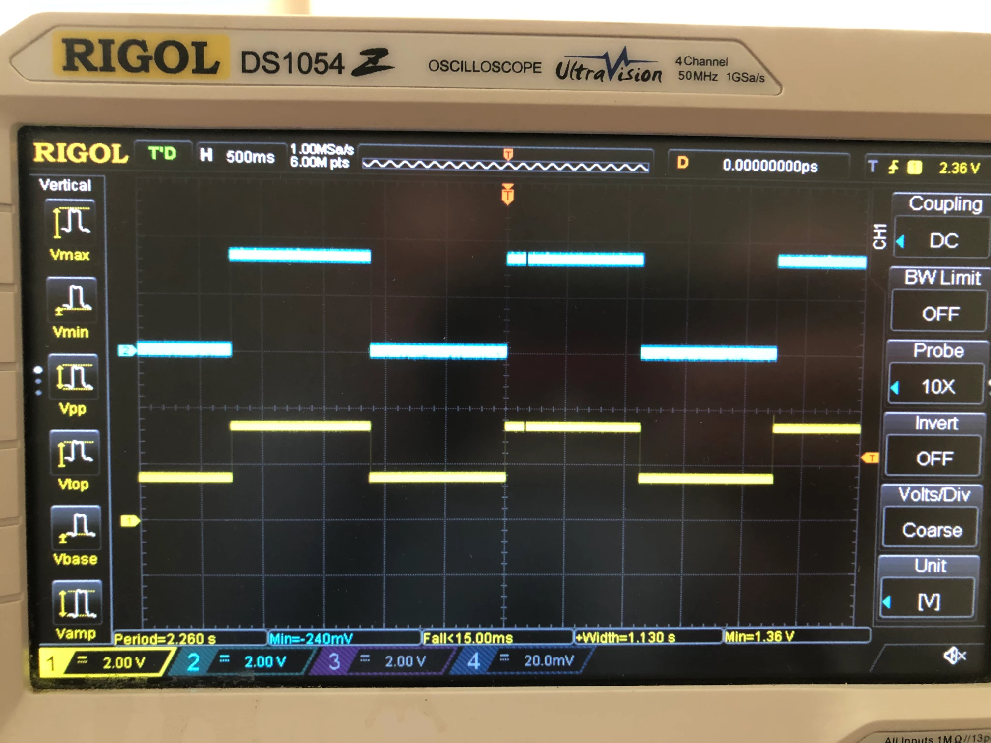

Here is the output I am seeing.  Blue is GPIO_11/PA7 which is working correctly.  Yellow is GPIO_23/PA8 which is not falling close enough to GND.
Suggestions?

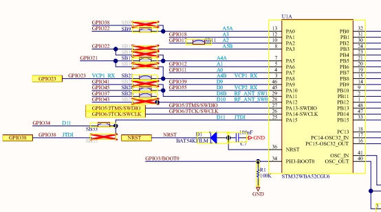

It appears that pin is connected to VCP1_RX:
CoopdisAuthor
August 15, 2024
Yes!  I see that in the schematic.
That said, a search for "VCP" in the reference manual turns up "0" hits.
It seem to have something to do with a UART... which I am not using in anyway... except perhaps as a debug interface?  But if it PA8 was being used for some debugging communication I would expect to see it wiggling, or for debugging to get screwy when I tried to toggle the PA8 pin. I don't see any of that.

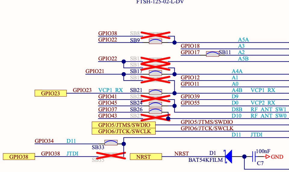

Perhaps I am looking at the wrong document?  I have been referencing this document...
https://www.st.com/resource/en/schematic_pack/mb1863-wba52cga-a03-schematic.pdf
On the 3rd page is the following diagram...
I'm still pretty new to STM32 but in my reading, this seems to show that if I remove SB21, then PA8 will no longer be connected to GPIO23?  It does not appear to indicate that the influence of VCP1_RX on PA8 will be effected at all?
Would you please explain a bit more about how removing SB21 would address this issue?
Thank you,
Bill
Chris21
August 15, 2024
Well, that schematic is not too clear, but it looks like removing SB21 could disconnect PA8 from everything; you should be able to confirm that looking at the actual board.
Removing SB17 and adding SB19 will connect PA8 to GPIO21.

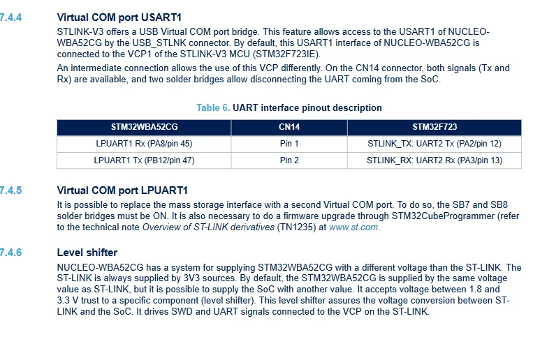

I believe VCP is a feature where a virtual COM port is produced by the STLink that allows your micro to send data via USART pins (e.g., PA8) which appears at COMx on your PC.
The user manual describes this, somewhat:
