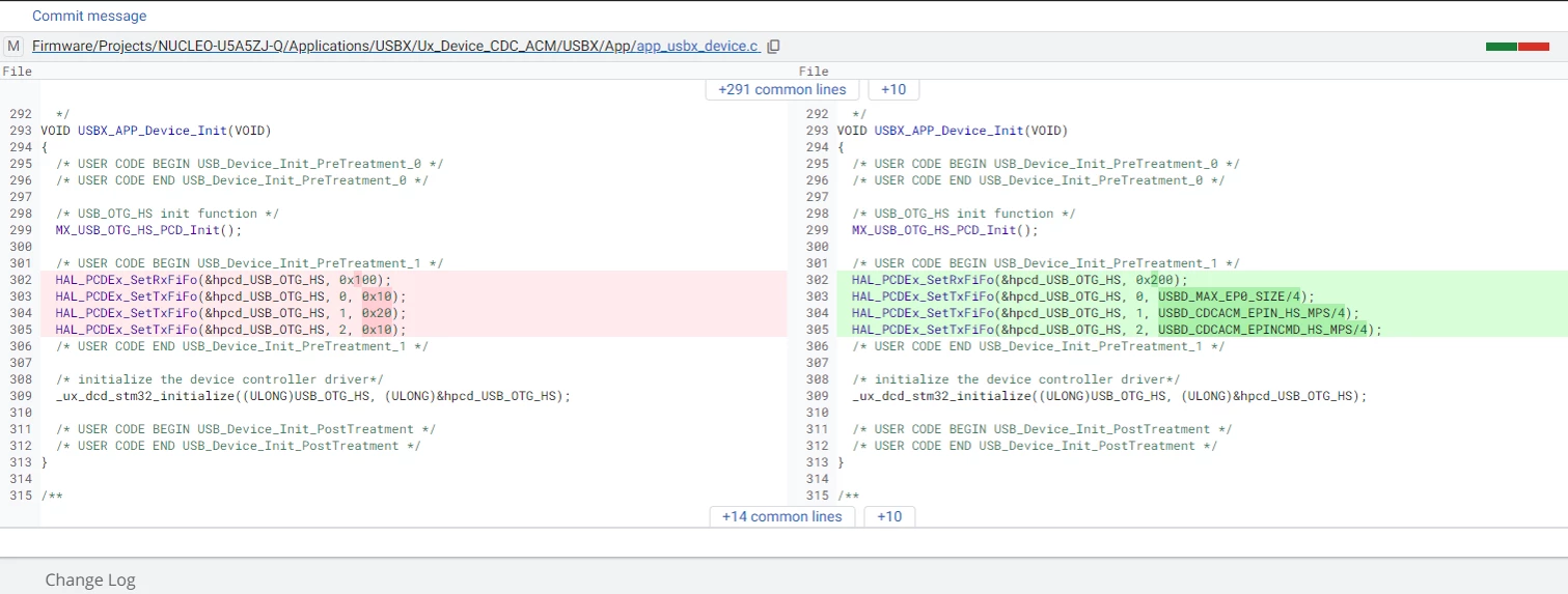

Hello @Kannan1,
Thank you for having reported this.
Our team is very aware of this issue and an Internal ticket number 171673 is submitted to fix the max packet size:
HAL_PCDEx_SetRxFiFo(&hpcd_USB_OTG_HS, 0x200);
HAL_PCDEx_SetTxFiFo(&hpcd_USB_OTG_HS, 0, USBD_MAX_EP0_SIZE/4);
HAL_PCDEx_SetTxFiFo(&hpcd_USB_OTG_HS, 1, USBD_CDCACM_EPIN_HS_MPS/4);
HAL_PCDEx_SetTxFiFo(&hpcd_USB_OTG_HS, 2, USBD_CDCACM_EPINCMD_HS_MPS/4);
(PS: Internal ticket number: 171673 in only for reference, not available outside of ST)
Thank you for your understanding while we work on this.

Kannan1
Kannan1Author
January 26, 2024
@Imen.D Thank you very much for the quick reply. Everything works fine by increasing the size of tx fifo 1, which is the BULK Endpoint IN for CDC-ACM. Now I can work with a larger Pkt size of 2048 in my code.
#define MAX_PKT_SIZE 2048
Between, Why you have divided the max pkt size of EPIN_HS (which is 512 bytes maximum for HS) by 4
Could you explain it please? Also what should be the optimum size of this FIFO for maximum throughput?
Thank You
January 26, 2024
Hi @Kannan1 ,
The whole size is 4096 bytes, divide it by 2. The half is for the Rx FIFO and the other half for all Tx FIFO .
The size set for the FIFO is the size of the EP divided by 4 when working on single buffering.
Also, you have to check that all the sizes of Tx FIFO added together should not exceed 2048, because from the beginning we only made 2048 bytes available for all the Tx FIFO.

As @Imen.D  suggested, I have kept the total Tx fifo size to 2048 bytes.
 HAL_PCDEx_SetTxFiFo(&hpcd_USB_OTG_HS, 1, /*USBD_CDCACM_EPIN_HS_MPS/4*/2030);
 I think the maximum packet size sending for FS configuration is the 64 bytes and for HS is 512 bytes. I was able to execute the function ux_device_class_cdc_acm_write with max size of 2048 bytes as requested_length. So internally this API will fragment the 2048 bytes to 4*512 bytes and send it.
