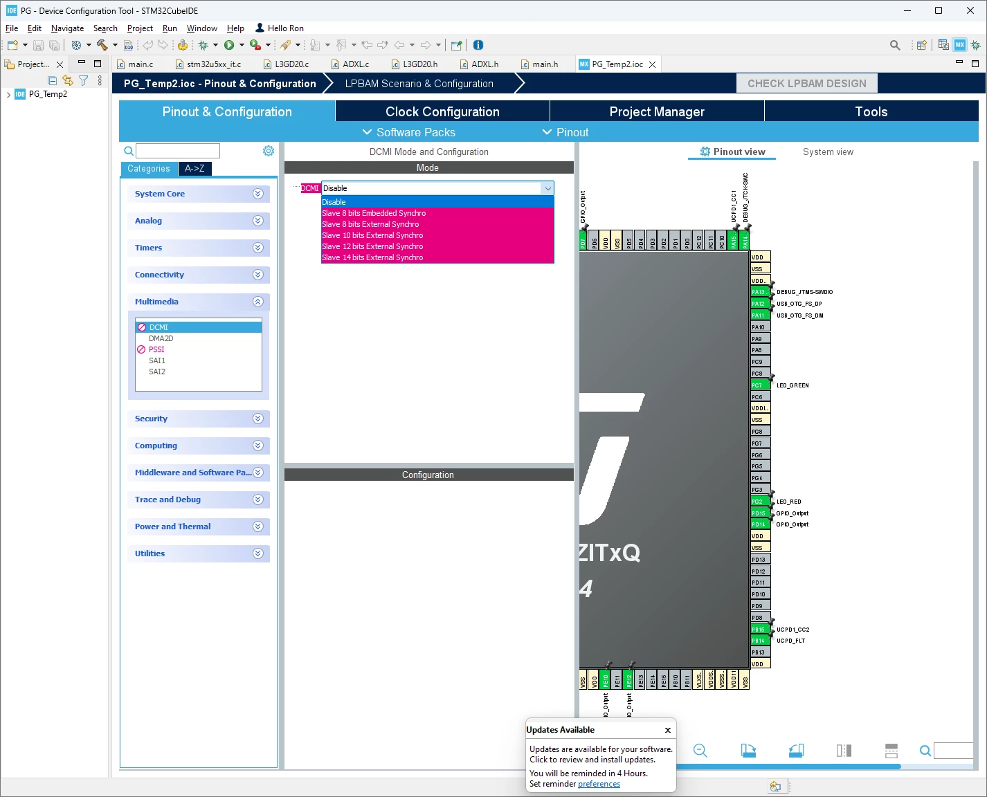

I'm sharing the MX configuration screen for the U575's Nucleo

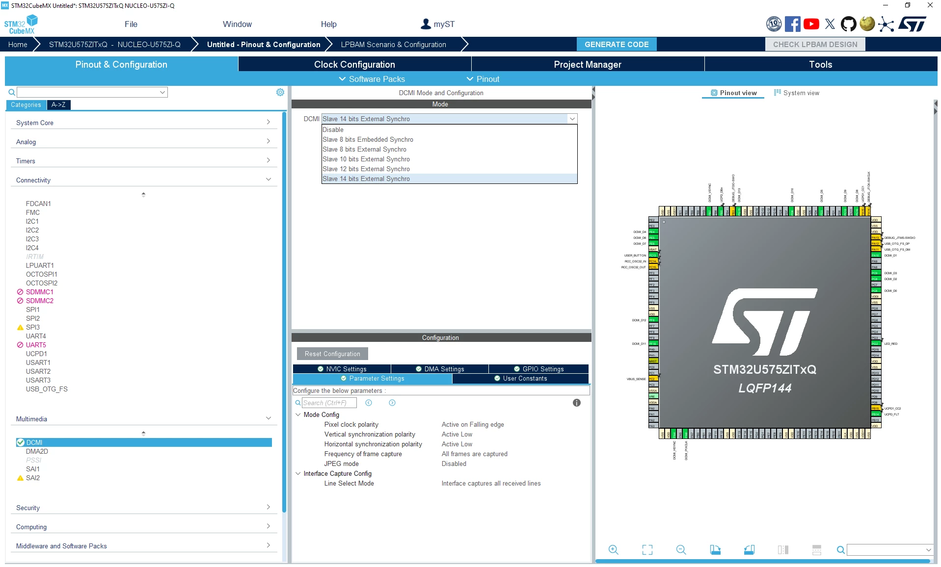

Hello @ElectroManiac
Just put the Cursor on the DCMI Mode that you want to use. Then, a pop-up will appear. This pop-up will show you how the pins that are posing the problem. Just disable the function of each Pins of those and the DCMI will be available for use:
PS: Make sure to use the Last Version of STM32CubeMX (V6.11.1).
Best Regards.
