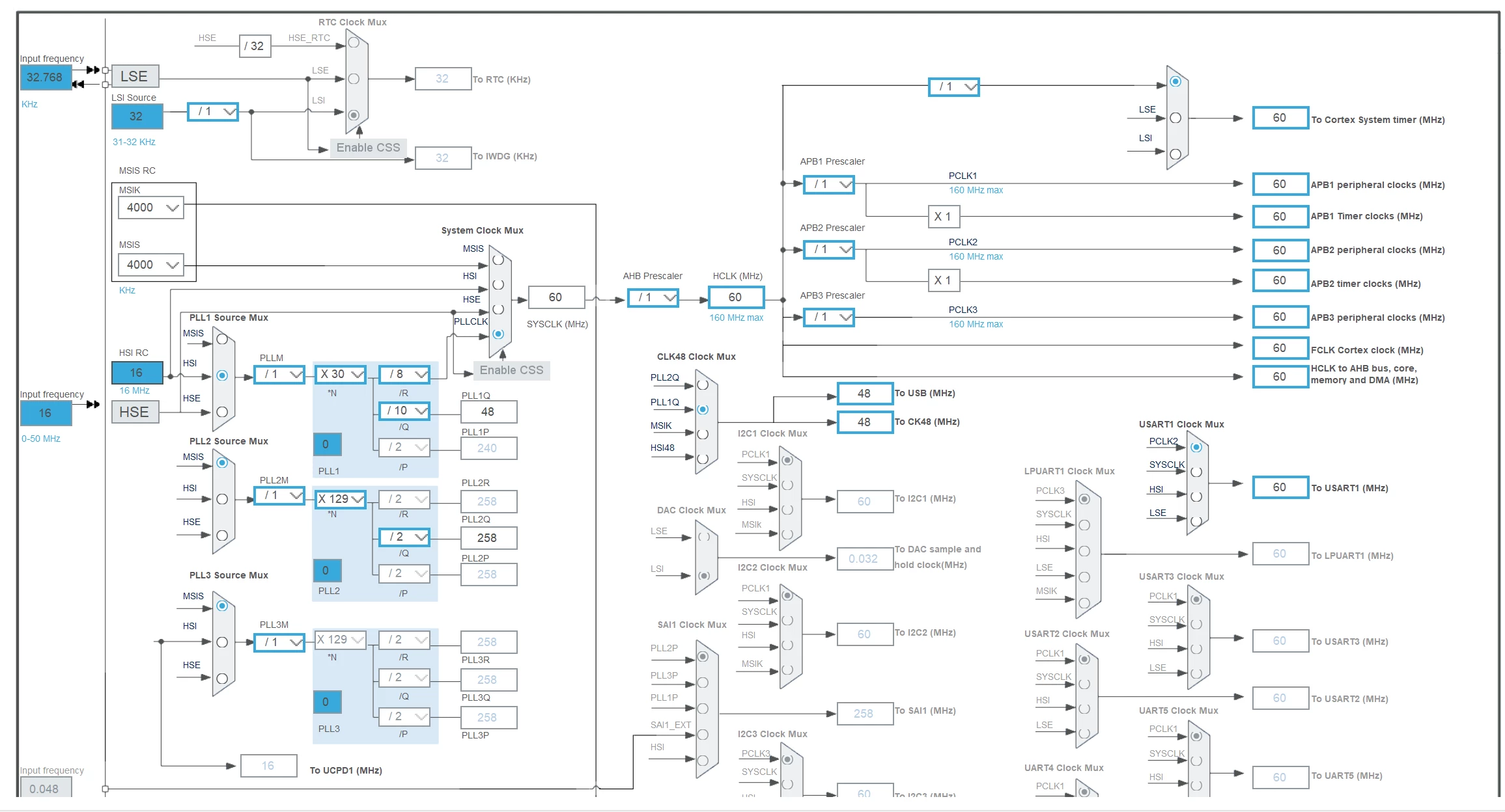

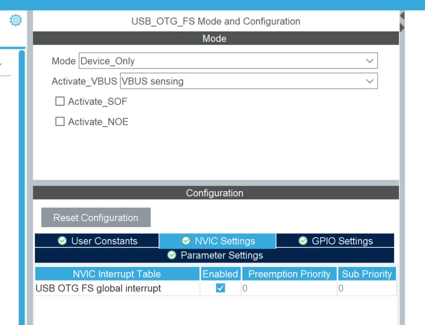

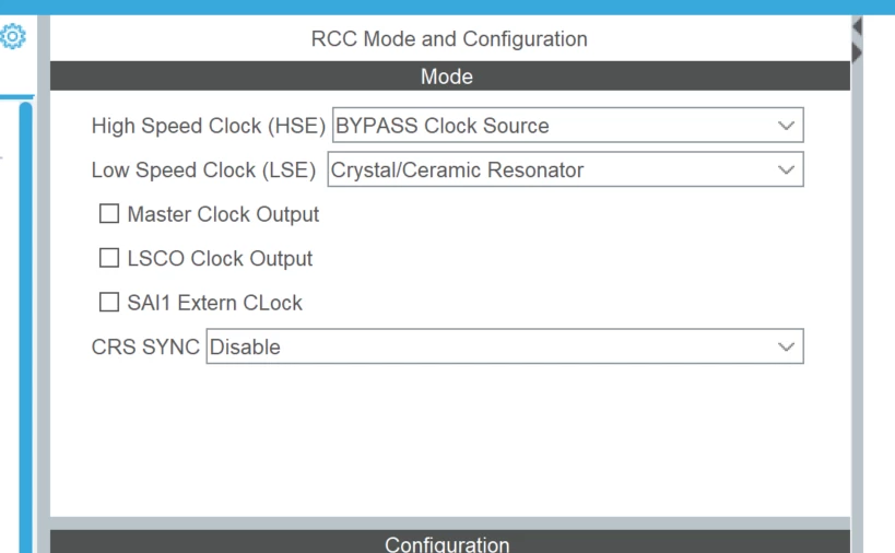

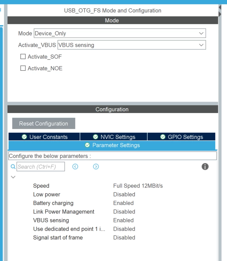

In the .ioc file, the USB_OTG_FS is set in "Device_Only" mode, the VBUS is activated and the USB OTG FS global interrupt is enabled. In the RCC, the HSE is set as BYPASS Clock Source, and the LSE is set as Crystal/Ceramic Resonator. In the Clock Configuration settings, I checked that CLK48 Clock Mux returns 48 MHz to USB. In the images below you can see the aforementioned .ioc settings, while the .rar is the last project described.

 PeriphClkInitStruct.IclkClockSelection = RCC_CLK48CLKSOURCE_HSI48;
I confirm an issue on myside, and it is linked to the implementation. This issue is reported to dedicated team.

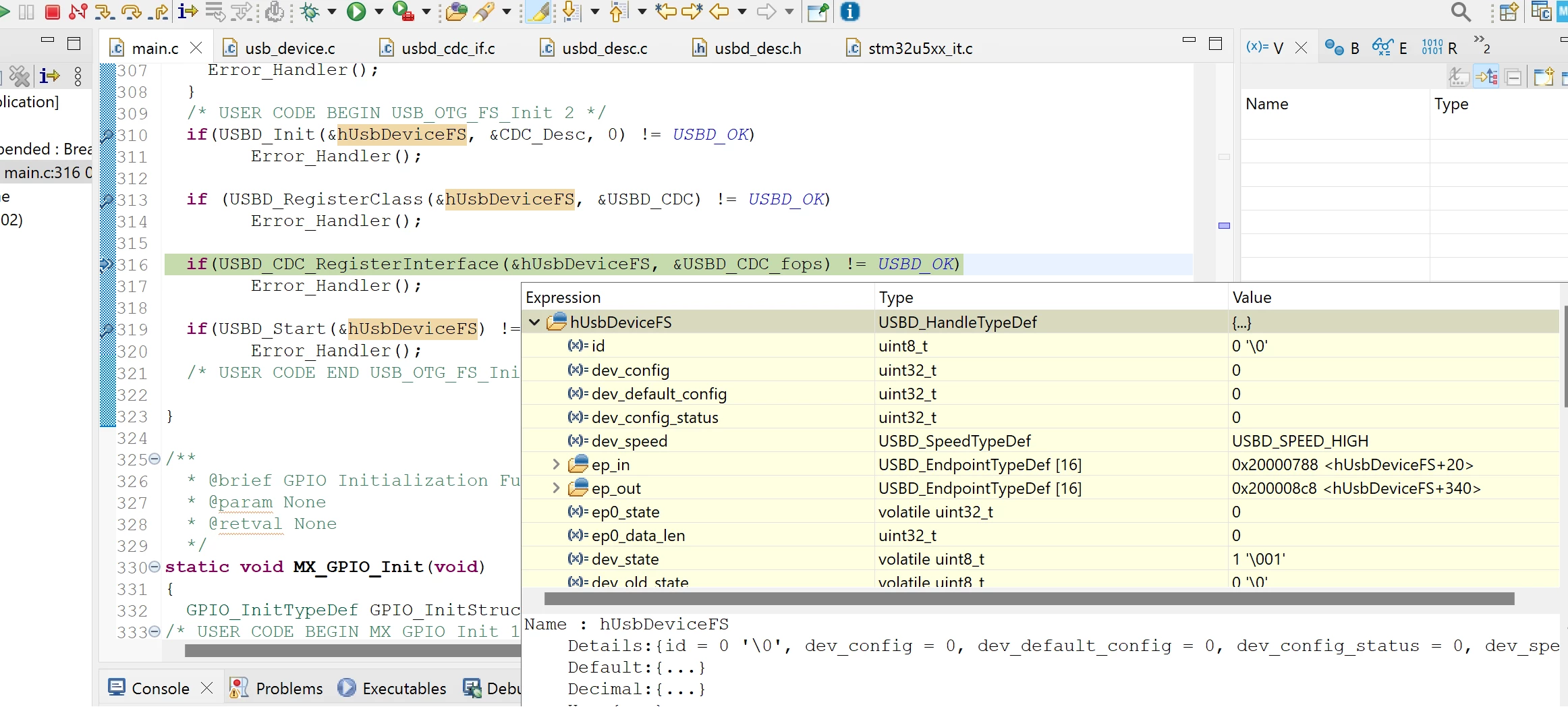

In the meantime, working on the same project I previously shared with you, I noticed that in the MX_USB_Device_Init() the dev_speed variable of the &hUsbDeviceFS handle is set as USBD_SPEED_HIGH instead of USBD_SPEED_FULL.

Hello @IlariaCrupi
If I understand correctly now the issue, your code now goes to Error Handler when trying to run line "((USBD_CDC_ItfTypeDef *)pdev->pUserData[pdev->classId])->Init();" which is in USB_CDC_Init() function of usbd_cdc.c file.
You need to initialize your configuration correctly (dev_speed  ...). I suggest you check through usbd_cdc.h
  1. data IN and OUT,
  2. command packet size,
  3. the device string descriptors,
  4. size of temporary buffer ...
    I hope this will help you, Otherwise, I suggest if your first questions were answered please close this thread and open new ones if still having issue.
