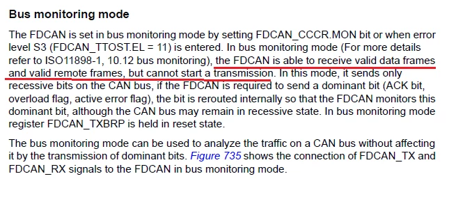

Hello @floppy and welcome to the community,
As I can see from your code, you are using Bus monitoring mode:
 hfdcan2.Init.Mode = FDCAN_MODE_BUS_MONITORING;
According to the reference manual, in this mode FDCAN cannot start a transmission.SofLit_0-1721290404372.png
So try to use Loop back mode (Internal or External)

floppyAuthor
July 19, 2024
Hello SofLit,
thanks for your help.
That was my mistake, I tried to toggle the TX pin, so the bus monitoring mode was still in the programm code.
In both external and internal loopback mode, I receive the sent blocks, but I see no behaviour on the external TX pin. I am using Pin PB12 and PB13.

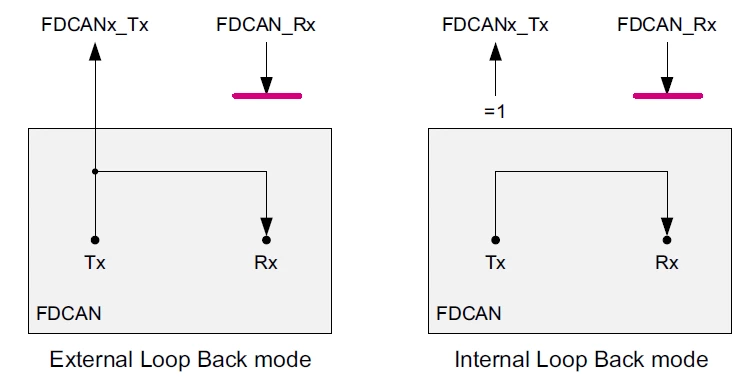

You can see the sent frames on Tx pin only in External loopback mode.
