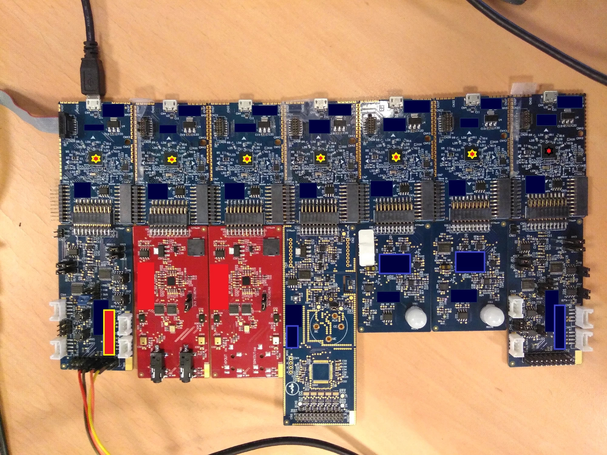

S.Ma
Principal
May 7, 2020 4:42 AM UTC
In general, max slave speed is 1/2 of master's ==> DIV4
When above 20 MHz, you will need a scope to check signal integrity (especially through flying wires)
The GPIO SPEED parameter needs to be tuned.
Application test: 12MHz SPI over a meter and talking to 12 slaves through daisy chain connector is working fine. (SYSCLK 48MHz on STM32L4R)
