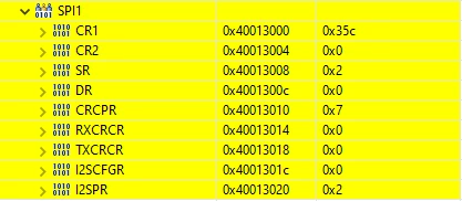

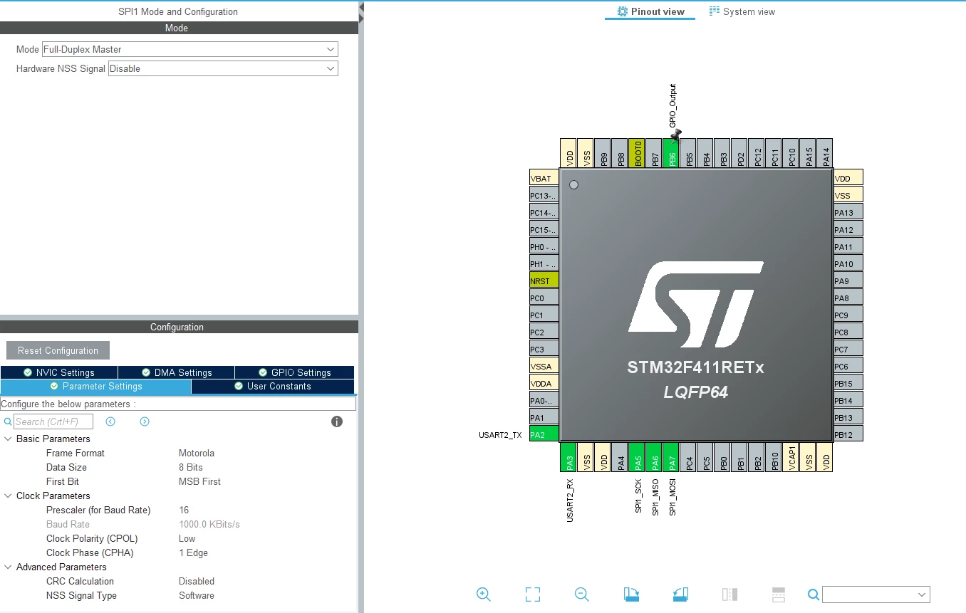

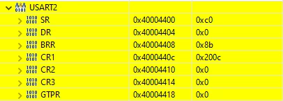

If I configure the same pins used by SPI or USART as simple gpio outputs, I can see them toggling with the logic analyser. but when I configure them as SPI (alternate function) or USART they are not working as expected. I have tried changing SPI creating an stm32 project, configuring the pins through the GUI and using the HAL_APIs. the result is the same : I can see the pins toggle when configured as gpio outputs, I can't see anything when configured as SP or USART.
I have checked with the debug and the SPI and USART registers are configured as expected.

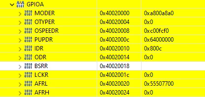

Post, together with the relevant GPIO registers content.

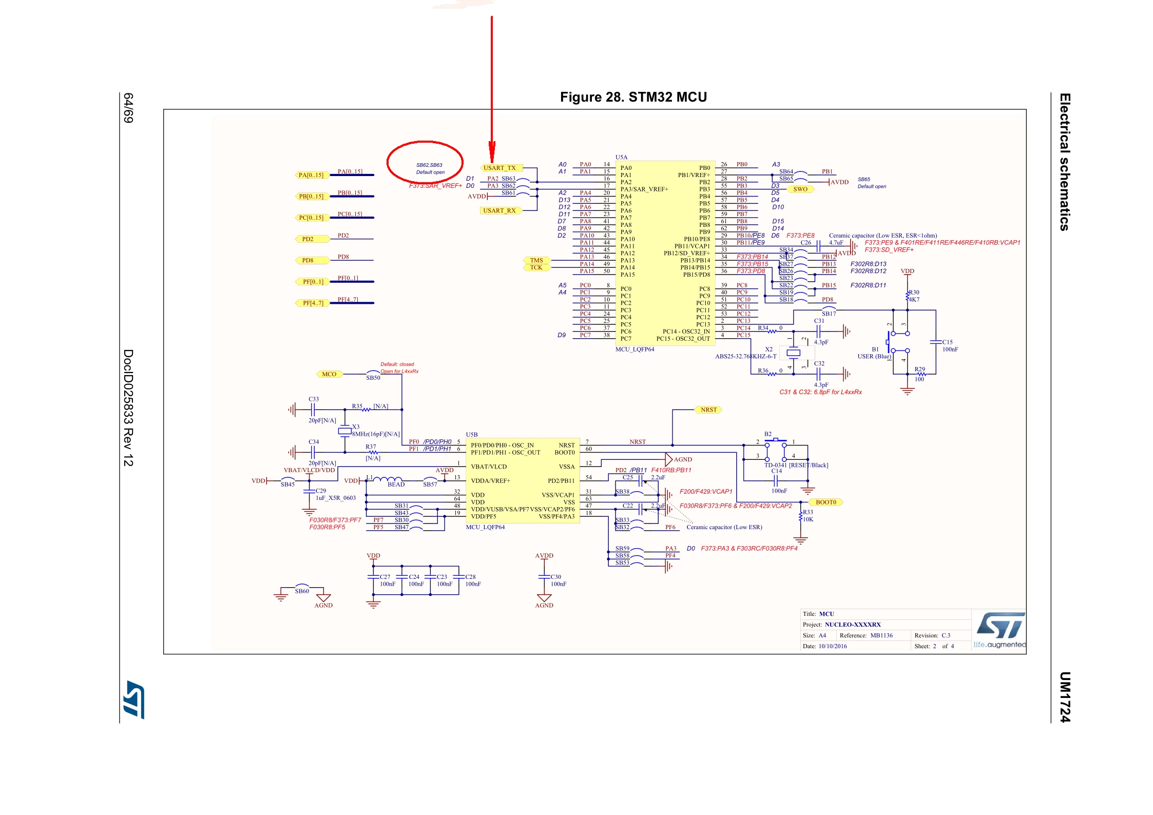

Then the logic analyzer is not connected to pins PA2 and PA3.
They may be brought out to the pinheaders through jumpers/solder bridges which are not connected by default.
