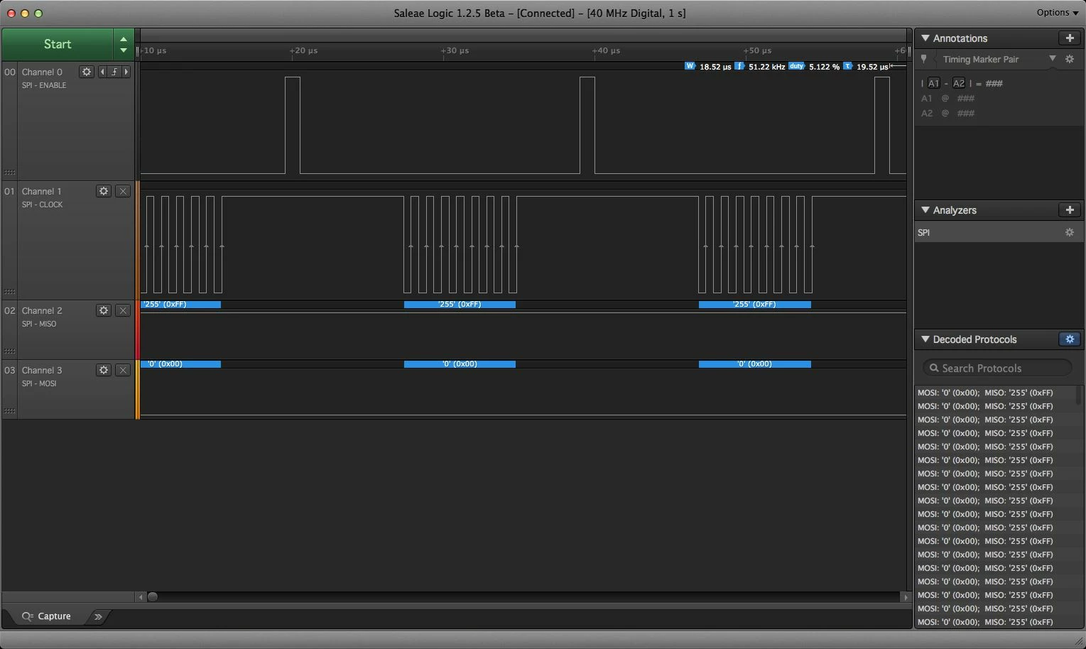

Hi, i wrote a simple program in Keil uVision to test the HAL SPI driver
The logic analyzer shows that there is clock activity as expected but the MOSI ouput stay low all time even with pull-up enabled (see attached screenshot)  Surely i made some mistake somewhere.
Here is the listing. Can you help ?

byte = 0xAA;   // data to be transmitted  0b10101010
while(1) {
HAL_GPIO_WritePin(GPIOA,GPIO_PIN_4,GPIO_PIN_RESET);   // assert slave select low
HAL_SPI_Transmit(&hspi,&byte,1,4);
HAL_GPIO_WritePin(GPIOA,GPIO_PIN_4,GPIO_PIN_SET);     // assert slave select high
