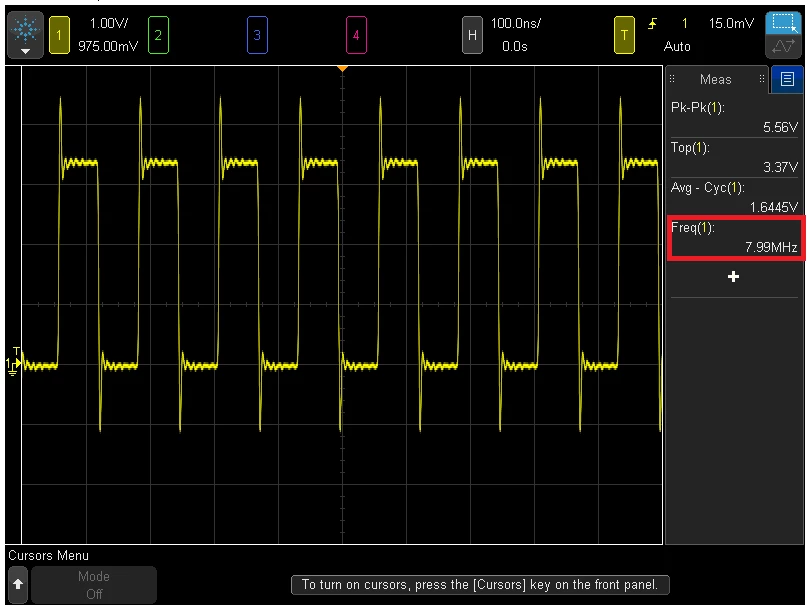

Hi, I just got the stm32f303k8 nucleo board to play with! I'm trying to enable the HSE in order for the board to use the on-board oscillator (X2), however it doesn't seem like it wants to turn ON. I'm using Keil as the IDE and here's my code:

    Hi William,
    I advise you to take a look on
    http://www.st.com/content/ccc/resource/technical/document/user_manual/e3/0e/88/05/e8/74/43/a0/DM00231744.pdf/files/DM00231744.pdf/jcr:content/translations/en.DM00231744.pdf
    : user manual for STM32 Nucleo-32 board.
    On table 5, the OSC clock configurations is given.
    Please verify the following solder bridges connections:
    • SB4 : ON
    • SB17 : OFF
    • SB6 : OFF
    • SB8 : ON
    • SB5 and SB7 : OFF
    This configuration connects the MCO from ST-LINK to OSCIN(PF0) -> HSE BYPASS
    The figure below contains the HSE probed on MCO_PA8 pin.
     As you can see, a 8MHz clock is provided.
    Verify the solder bridges state and give me your feedback.

    Hello William,
    In your description you said: 'however it doesn't seem like it wants to turn ON.'
    Could you please be more precise. What are the encountered symptoms?
    Is your program stay blocked in this loop:
    while( (RCC->CR & RCC_CR_HSERDY) == 0); ?
    Best regards,
    Khouloud.
    William Huang
    Dec 22, 2016 2:23 PM UTC
    Posted on December 22, 2016 at 14:23
    Hi khouloud, yes it's being blocked at waiting for the hse ready flag to be set

    Hello William
    The order of the operations which you do in the HSEConfig() function is obviously wrong.
    At first you set the turned off oscillator as system clock and then you are trying to turn it on.
    I would recommend to have a look at our examples to see the correct flow.
    Please find below the code snippet from STM32F0 HSE_Start example (basically the same for STM32F3).
    Note that there is the bypass mode used, because the nucleo-F303K8 board doesn't have an external crystal assembled.
    The high speed clock is provided from the ST-Link MCU via MCO (Microcontroller Clock Output).
