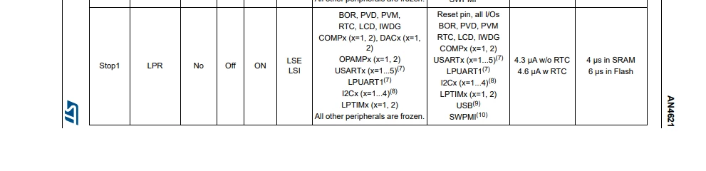

Nucleo-L4R5ZI-P STOP1 mode current consumption is not matching datasheet
I am using NUCLEO-L4R5ZI-P board, I have measured current consumption by using example project (PWR Mode: STOP1) and I got the following readings :
Practically STOP1 : 1.19 uA
Datasheet STOP1 : 4 uA
Why I am not getting same value mentioned in datasheet is there something wrong?

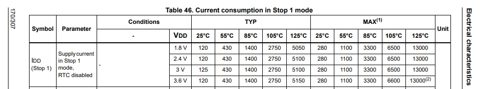

Hello @Brajp.1​,
When checking the STM32L4R5ZI datasheet, the Current consumption in Stop 1 mode is represented in the following table:
Can you precise which datasheet you are working with and the mode you are using?

Brajp.1
Brajp.1Author
Jul 2, 2021 11:10 AM UTC
Brajp.1
Brajp.1Author
Jul 2, 2021 11:18 AM UTC

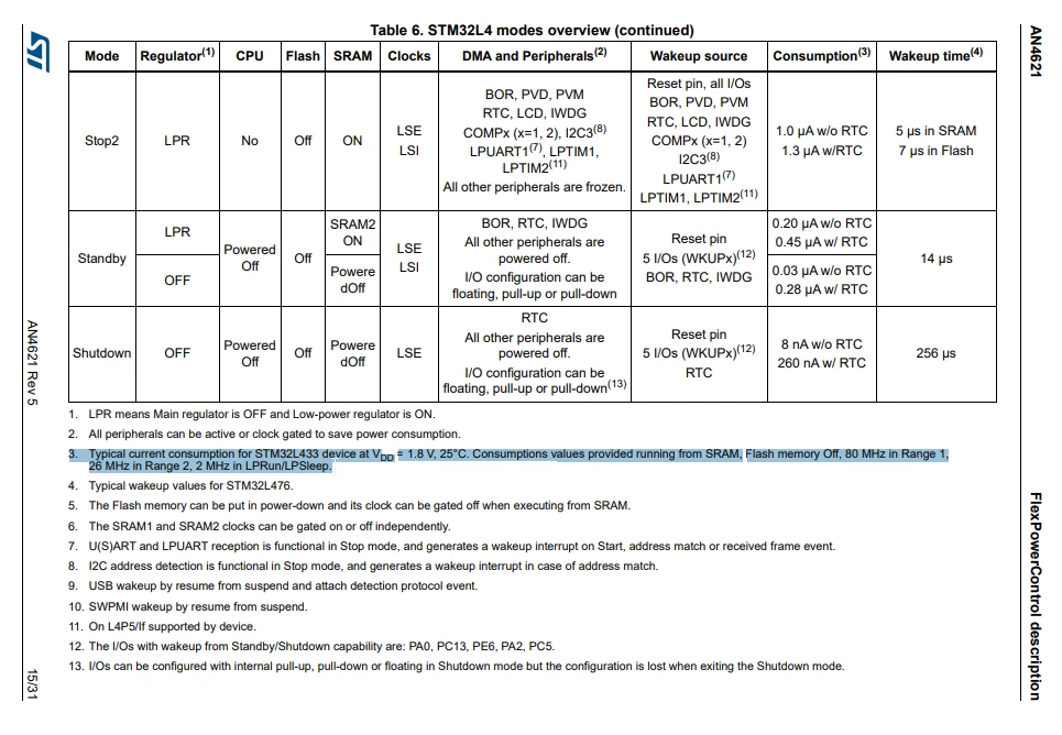

ChahinezC
Jul 2, 2021 12:15 PM UTC
The table of the application note you are referring to concerns the L4 product while you are working with the L4+, please check the note I highlighted in the screenshot below:
To check the correct values of the power consumption I advise you to refer to the datasheet of STM32L4R5xx since it contains different use cases presented in the table 46.
