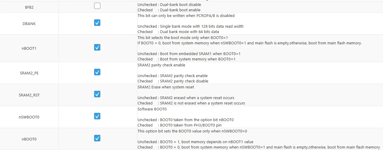

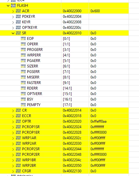

retcode gets set to 0x20000 which corresponds to PEMPTY flag. However the area (bank 2) which I try to erase is not empty when i look at it with StmCubeProgrammer. Furthermore, although I see HAL_FLASH_GetError() return 0x20000 looking at SFR for Flash in the debugger does not show PEMPTY set:0693W00000Nqfg9QAB.pngI'm not sure if OB are important here but these are my current settings:
0693W00000NqfgEQAR.pngAny pointers or ideas appreciated. Thank you.

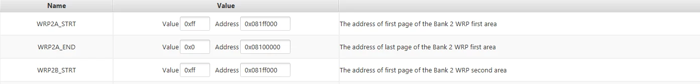

Hello @devtty​ ,
Thank you for your feedback,
I suggest checking the WRP Option Bytes .
If the write protection is disabled for bank 2, could you try to do the erase using CubeProgrammer and see if it works ?
Your response will better help us in diagnosing the issue.

Hello thank you for the respone. Within stcube programmer here are my values:
I have done a full chip erase a couple times now.
Thanks.
