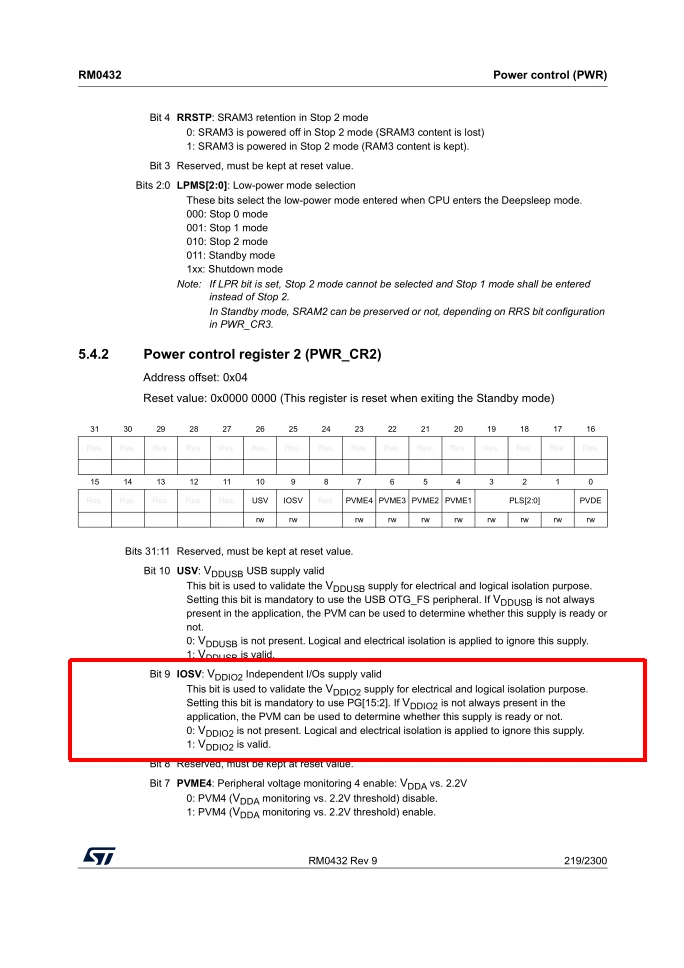

waclawek.jan
waclawek.janBest answer
March 26, 2023
PG2 to PG15 pins are supplied not from VDD but from VDDIO2, and you have to switch the VDDIO2 domain on by setting PWR_CR2.IOSV

waclawek.jan
March 26, 2023
HYuan.1
HYuan.1Author
March 26, 2023
Thanks for help. This issue is solved by calling  "HAL_PWREx_EnableVddIO2();"
as JW pointed out "PG2 to PG15 pins are supplied not from VDD but from VDDIO2, and you have to switch the VDDIO2 domain on by setting PWR_CR2.IOSV"
