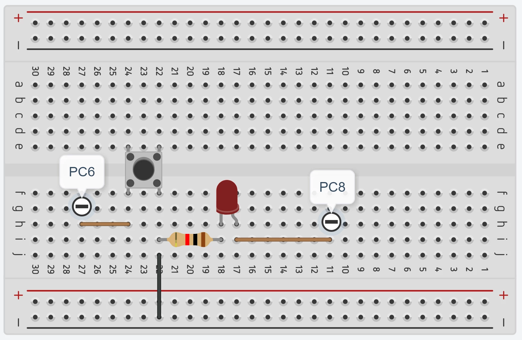

I am using a NUCLEO-L476RG development board, I am learning to write GPIO drivers for STM32 family I am implementing a simple logic in which I need to turn on an LED when a push button is pressed.
I have a strange issue: The Bread board LED turns ON when the line temp=10 line is commented, it doesn't turn ON when the line temp=10 is uncommented.
What could be the issue?
The issue doesn't solve after changing the location of the line
The connection to the bread board looks like the image below , I have not configured any clock source in my code, meaning it would take the default clock(MSI at 4MHz) for its operations. I have powered it using the Mini USB0693W00000JNq9WQAT.png

Do you have a debugger?
Does the Nucleo LED keep toggling?
What happens if you make temp global, i.e. define it outside main()?

Hi @Community member​
Declaring the variable as Global variable solved my issue..
Can you tell me what difference it makes?

Hi
Thanks for the support,
The issue was I had to reset the unused configuration register such as the OTYPE etc to their default values for the GPIO configured as input.
Since it was not set the driver had set wrong values in the OTYPE register
The issue is solved now..
