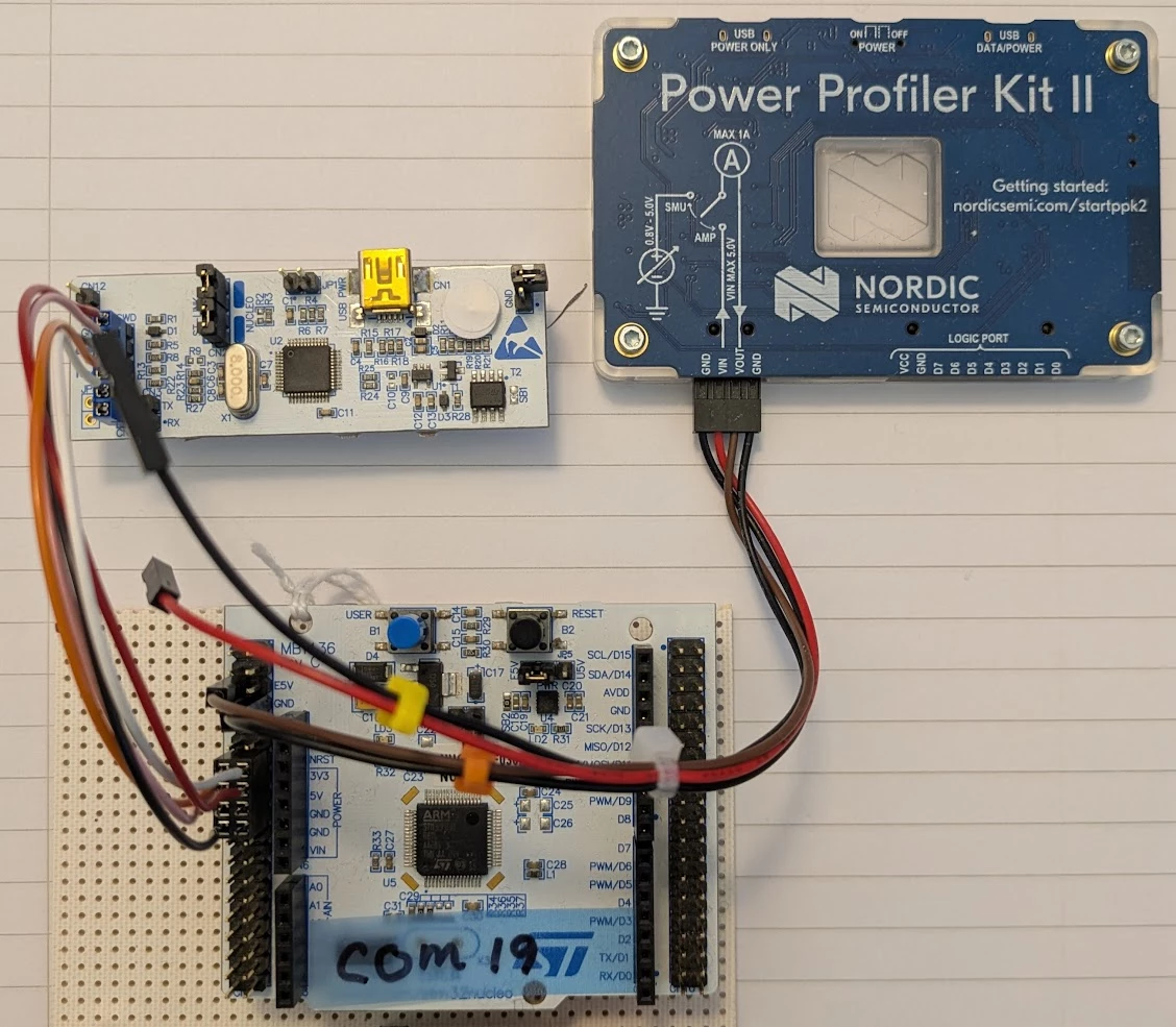

NUCLEO-L452RE-P current consumption way more than expected - ~ 20µA - 30µA in Shutdown Mode
Hello everyone,
I am currently working with the NUCLEO-L452RE-P board and trying to evaluate its low-power performance.
I am measuring the current consumption using jumper JP6 (IDD measurement point). The jumper is removed and a multimeter is connected in series.
My setup:
  • Board powered via ST-LINK USB (then power-cycled before measurement)
  • No external peripherals connected
  • All GPIOs configured as analog, no pull-up/pull-down
  • Debug set to "Serial Wire" (no trace)
  • No RTC or wake-up sources enabled

Expected behavior:
According to the datasheet, the STM32L452RE should consume in the range of  ~67nA in Shutdown mode
Observed behavior:
I consistently measure around 20–30 µA on JP6 in Shutdown mode. The value is not perfectly stable and fluctuates.
Questions:
  1. Is this expected behavior when using the NUCLEO-L452RE board?
  2. Could the measured current be dominated by on-board components (e.g. level shifters, ST-LINK interface, SMPS, etc.) even when measuring at JP6?
  3. What additional steps are required to measure the true MCU-only Shutdown current on this board?
I want to keep using the NUCLEO board if possible, but need to reduce the current significantly for a low power application
Any guidance or experience with accurate low-power measurements on this board would be greatly appreciated.
Thank you!
P.S.
I have also attached my .ioc file and a photo of my measurement setup
Edit: I observe approximately the same current consumption when using Stop2 mode which is very strange to me...

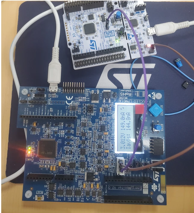

Hello @HelloWorld4
I see that you missed some steps that you should establish before calling the HAL_PWREx_EnterSHUTDOWNMode function.
Here is a project that configures the STM32 Nucleo-64 board (NUCLEO-L452RE-P) to enter shutdown mode or standby mode after toggling the LED for 10 seconds. This configuration results in power consumption at the nanoampere level.
You can base your implementation on this example.

@HelloWorld4 you need to check the schematics very carefully for all possible leakage paths.
I suggest that you break-off the ST-Link section of the board to be absolutely sure that there's no leakage to the ST-Link.
For example:
(as shown, the ST-Link part is connected via wires for programming - disconnect for current measurements!)
