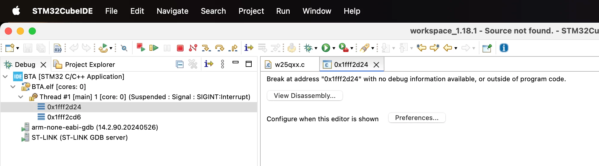

I am developing software on the Nucleo-L433RC-P board but have a strange situation when debugging.
The first time I debug, the software does not run and I get the following error...
Break at address "0x1fff2ce8" with no debug information available, or outside of program code.
Break at address "0x1fff2cd6" with no debug information available, or outside of program code.
As shown in the screenshot below...
However, the second time I debug it works correctly.
Why does it not work correctly on the first debug, but then works correctly on the second debug ?
I have tried two different boards (one of which is brand new and never been used) but the behaviour is the same, so it must be a software issue.

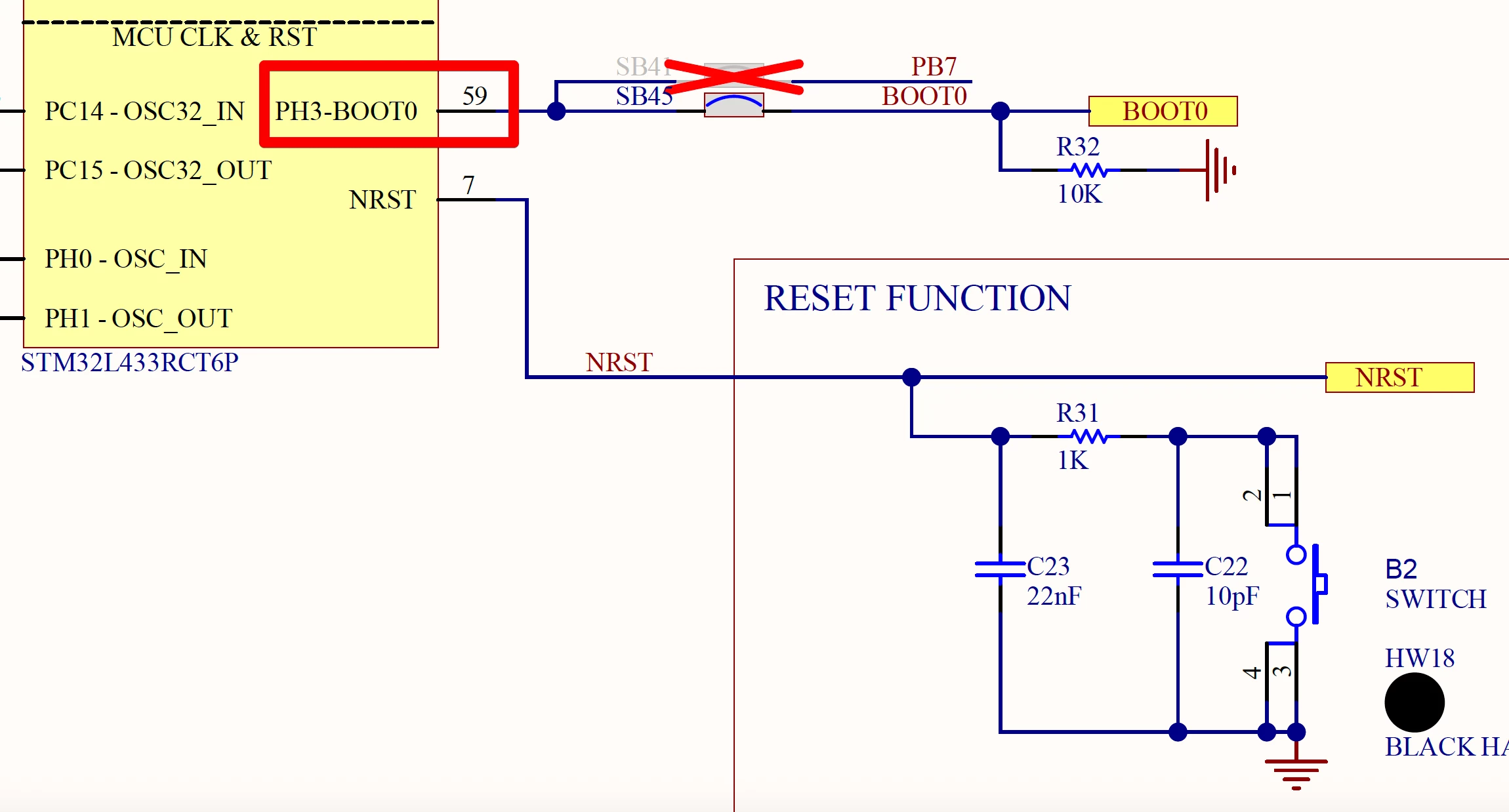

That's from the ROM, so either the BOOT0 is HIGH, or the FLASH is blank and doesn't contain viable vector table, so goes to ROM code instead.
freeflyerAuthor
Senior II
Jul 16, 2025 9:03 PM UTC
BOOT0 is pulled low via a 10k resistor on this board and the pin on the header is floating

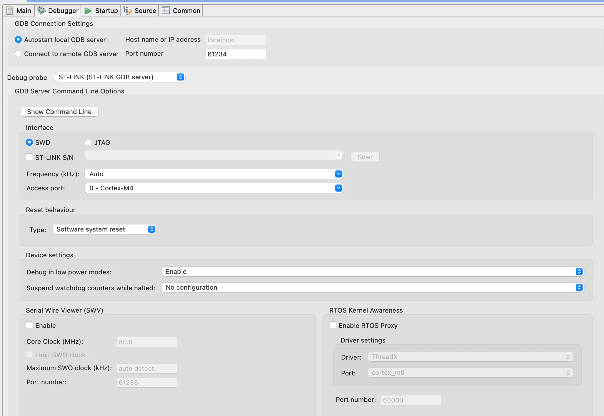

Well, depends on the sequencing, but if you erase, and reset, this determination may be sticky and require a power-cycle to clear on some STM32 parts. Relates to how it latches option bytes, and protects against code recovery attacks.
You'd want to look at the connection options chosen in the programmer.
The debugger might be resetting to gain control of the part, or to get a clear start.

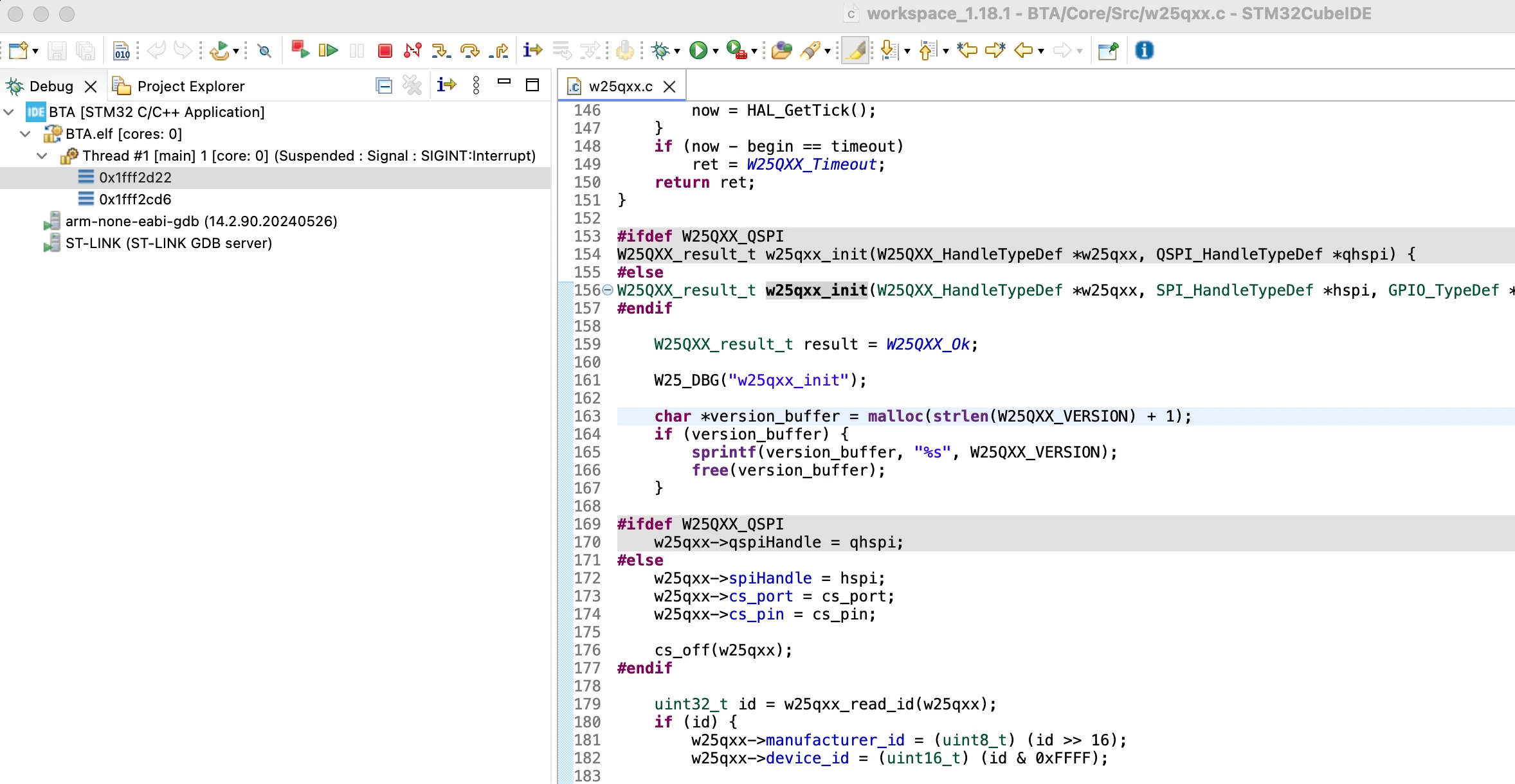

I have found where the problem is occuring, but dont know why.
Once I have flashed the device and step through the code, it fails (alterntately) on the function 'w25qxx_init' which initialises the external flash device (W25Q128)...
w25qxx_init(&w25qxx, &hspi2, GPIOB, GPIO_PIN_6);

When I step through the 'w25qxx_init' function, it fails on this line....
 char *version_buffer = malloc(strlen(W25QXX_VERSION) + 1);
This never used to happen in the early stages of development, I have added further code and peripherals since then so don't know why w25qxx_init would suddenly cause this issue ?

It fails on line 168 of the 'w25qxx_init' function and then the debugger crashes.  When I pause the debugger it appears to go outside the flash area with the error "Break at address "0x1fff2d24" with no debug information available, or outside of program code."

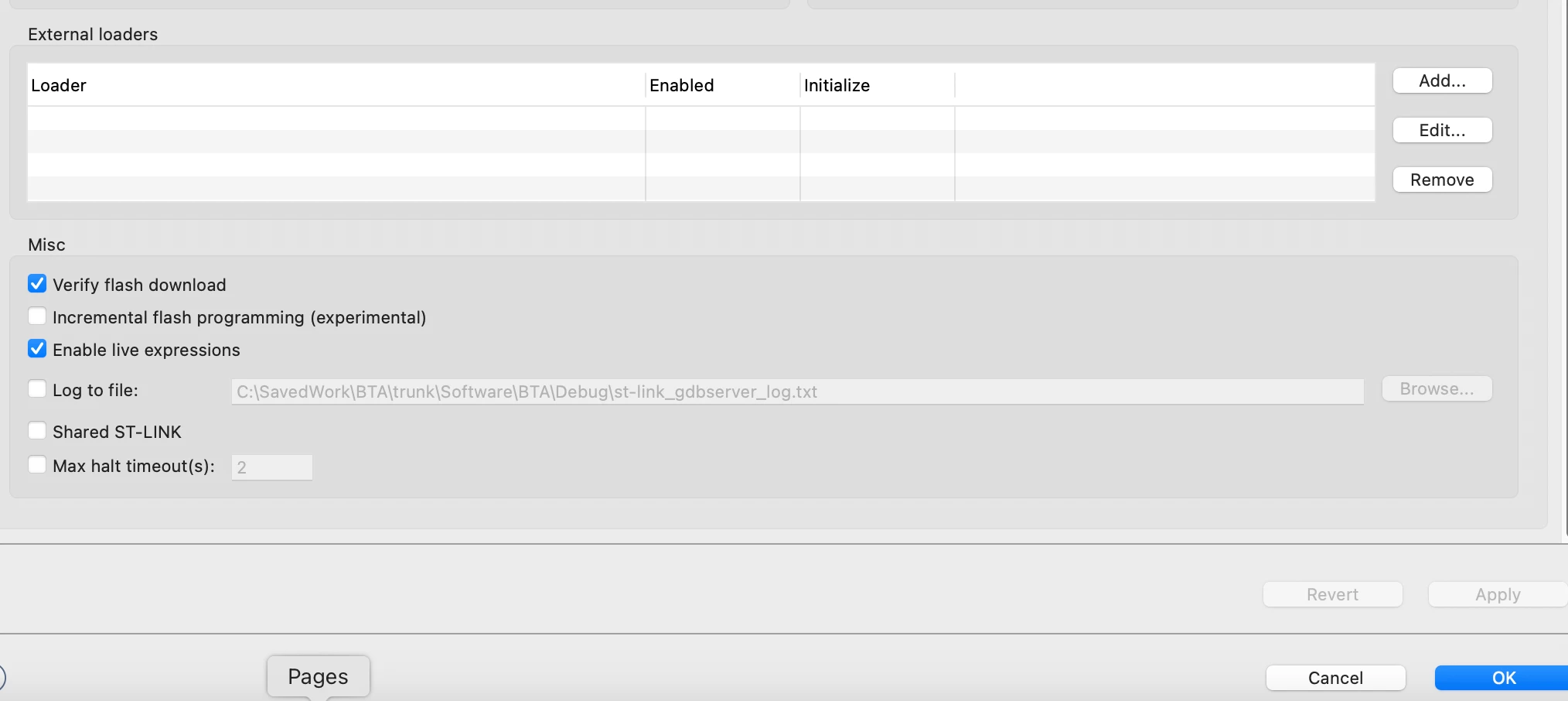

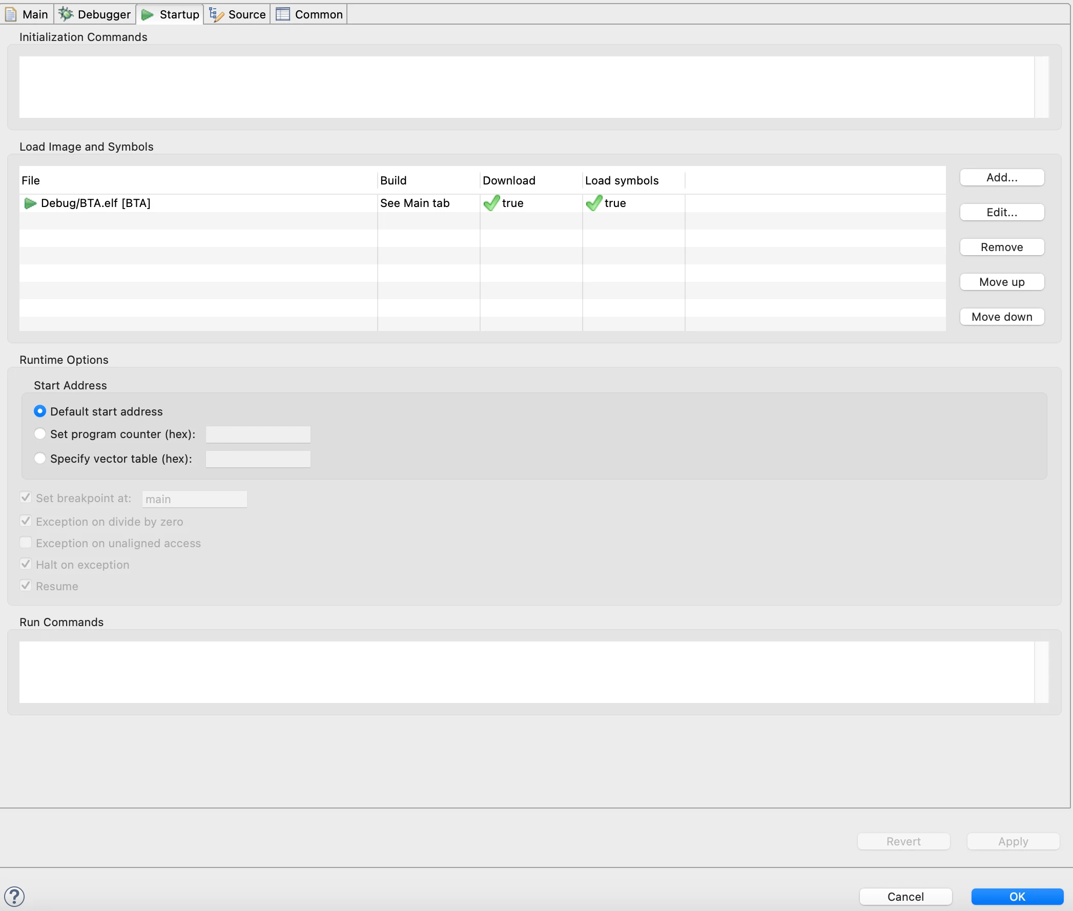

Thanks all, how do I enable Full Chip Erase and ensure my debug configuration includes program loading before starting execution ?
I cant see any options for those in the debugger settings ?

Thanks michaeljyti, the point at which the program fails when stepping though the code was a red herring.
As my code developed. the program failed at a different points in the program.
The stack size is the default setting, I have not changed this...
_Min_Heap_Size = 0x200; /* required amount of heap */
_Min_Stack_Size = 0x400; /* required amount of stack */
I have never used stack painting so will need to look further into this.
If the stack size was incorrect, then wouldn't it fail every time ?
The flashing fails the first time but works the next time, it alternatively fails and works.
So why would an incorrect stack size cause this ?

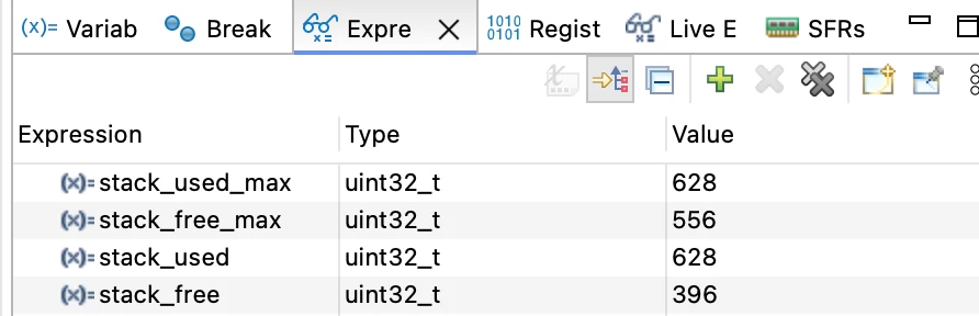

I checked the stack and its well within the limits....
Below is the code snipet to check the stack...
static uint32_t stack_used;
static uint32_t stack_free;
static uint32_t stack_used_max;
static uint32_t stack_free_max;
int main(void)
 HAL_Init();
 SystemClock_Config();
 Stack_Paint();
void Stack_Paint(void) {
 uint32_t *p = &_stack_end;
 while (p < &_estack) {
 *p++ = 0xA5A5A5A5; // fill with pattern
uint32_t Stack_GetUsage(void) {
 extern uint32_t _stack_end;
 extern uint32_t _estack;
 while (p < &_estack && *p == 0xA5A5A5A5) {
 p++;
 stack_used = (&_estack - p) * sizeof(uint32_t); // bytes used
 if (stack_used > stack_used_max)
 	stack_used_max = stack_used;
uint32_t Stack_GetFree(void) {
 p++;
 stack_free = (p - &_stack_end) * sizeof(uint32_t); // free space in bytes
 if (stack_free > stack_free_max)
 	stack_free_max = stack_used;
Stack_GetUsage and Stack_GetFree is called in a 100ms task and the program is left to run for several minutes.
