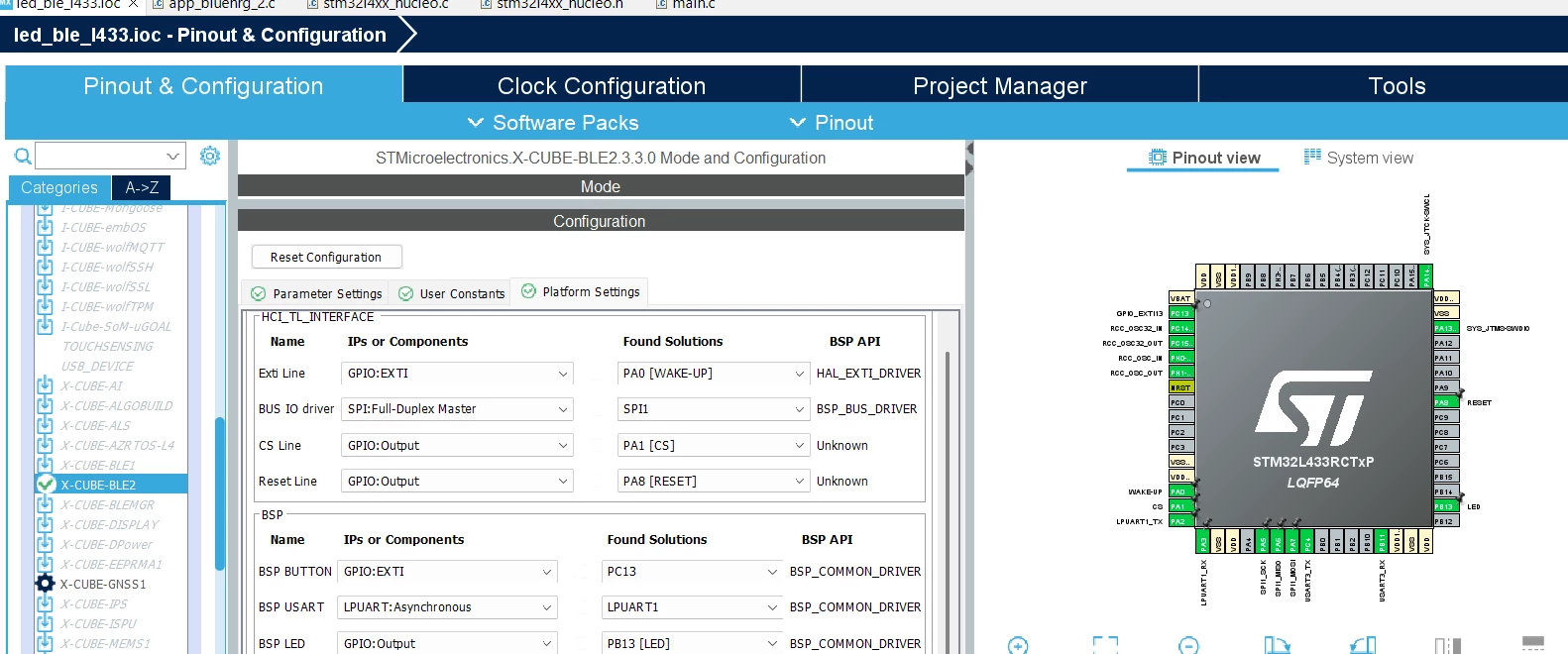

Nucleo-L433RC-P board with a BlueNRG-2 BLE
Hi
I am testing the Nucleo-L433RC-P board with a BlueNRG-2 BLE interface. I configured the setup, but the BLE device is not being detected in the ST BLE app. Look at pic, Any modifications require are not ?
12 replies
Andrew Neil
Jun 10, 2025 10:34 AM UTC
You'd need to show your code, too.
Does the app detect other things?
For a device to be detected, it must be Advertising.
Are you sure you have started advertising?

Hi Andrew
Ble are not showing in ST BLE Sensor app.

Hi Andrew
BNRG2A1 BLE supports with Nucleo-L433 board are not.
Andrew Neil
Jun 14, 2025 8:37 AM UTC
Pardon?
We've been through all this before.
The BNRG2A1 just uses standard interfaces - SPI, UART, GPIO, etc.
It neither knows nor cares what microcontroller is used.
https://community.st.com/t5/stm32-mcus-boards-and-hardware/stm32f407vet6-interface-with-x-nucleo-bnrg2a1/m-p/809202/highlight/true#M26056
You said you have it working on a Nucleo-F401RE board - so use that as your reference.
https://community.st.com/t5/stm32-mcus-boards-and-hardware/stm32f407vet6-interface-with-x-nucleo-bnrg2a1/m-p/809552/highlight/true#M26072
