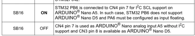

I am stuck with the FatFS error FR_NOT_READY (Error 3) during f_mount. After extensive troubleshooting, I suspect a hardware failure on the MISO pin (PA6), but I would like a sanity check on my diagnosis before I remap the pins.

The Issue & Diagnostics: The communication fails at the very beginning. When sending CMD0 to wake up the card, the SPI RX buffer always returns 0x00 instead of 0xFF (Idle) or 0x01 (Success).

  2. I physically disconnected the wire from PA6 (Pin A5 on the Nucleo).
  3. I ran a debug loop printing the received SPI byte (sending 0xFF dummy bytes).
Result: Despite the Internal Pull-Up being enabled and the pin being physically disconnected (floating), the MCU still reads 0x00. Logically, with a Pull-Up and no load, I should be reading 0xFF (All 1s).
My Question: Is there any specific configuration on the NUCLEO-L432KC (clock gating, conflict with other peripherals, or analog interference) that could force PA6 to read 0 internally despite a Pull-Up? Or is it safe to conclude that the PA6 pin on my MCU is physically dead/shorted to Ground?

See the restrictions on A5/PA6 in the user manual. If you have default solder bridges, PA6 must be left as input.
