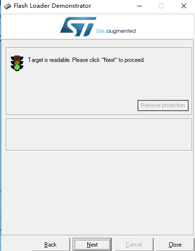

Hi, I met a problem using bootloader on pc to wirte program into STM32L432KC via UART.
Here is the process I did :
1,I connect D1/Tx and D0/RX(PA9 and PA10 of STM32L432KC) to CH340 USB to UART board, 5V Vin and GND. USB to PC.
2, I connect 5V to pin 31 of STM32L432KC:PH3\BOOT0 , reset the ic, then pull
PH3\BOOT0 = 0V.
The LED do not blinky, which means the stm32L432KC is in boot mode.
3, I opened Flash Loader Demonstrator boot loader, chose the COM port , click next:
THen next:

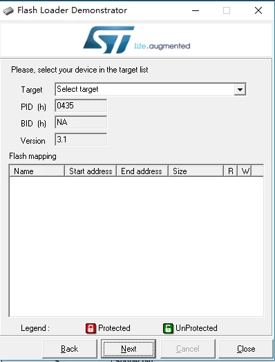

The software can not read Flash Mapping, nor the target name.Can not do anything with this.

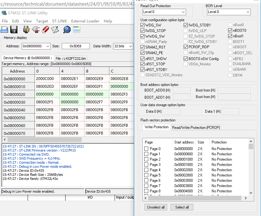

Checked in ST link Utility, no Read out protection.
So I do not know what is the problem ? Software or hardware ? Nucleo board or CH430 ?

    Posted on April 25, 2017 at 17:23
    Hi
    You find attached a newer version of the FlashLoader supporting STM32L4x3xx devices (256K and 128K)
    Please try it and keep me informed if it is working as expected or you faced any issue using it.
    Thanks
    Imen

    Hi Imen D,
    Thank you so much! It works! So I think you may update the software published in your site.:)
