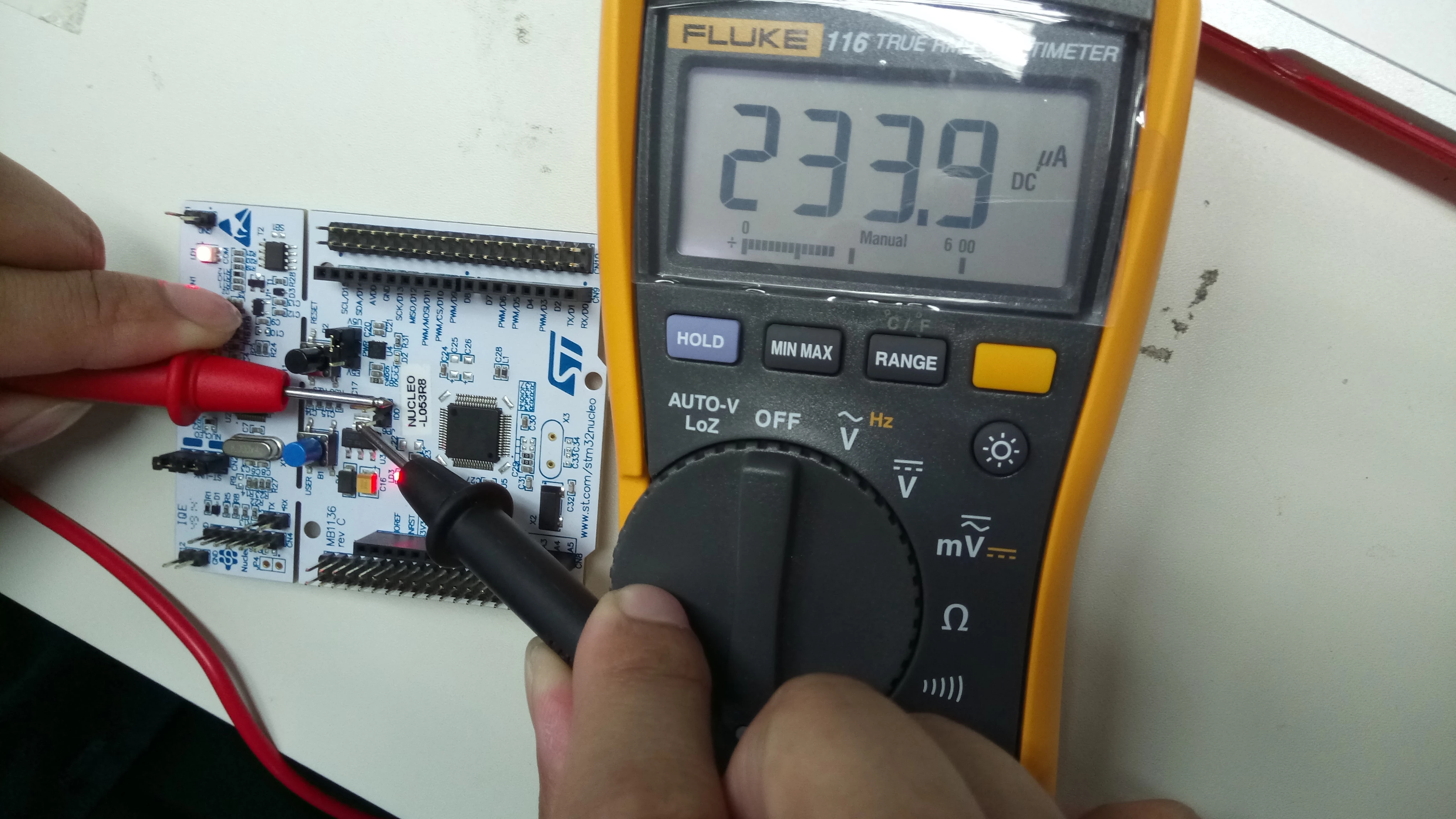

Nathapol Tanomsup
Jan 30, 2017 7:01 AM UTC
Posted on January 30, 2017 at 07:01
Hi, Khouloud
Today, I used an example from
/external-link.jspa?url=http%3A%2F%2Fwww.st.com%2Fcontent%2Fst_com%2Fen%2Fproducts%2Fembedded-software%2Fmcus-embedded-software%2Fstm32-embedded-software%2Fstm32cube-embedded-software%2Fstm32cubel0.html
package but I got this. I don't think it works fine.

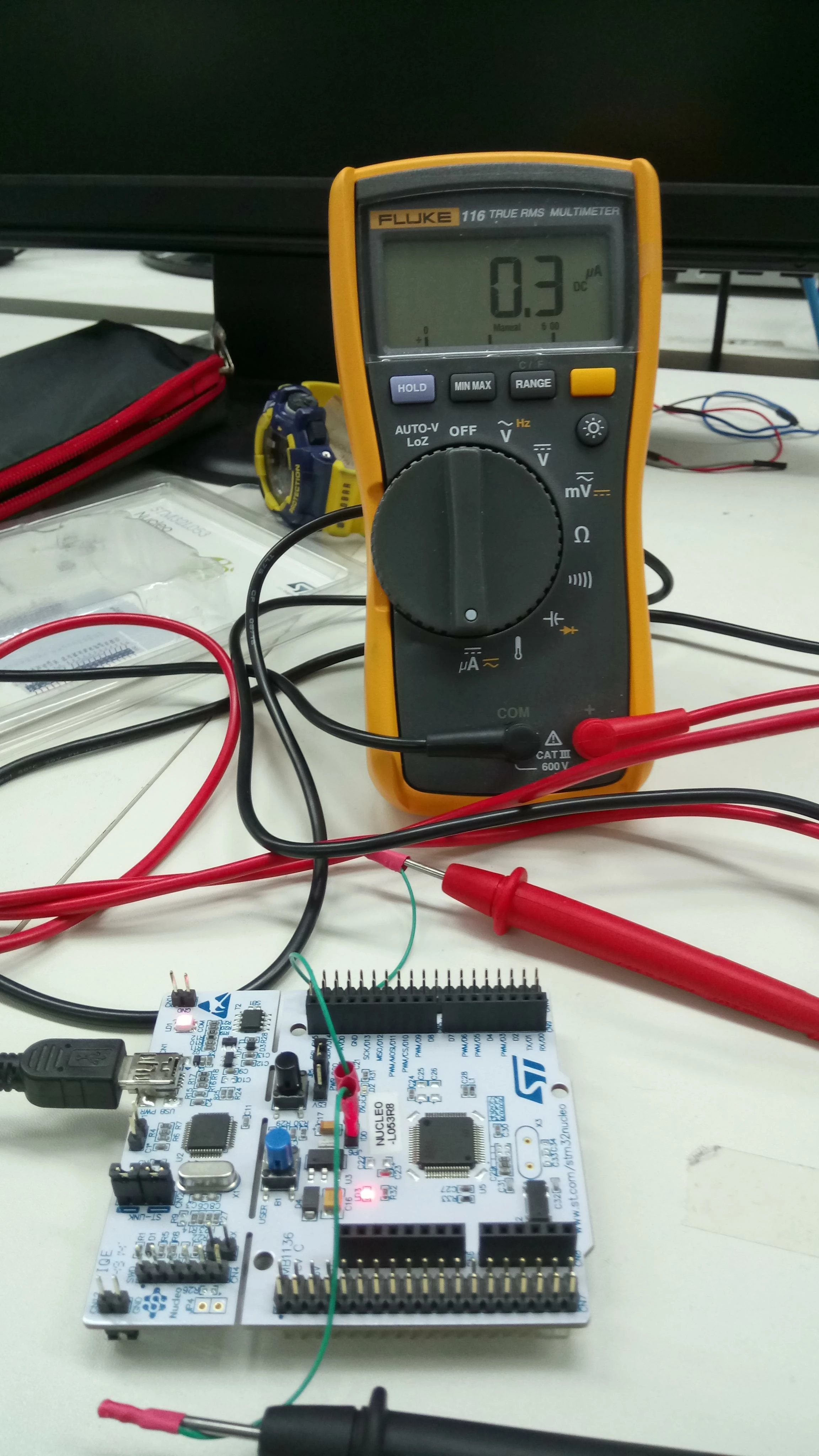

Nathapol Tanomsup
Jan 30, 2017 8:52 AM UTC
Posted on January 30, 2017 at 08:52
Finally, I got it. Thanks for helping.
