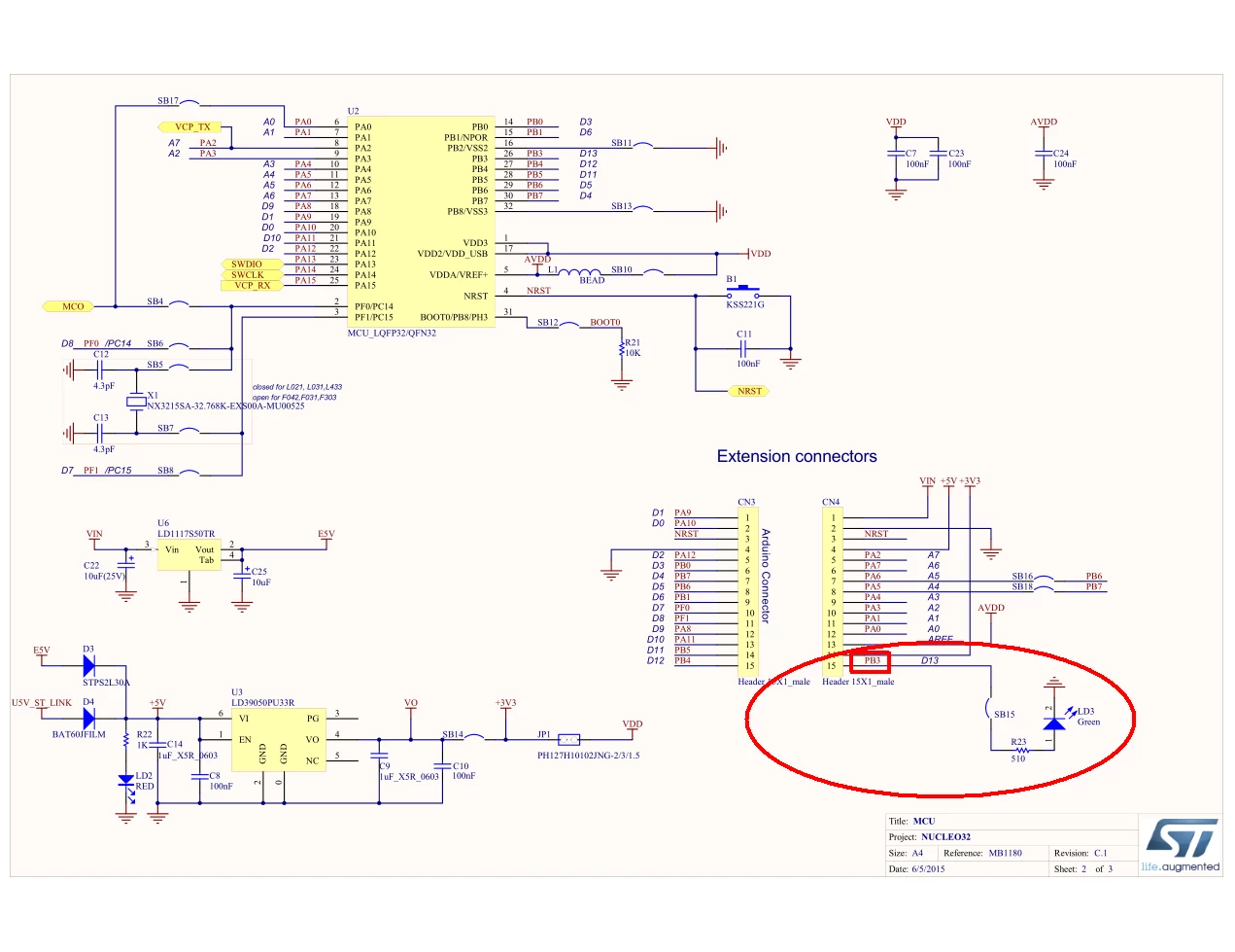

I'm starting to learn about low-level embedded development. My goal is to learn how I can write my own linker scripts and startup code. I also want to learn how to use raw register calls to do something useful. I want to use the NUCLEO-L011K4 board and tried reading through the reference manual to find register addresses and the expected values.
For some reason, my minimal blinky (LED connected to PB13) app doesn't work. It flashes just fine, but the board does nothing after that.
I am pretty sure (keep in mind: Still a newbie), that the registers are the right ones. However, I'm not so sure about the linker script.

void main(void)
 volatile int *RCC_IOPENR = (int *)0X4002102C;
 volatile int *GPIOB_MODER = (int *)0X50000400;
 volatile int *GPIOB_ODR = (int *)0X50000410;
 *RCC_IOPENR |= 0b10; // Enable GPIO Port B
 *GPIOB_MODER |= 0b10 << 26; // Set Pin 13 as output
 while (1)
 *GPIOB_ODR ^= 0x0020; // Toggle output Pin
 for (int i = 0; i < 1000000; i++)
 __asm__("nop");

waclawek.jan
November 9, 2024
LED on the Nucleo32 is at PB3, not at PB13 (PB13 is not available at the 32-pin package at all).

tim-hiltAuthor
November 9, 2024
Oh no! I feel really dumb. I looked at the nucleo32 board description and mixed up the Arduino nano pin description (D13) with the stm32 pin (pb3). I’m not at my desk right now, so can’t try immediately.
