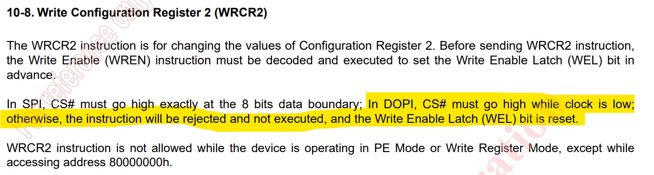

As macronix memory also supports OPI mode commands, I am trying to read device ID using OPI mode command now. For that I am first writing configuration register 2 -> DTR OPI enable bit to 1 to enter into OPI mode. After that tried to read device ID using OPI mode commands, I am not receiving ID with that. Is there any different configuration required for that.
One observation is after enabling DTR OPI mode, if I configure IMODE, ADMODE, DMODE to 1 i.e  data on single line and read device ID then getting 0xFF as a result of read. If MODE, ADMODE, DMODE is set to 3 i.e  data on four lines, then getting 0x0 as a result of device ID read operation.
When I referred memory datasheet for WRCR2 command details, it says #CS should go high when clock is low while in SPI mode #CS should go lo at 8 bits boundary. Can you please guide on how can we have a control on #CS going high when clock is low?
Is there anything that I might be missing on for DTR OPI mode? Please suggest. Let me know if you require any more configuration details.
