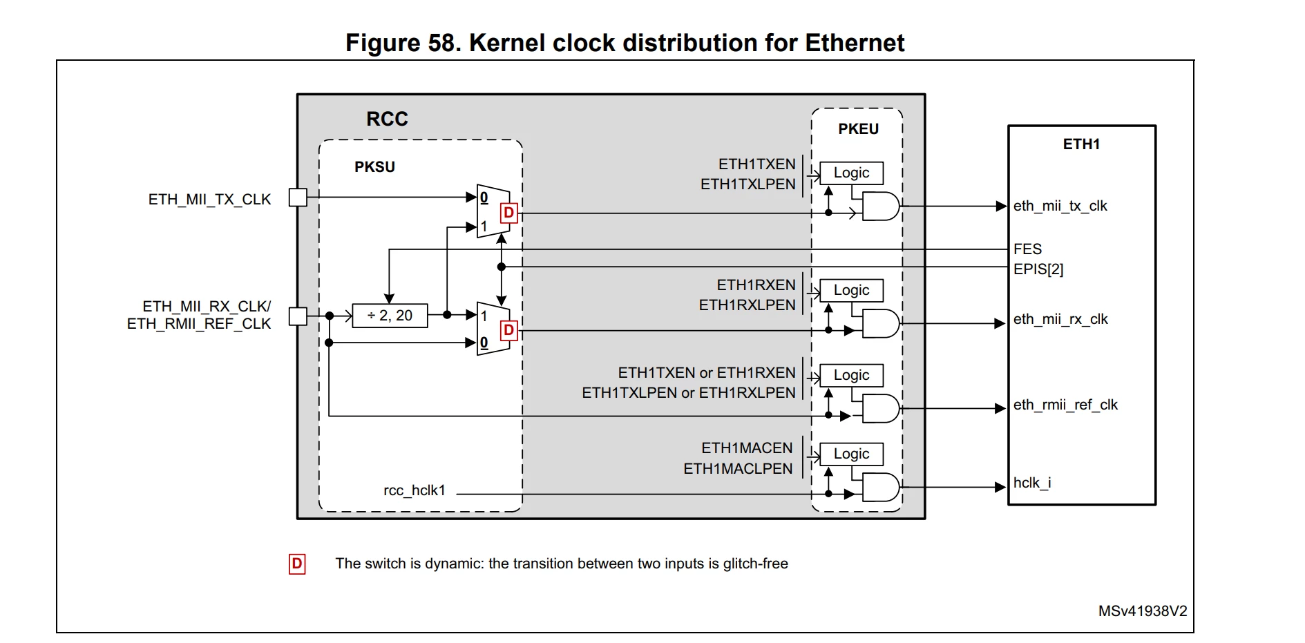

After verifying this indeed the same code is hanging on step5, but this is explained by the change of architecture for the Ethernet clock source especially. here is why:
in H747 the clock source for PTP is the HCLK so no problems there it should work without any hustle

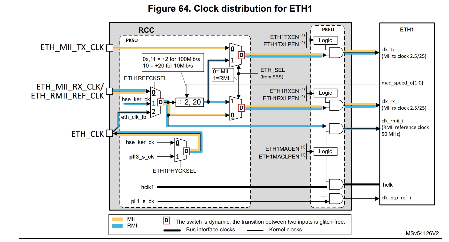

in H7s the kernel clock distribution changed and the source for ptp_ref_clk is pll1_s_ck

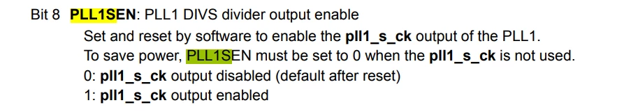

so, for this to work properly you need to enable the pll1_s_ck by setting bit 8 of RCC PLL1DIVR2 register

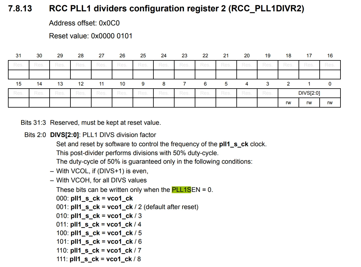

by default, the value should be vco1_ck/2 and it's up to you to set you clock to the desired value

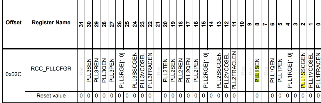

these snippets where extracted form RM0477 for H7sxx and RM0433 for H74xx MCUs.
