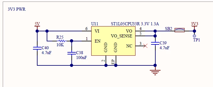

In that case either:
1- This regulator is internally short-circuited :
2 - Or you have a short circuit on the board.
To differentiate between the two cases you need to unsolder SB2 and fit again JP2.
If LD6 is lit: the regulator is broken. You need to purchase another board.
If LD6 is off you have a short circuit on the board. In that case you need to check your board and find if VDD is short-circuited.

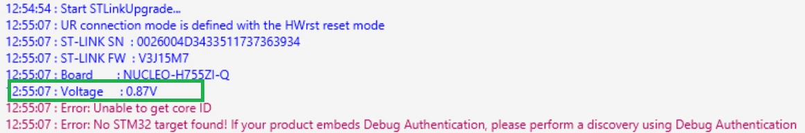

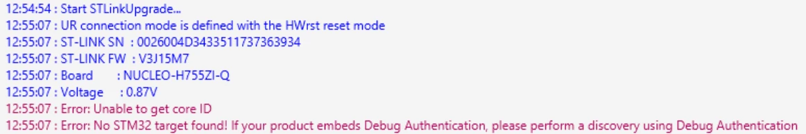

This is the message comming when I am connecting with STM32CubeProgrammer
mƎALLEm
Mar 5, 2025 7:47 AM UTC
The voltage is very low: 0.87:
Check the VDD voltage level with a multimeter on JP4.

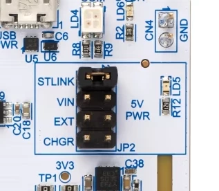

What is the position of the jumper here?:
And how are you powering the board? via ST-Link?
Shubhamkeshari
Mar 5, 2025 8:21 AM UTC
The position of the jumper is same as the image.
The board is been powered by a USB cable
I have changed the USB cable and tried, still the same

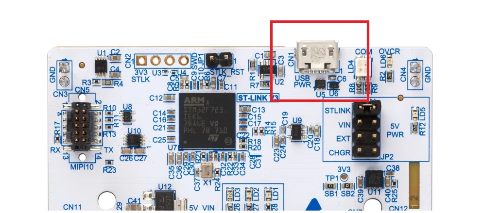

USB cable connected to CN1 (ST link USB connector)?:
