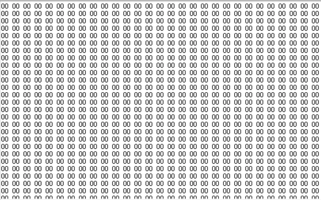

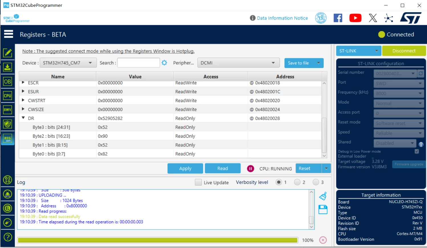

I tried to use this board to capture image by using DCMI DMA with a ov2640 camera. The problem is data read is successful in DCMI(by watching the register) but the buffer(initialized:uint32_t buffer[16000]={0}) used to store the image data was the same as it was initialized. I think this is a DMA problem.Register after running"HAL_DCMI_Start_DMA"Register after running"HAL_DCMI_Start_DMA"buffer(HEX) sent via USART after "HAL_DCMI_Stop"buffer(HEX) sent via USART after "HAL_DCMI_Stop"

	PY_OV2640_RGB565_CONFIG();
 /* USER CODE END 2 */
	uint8_t id = SCCB_RD_Reg(0x00);
	printf("id :%did",id);
	HAL_Delay(10000);
 /* Infinite loop */
 /* USER CODE BEGIN WHILE */
 while (1)
 /* USER CODE END WHILE */
		printf("1\n");
		getStatus();
		dcmi_dma_status = HAL_DCMI_Init(&hdcmi);
		printf("2\n");
		getStatus();
		for (uint8_t i=0; i<10;i++)
//	 		 HAL_DCMI_DisableCrop (&hdcmi);
	 	 	 DCMI_RN = 48;
	 	 	 DCMI_CN = 1280;
	 	 	 DCMI_RS = 48*i;
	 	 	 DCMI_CS = 0;
//	 	 	 HAL_DCMI_ConfigCrop (&hdcmi, DCMI_CS, DCMI_RS, DCMI_CN, DCMI_RN);
//	 	 	 HAL_Delay(1);
//	 	 	 HAL_DCMI_EnableCrop (&hdcmi);
//	 	 	 HAL_Delay(1);
						printf("3\n");
						getStatus();
						HAL_DCMI_Stop(&hdcmi);
						printf("4\n");
						getStatus();
						MX_DCMI_Init();
						printf("5\n");
						getStatus();
						__HAL_DCMI_ENABLE_IT(&hdcmi, DCMI_IT_FRAME);
	 	 	 dcmi_dma_status = HAL_DCMI_Start_DMA(&hdcmi, DCMI_MODE_CONTINUOUS, (uint32_t)&dcmi_data_buff, DCMI_CN*DCMI_RN/4);
						printf("6\n");
						getStatus();
	 	 	 while(HAL_DMA_GetState(&hdma_dcmi)==HAL_DMA_STATE_BUSY) ;
					 //HAL_DCMI_Resume(&hdcmi);
 	 	 tx_busy = 1;
		 	 Send((uint8_t *)dcmi_data_buff, 61440);
					HAL_Delay(1000000);

 hdcmi.Instance = DCMI;
 hdcmi.Init.SynchroMode = DCMI_SYNCHRO_HARDWARE;
 hdcmi.Init.PCKPolarity = DCMI_PCKPOLARITY_RISING;
 hdcmi.Init.VSPolarity = DCMI_VSPOLARITY_LOW;
 hdcmi.Init.HSPolarity = DCMI_HSPOLARITY_LOW;
 hdcmi.Init.CaptureRate = DCMI_CR_ALL_FRAME;
 hdcmi.Init.ExtendedDataMode = DCMI_EXTEND_DATA_8B;
 hdcmi.Init.JPEGMode = DCMI_JPEG_ENABLE;
 hdcmi.Init.ByteSelectMode = DCMI_BSM_ALL;
 hdcmi.Init.ByteSelectStart = DCMI_OEBS_ODD;
 hdcmi.Init.LineSelectMode = DCMI_LSM_ALL;
 hdcmi.Init.LineSelectStart = DCMI_OELS_ODD;
 if (HAL_DCMI_Init(&hdcmi) != HAL_OK)
 Error_Handler();

3 replies
August 4, 2024
Ensure that dcmi_data_buff is not in DTCM and is somewhere the DMA can access.
While debugging the program, after the transfer should have taken plane, look at the DMA registers to see if an error occurred.
Data cache coherency might also be an issue in the future, although it's not the main culprit here. I suggest disabling it during the debugging stage.
EsonShenAuthor
August 4, 2024
Thank you for your solution, this problem has been solved but not still correctly get the image. But over all thank you!
