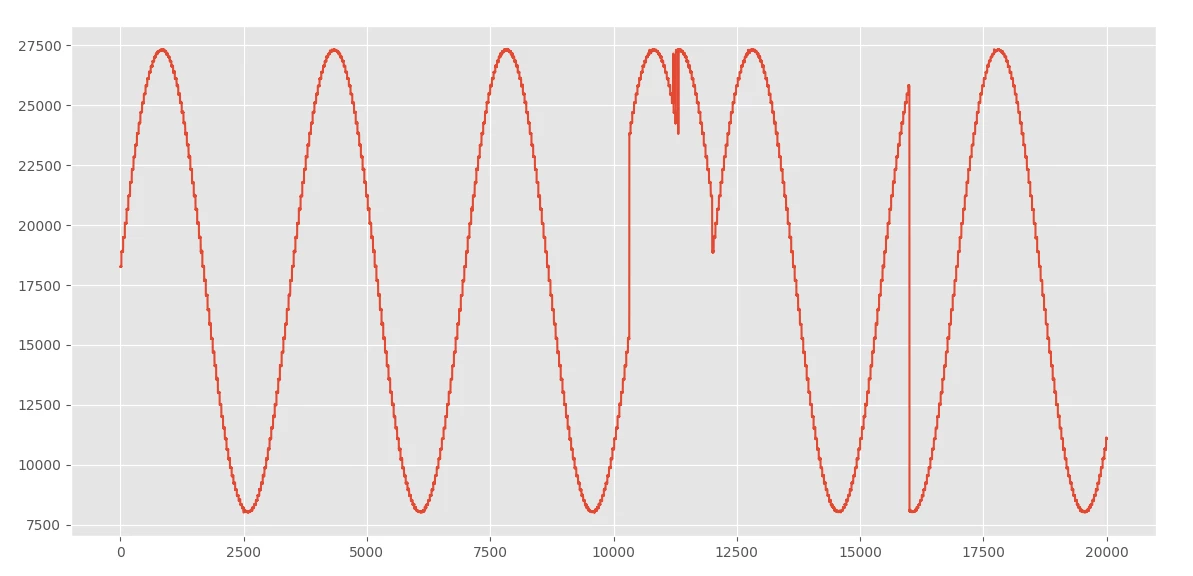

I'm currently using the ADC on the NUCLEO-H743ZI2 board to sample a low frequency sine wave signal.
The ADC is configured to DMA, circular buffer, continuous sampling mode and oversampling ratio of 4 with 2 bits shift.
When I set the ADC sampling rate to 250KHz and the sine wave signal is 100Hz.
Here is the sampled signal I got:

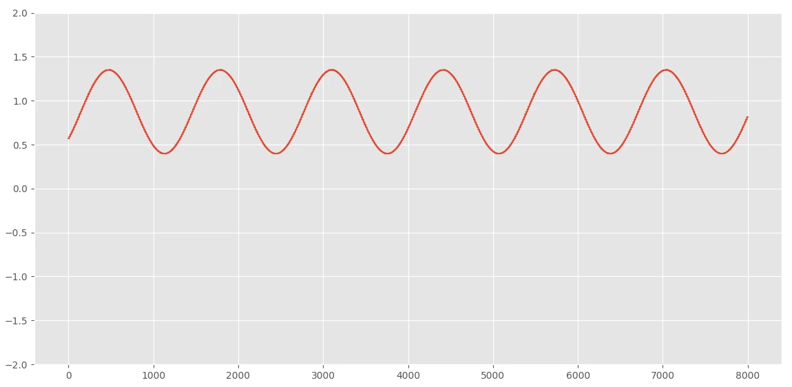

When I reduced the ADC sampling rate to 125KHz, the sampled data is correct:
Does anyone know what's causing this?
Do I have to reduce the sampling rate?

CDC_Transmit_FS((uint8_t*)&adc_buf[BUF_LEN_HALF], BUF_LEN_HALF*2);
You are probably hitting the USB FS transfer capability limit.

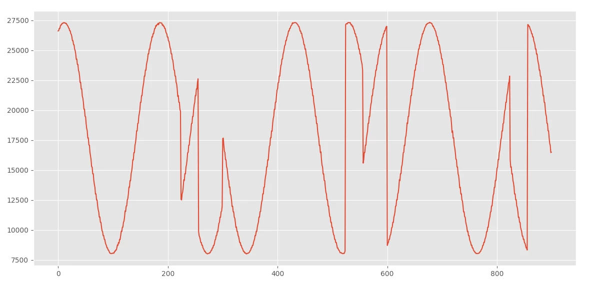

But I have verified the data in the DMA buffer is glitched instead of the read method.
Here is the graph by reading the u16_t value directly from the DMA buffer.
The input sine wave is 2KHz and the sampling rate is 350KHz
I'm not sure it's the issue of high sampling rate, it's only taking 175 samples per period of input signal.
I also checked the input signal is a normal 2KHz sine wave using oscilloscope.

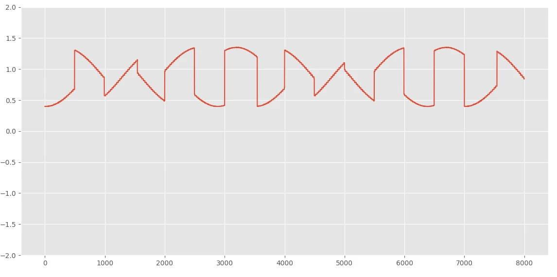

I also did use the HAL_GPIO_WritePin() in half callback and complete callback to check the sampling frequency is correct.
I just found that when I reduce the functions inside the half and complete callback.
The ADC is less likely to produce the glitch. Below is the code and graph.

With less functions:
void HAL_ADC_ConvCpltCallback(ADC_HandleTypeDef* hadc)
	adc_buf_counter++;
	HAL_GPIO_WritePin(GPIOC, GPIO_PIN_7, GPIO_PIN_RESET);
Glitches are less likely to occur, but they are still there.
LCE
Principal III
June 26, 2023
It looks like you are doing a little bit too much in the callbacks, so that the buffers are filled while you are still working with them.
Try to increase DMA buffer size, reduce calculations, maybe even try to use DMA's double buffer mode.

With 32 bit x 300k you're at 9.6 Mbit/s, that is quite close to the limit and means that your buffering and transfer scheme has to be on point. I don't know how close to the 12 Mbit/s you can really get.
Anyway, starting with transmitting data only, see it that gets through, keep the callbacks simpler.
Even a x * 100 MHz MCU needs some time for the calculations and data transfers that you put into the callbacks.
You might want to measure processing time of these functions with the cycle counter.
JJ.5
JJ.5Author
June 27, 2023
I believe you are correct.
The actual transfer speed is around 7Mbit/s to 8Mbit/s.
Thanks a lot!
I assumed the actual rate is the same on the datasheet, but it's not.:sad_but_relieved_face:
