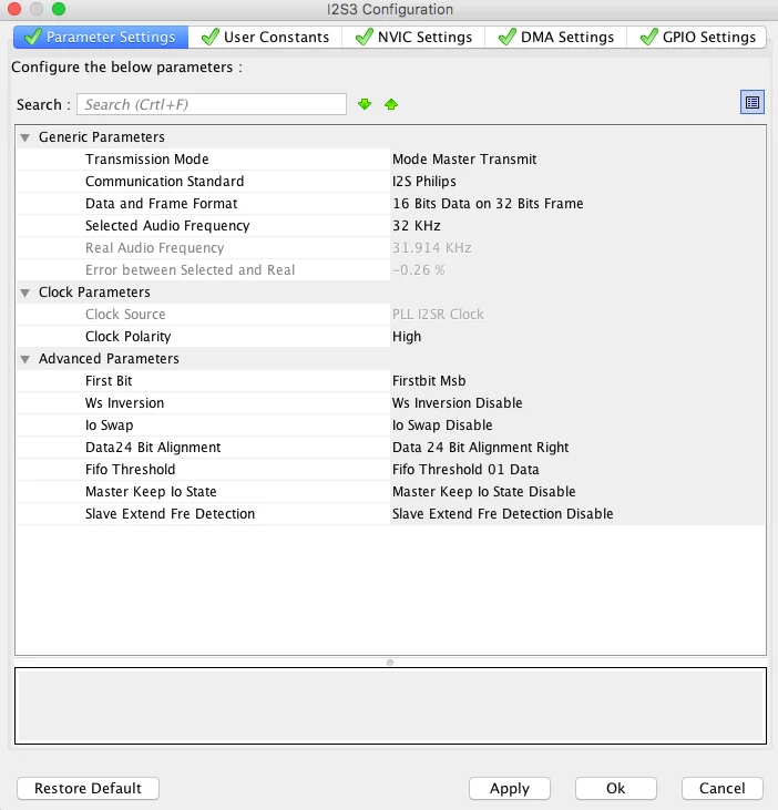

HI, I'm trying to interface this board to a cirrus logic CS42448 codec. I set up the I2S3 peripheral in slave mode configured in CubeMX as so:
The project is built with this and in the main while loop I have a simple bit of code to get it to transmit some random data:

The codec is providing the LR/WS clock and bit clock and I have it running at a sample rate of 32kHz (my logic analyser has limited bandwith). I can verify however that the clocks are coming in at the right frequencies with my logic analyser, however there isn't any data coming out of the board.
When I re-configure the board in I2S master mode however and disconnect the codec, with the exact same settings and code I can see there is data coming out.
Thanks!

    From RM0433, 50.9.2 Pin sharing with SPI function:
    > SDO: Serial Data Output (mapped on the MOSI pin) to transmit the audio samples in
    > master, and to receive the audio sample in slave.
    You can try to set SPI_CFG2.IOSWP.
    I am not sure about what  Serial data line swapping table indicates, IMO it contradicts the narrative I quoted above.

    Hi, thanks for the response, I've tried that but it's not making a difference. I've got probes on the input and output pins so I would see if something comes out of either
