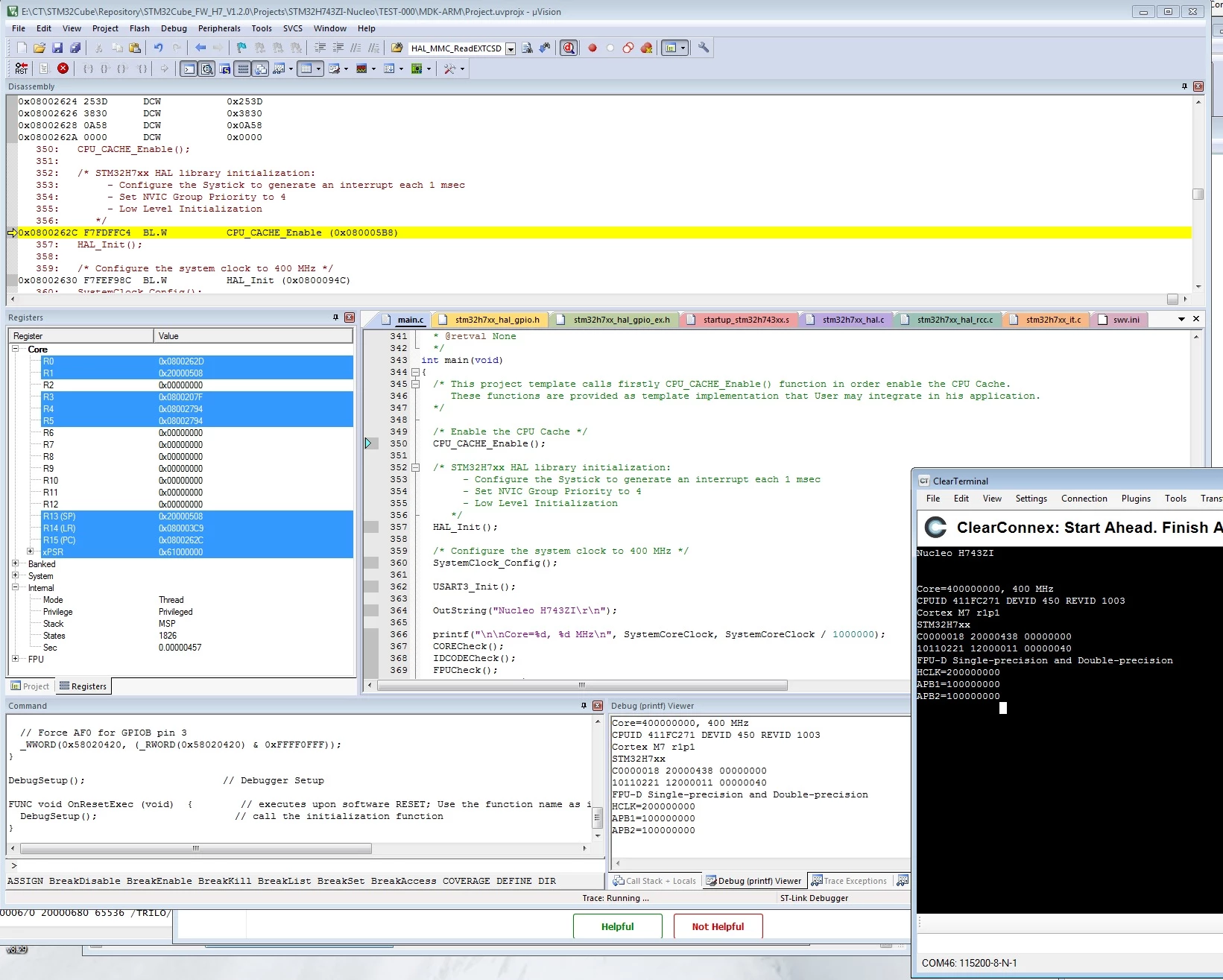

Here working in Keil via the debug script. The code from the previous post is more effective across different speeds (ie 100-500 MHz), and means you don't have to know the frequency for it to work in the ST-LINK Utilities SWV Viewer, etc.

OK, it now works well. There were two tricks:
  • Download ST-Link Utility v4 and upgrade ST-Link firmware to the latest V2.J29.M18
  • Set the Core clock to 400MHz
Without the second step, the print out appears as garbage characters (but also means something is working). Thanks for your help. Also have Keil installed now.
