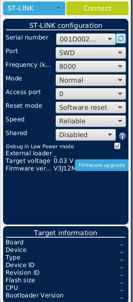

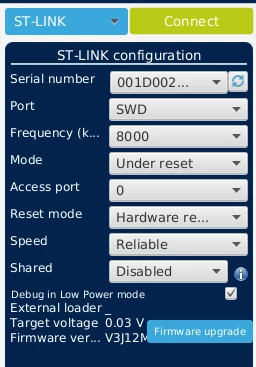

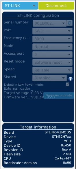

 use CubeProgrammer, show , whats its telling about your st-link V3 ;
--if problem , set :
then connect , under reset, and show, whats its telling .
...here from a H743 -> V3mods

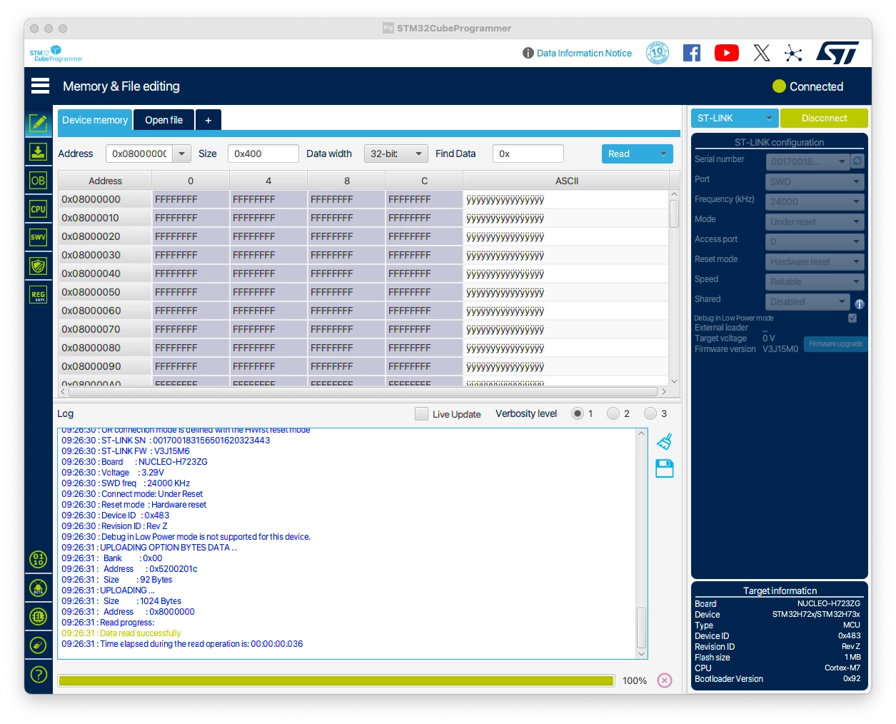

LysandrosAuthor
July 19, 2024
Thanks for both hints.
With one of the boards, I even managed to connect tin the CubeProgrammer.
And the board appears in the Terminal as /dev/tty.usbmodem213203
I have the impression, that other software (e.g. VScode) can't connect to the board if I don't close the STM32CubeProgrammer first, could this be? I managed to flash software, but only after first disconnecting from both Minicom and STM32CubeProgrammer...
