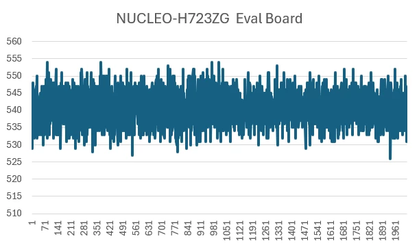

Hi, I am planning on using STM32H723ZGT6 chip on one of my boards. I got the NUCLEO-H723ZG to measure the 12-bit ADC noise. From the datasheet for STM32H723ZGT6, the max ADC noise should be 5 times the LSB or 4.02mV. (1 LSB = 3.3/4096)
I am getting 22.5641mV of noise. Which is more than 5 times the max ADC noise from the datasheet. Below is an image of the data. I didn't use any averaging. I used a 1.5V battery as my ADC input.
I am wondering if this is expected ? I want to have 2 or 3 bits of noise on my board. Based on this, it seems I would be getting 5 bits of noise? Thank you!

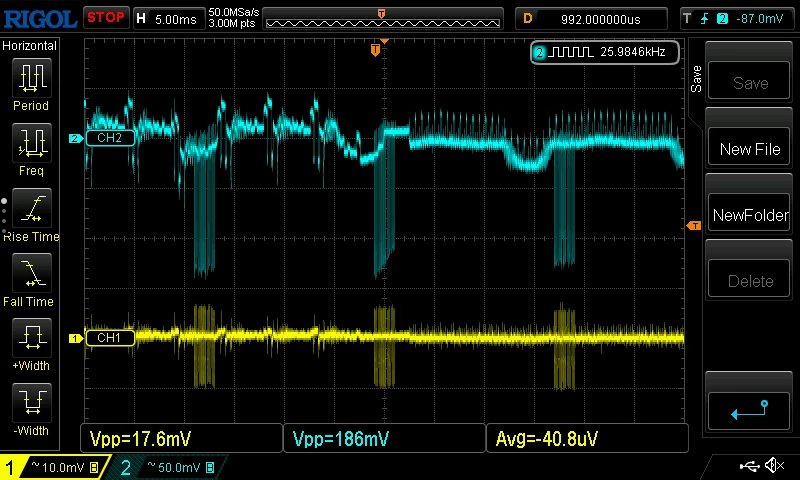

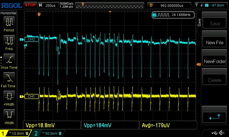

I get lower noise in the analog domain ( adc + dac ) on my nucleo-H743zi2 if I completely switched off  Ethernet.
I find out, that even I don't use E-net anywhere in the project, no do any config - assuming all hardware circuits should stay in sleep mode : it's not a case with nucleo-144 E-net equipped.  LAN8742A-CZ-TR is always running and generates huge power spikes.
To solve issue desolder L1. Also remove jumpers listed in table 13.
https://www.st.com/resource/en/user_manual/um2407-stm32h7-nucleo144-boards-mb1364-stmicroelectronics.pdf
Another things to keep under control  is clock. Has to be crystal - precise, not use any HSI. In case ST-Link provided, reconfigure to 25 /3 MHz, or it's generated by HSI in the ST-Link itself.
