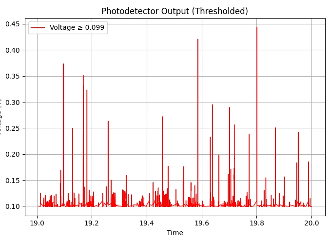

> I'm actually trying to read voltage peaks from photodetector, averaging might not be suitable for my case.
Do you need the exact peak voltage?
What's the voltage difference of the peaks compared to "idle / no-signal level" ?
Maybe a comparator would be more suited?
Or an amplifier before the ADC.
Anyway, isn't the H723 ADC 12-bit only?
sreyas40Author
Sep 22, 2025 11:17 AM UTC
yes i need exact peak voltage.
There is no fixed difference between peaks.
I don't think a comparator will be useful?
Currently i'm testing by sampling at different voltages( 0-3V)
No, not a comparator but peak detector with reset circuits. If pulses arrive not very often, than you don't need fast adc

> pulses arrive in intervals of near 400ns - assumption
That is no easy task... any colleagues available with high-speed analog / ADC experience?
sreyas40Author
Oct 3, 2025 3:24 AM UTC
Unfortunately no, I was thinking of using AD7960 external ADC,
