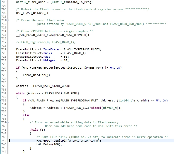

This is the structure of my flash management function, it is basically copy-pasted from the example provided by ST.
0693W00000JMFVsQAP.pngSo all the proper bits are set and managed by HAL libraries. This is perfectly identical (even the data to copy) to the ST example but is not writing anything while running the example itself works fine. I can't understand what is going on since they are identical...
