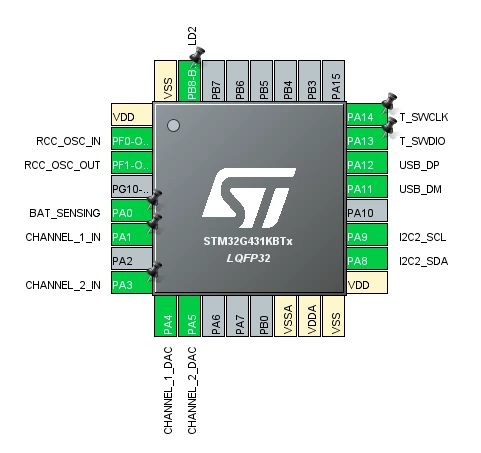

If I apply the a voltage (2.15v) to PA1 and PA3, in adc_convertions array I get the ADC of 2620 for PA1 and 1531 for PA3. But, the both values shold be equal... The another ranks in adc_convertions array are correct.
  • I've tried to change a sample time for CHANNEL4 (= PA3), no success.
  • I removed SB1 and SB12 (because PA3 is connected to STLINK-V3E virtual c omport) , no success.
  • I've tried to map CHANNEL4 to different Rank, no success.
So, 'Ive no idea anymore...
Can you please help me?
So, are PA1 and PA3 physically connected together?
And did you connect SB14?

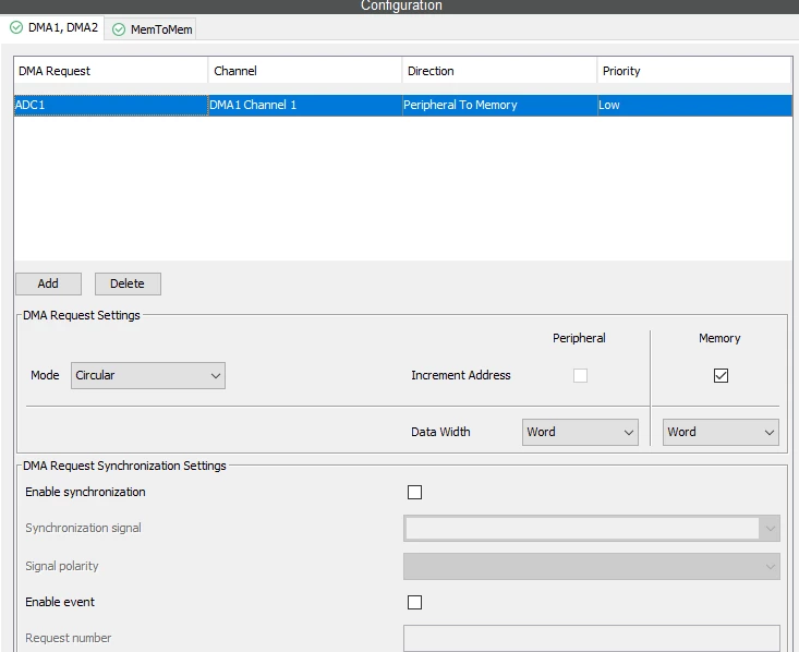

Hi guys, first of all, thank you very much for help :)
@MasterT:
DMA is configured like this at the moment:
Since STM32 is a 32-bit MCU, WORD means uint32_t, I think... It is correct?
@waclawek.jan
Yes, PA1 and PA3 are connected together. Not directly on Nucleo, but on carrier board. The is a voltage divider (5v to 3.3), then buffer and then NUCLEO. AI've applied 3.3v from NUCLEO to both input pins, after voltage diviers and buffers, I get 2.15v on BOTH pins of NUCLEO. So, the hardware should be okay, because the get the same voltage.
No, SB15 is still default, so not "installed".

If DMA configured as Word_Peripheral- Word_Memory, than
uint32_t adc_convertions[5] = {0};  or int32_t adc_convertions[5] = {0};
correct declaration.
For Halfword_Peripheral- Halfword_Memory, than
uint16_t adc_convertions[5] = {0};  or int16_t adc_convertions[5] = {0};

October 12, 2024
Okay, then it was correct.
I've changed them back to uint32_t adc_convertions[5] = {0};
and:
  • adc_convertions[0] says 2621, correct
  • adc_convertions[1] says 1543, wrong
I'll test with SB14 closed today evening.

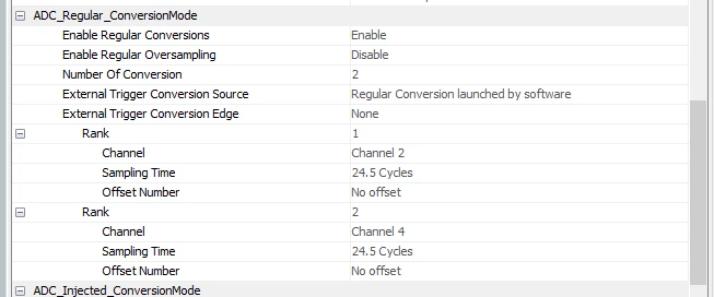

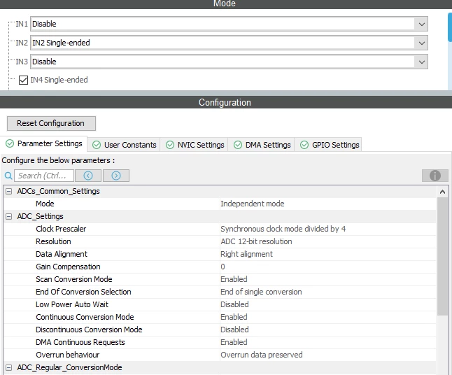

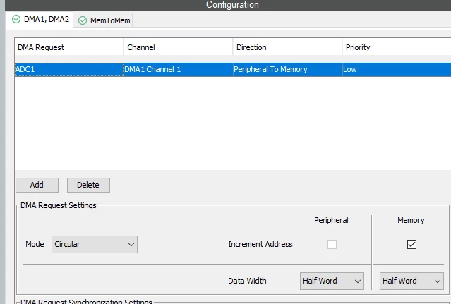

So, now I've closed SB14 and started a new project, adc + dma only.
DMA Config:
With buffer for DMA data:
uint16_t adc_values[2] = {0};
And DMA start:
 if (HAL_ADC_Start_DMA(&hadc1, (uint32_t *) adc_values, 2) != HAL_OK)
	 Error_Handler();
ADC config:
ADC config 2nd:
Here is the whole code from main.c:

 if (HAL_ADC_Init(&hadc1) != HAL_OK)
 Error_Handler();
 /** Configure the ADC multi-mode
 multimode.Mode = ADC_MODE_INDEPENDENT;
 if (HAL_ADCEx_MultiModeConfigChannel(&hadc1, &multimode) != HAL_OK)
 Error_Handler();
 /** Configure Regular Channel
 sConfig.Channel = ADC_CHANNEL_2;
 sConfig.Rank = ADC_REGULAR_RANK_1;
 sConfig.SamplingTime = ADC_SAMPLETIME_24CYCLES_5;
 sConfig.SingleDiff = ADC_SINGLE_ENDED;
 sConfig.OffsetNumber = ADC_OFFSET_NONE;
 sConfig.Offset = 0;
 if (HAL_ADC_ConfigChannel(&hadc1, &sConfig) != HAL_OK)
 Error_Handler();
 sConfig.Channel = ADC_CHANNEL_4;
 sConfig.Rank = ADC_REGULAR_RANK_2;
 Error_Handler();
 /* USER CODE BEGIN ADC1_Init 2 */
 if (HAL_ADCEx_Calibration_Start(&hadc1, ADC_SINGLE_ENDED) != HAL_OK)
	 Error_Handler();
 /* USER CODE END ADC1_Init 2 */
 * Enable DMA controller clock
static void MX_DMA_Init(void)
 /* DMA controller clock enable */
 __HAL_RCC_DMAMUX1_CLK_ENABLE();
 __HAL_RCC_DMA1_CLK_ENABLE();
 /* DMA interrupt init */
 /* DMA1_Channel1_IRQn interrupt configuration */
 HAL_NVIC_SetPriority(DMA1_Channel1_IRQn, 0, 0);
 HAL_NVIC_EnableIRQ(DMA1_Channel1_IRQn);

Result:
  • adc_convertions[0] says 2622, correct
  • adc_convertions[1] says 2621, correct
I think the point with SB14 was the solution...
Now it fine and all the values are correct.
Thank you very much!
