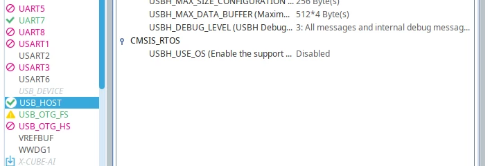

I've come here for a issue I failed to debug. My setup is as follows: I have a NUCLEO-F767Z development board and im debugging/programming it through the onboard STLINKV2 with SWO enabled. I am simply just trying to get a USB device to enumerate. I have configured the USB_FS host to the drive VBUS through pin PG6 where the USB power switcher is on the nucleo. My clock configuration is shown in the attached image. When plugging in a USB mouse (that works on my PC) through a USB A Female to USB Micro Male adapter, the SWV console prints forever:

1. what you enabled the host to do ?  HID? MSC ? ...
+ check from rm -> usb , the USB host module can do lo speed HID at all.
2. with SWO running, you could set the usb "debug messages" to 3 , maximum, to see all:
3. try other mouse, keyboards to see: its a problem from your/host side or the device has a problem.
4. try usb host -> MSC , check : it can enumerate an usb-memory-stick ; to see: your connections working fine - or not.

1. I tried enabling the host for both “HID” and “Host supporting all classes” both with the same issue
2. The output I attached was with debug level 3 (wish it gave some more info)
3. I tried with a different mouse, usb memory stick, and a printer all not working.
I don’t think it’s a class issue because classes are only initialized after device enumeration which is not happening even? Could it be something with hardware?
