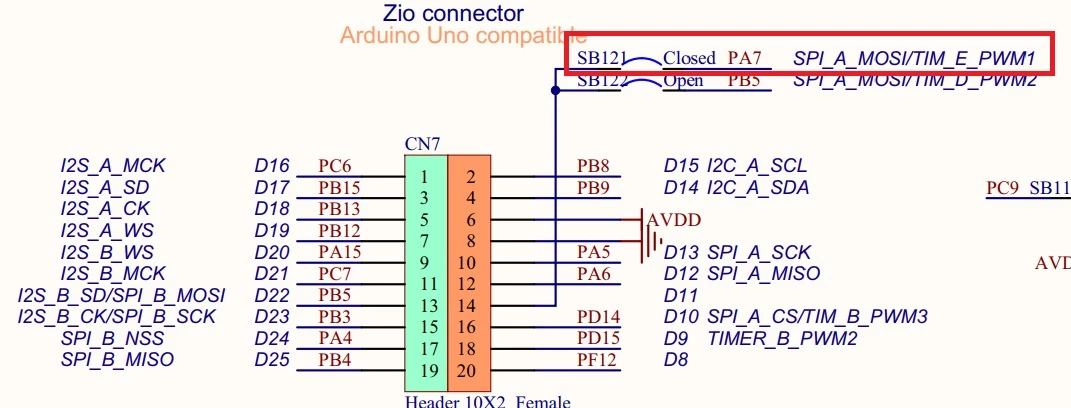

I try to use SPI1 in full-duplex slave mode with hardware NSS and interrupts.
Interrupts work fine, the only problem is that data is all 0
After connecting the logic analyzer I noticed that the CS and SCK signals are ok but the MOSI and MISO are low.
I generate the SPI data using MCP2210 breakout board, it works fine if I connect only the logic analyzer to the MCP2210 all signals are fine. when adding the nucleo in the circuit MISO and MOSI are pulled low!!!

PA7 is used by the ethernet. If you want to use it as SPI, you'll need to remove JP6.
Use the schematic to determine what pins are actually available. Consider defining them as GPIO output and toggling and monitoring with a logic analyzer or multimeter to ensure the pin is making it to the header you're connected to.

Thank you TDK,
In the link you send me, in the MB1137 PDF - "nucleo-144 for everything" the text on the schematic around the arduino connector is misleading x(
I changed the pins allocations and now it works fine!
where do I find the schematic for nucleo-f756ZG ???
December 19, 2023
What is misleading about it? I see you have posted a screenshot with a red rectangle, but I see no issue with what's in the rectangle.
