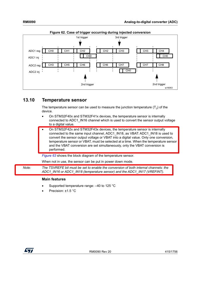

HI team,
I am working in NUCLEO-F439ZI board, now I am doing multi-channel ADC, in that I selected ADC 1 for getting the data, in ADC1 select CH3 and CH10 and Internal Temperature sensor. The data from CH3 and 10 work fine, but the internal temperature sensor value was so what different. Check my code where I do the mistake. I attached the code and result of the program for your reference.

 The output came was show below, I have doubts in the internal temperature sensor value (INT_Temp)
ldr: 963 pot: 1200 INT_Temp: -103.000000

Best answer by waclawek.jan
Have you enabled the temperature sensor as outlined in RM?
I can't judge from source, I don't use Cube. Looking at the ADC registers content reveals the truth.
1 reply
waclawek.jan
waclawek.janBest answer
May 28, 2024
