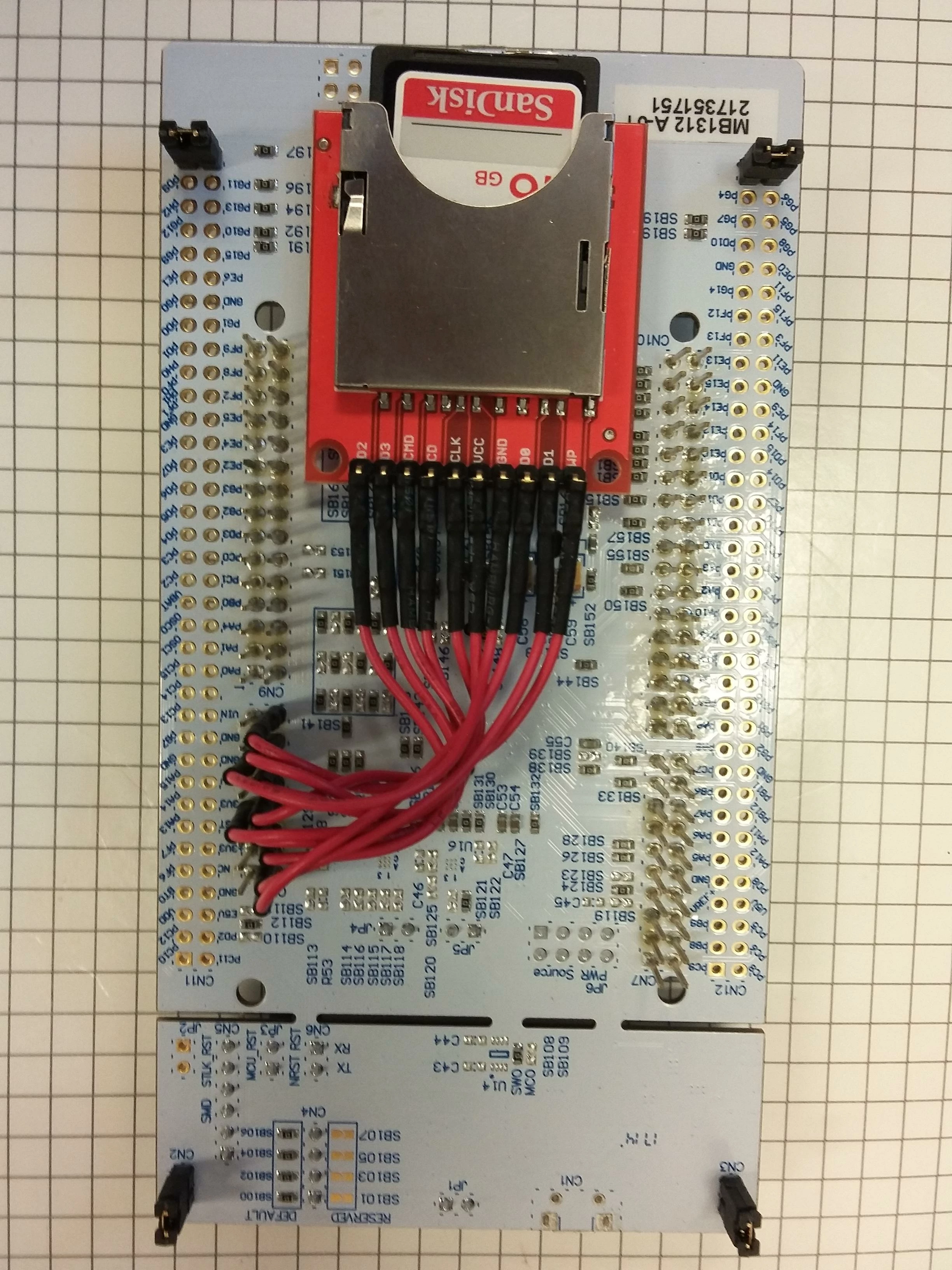

Dear All,
I’m new to this forum and to stm32 board. I’m trying to connect an SD Card to my board NUCLEO-F429ZI but I’m having some problems with it.
I use STM32CUBEMX to create the project using the standard peripherals settings.
I put SDIO in SD 4 bit interfacing mode. I do not change anything in clock configuration.
I connect the SD Card directly to SDIO PIN without any resistors as in picture
http://www.openstm32.org/dl422?display
Board PIN    SD Pin
PD2             2 (CMD)
PC8             7 (Dat0)
PC9             8 (Dat1)
PC10            9 (Dat2)
PC11            1 (Dat3)
PC12             5 (CLK)
3.3V             VCC
GND            GND

The function F_MOUNT return FR_OK but the program stops there. Sometimes the f_open function return Error 3: Device not ready. Any suggestion?

    I found the solution disabling the use of DMA Template (USE_DMA_CODE_SD) in FatFS configuration in CubeMX. There are some misconfiguration in DMA code (as Imen suggested document). Thank you all for help.
