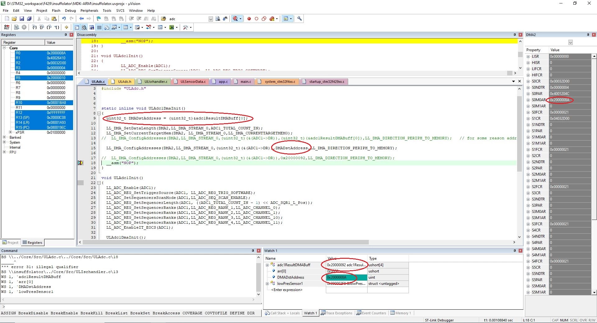

I am currently using NUCLEO-F429 for prototyping a medical product.
I am facing an issue while configuring ADC DMA as shown in attached image.
the address of DMABuff going in DMA register is different to the actual adress, hence i am not able to get proper data read out.
The values in DMAbuff are not updates as expected.
But if I hardcode the address the values are updated in DMAbuff

@Manas_Gupta Your buffer is declared as a static variable in .h file. Every .c file that includes the .h file gets its private copy of this buffer. Diagnosis: deficient C knowledge. Prescription: urgent intensive C course, 40 hours at least. Regular code reviews.

Weird.
Can you show the definition of adc1ResultDMABuff?
What if you try "(uint32_t) adc1ResultDMABuff" instead?

DMAbuff is defined in header file  as:
#ifndef __ULADC_H__
#define __ULADC_H__
#ifdef __cplusplus
extern "C" {
#endif
#include "ULConfig.h"
#include "adc.h"
/*		ADC1		*/
static volatile uint16_t adc1ResultDMABuff[ADC1_TOTAL_COUNT_IN];
void ULAdc1Init();
void ULAdc1StartConv();
/*		ADC3		*/
static volatile uint16_t adc3ResultDMABuff[ADC3_TOTAL_COUNT_IN];
void ULAdc3Init();
void ULAdc3StartConv();
#ifdef __cplusplus
#endif
#endif /* __ULADC_H__ */
Also I have already tried "(uint32_t) adc1ResultDMABuff"  with same result.

Got me.
The compiler is usually not a problem but it's hard to see how it could be something else here. Might be worth pinging Keil for support.
