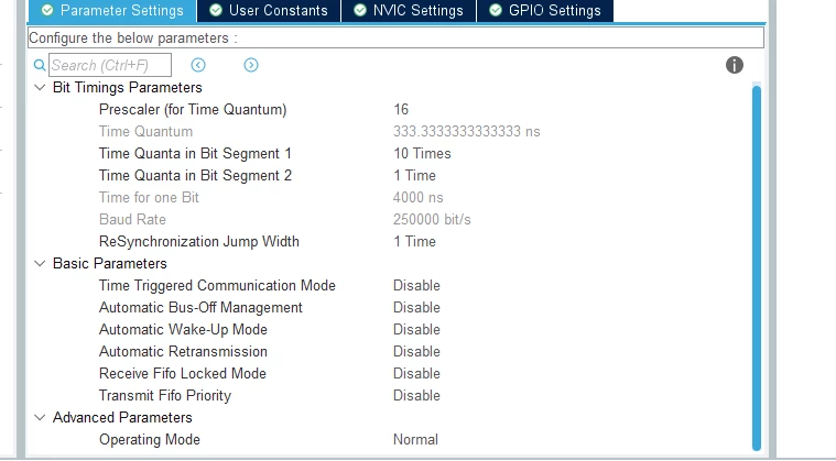

I having trouble getting the correct CAN timing configured with default 96Mhz System Clock on the NUCLEO-F412ZG eval board.
I need a 250kbit/s baud rate.
Here is what I have so far.

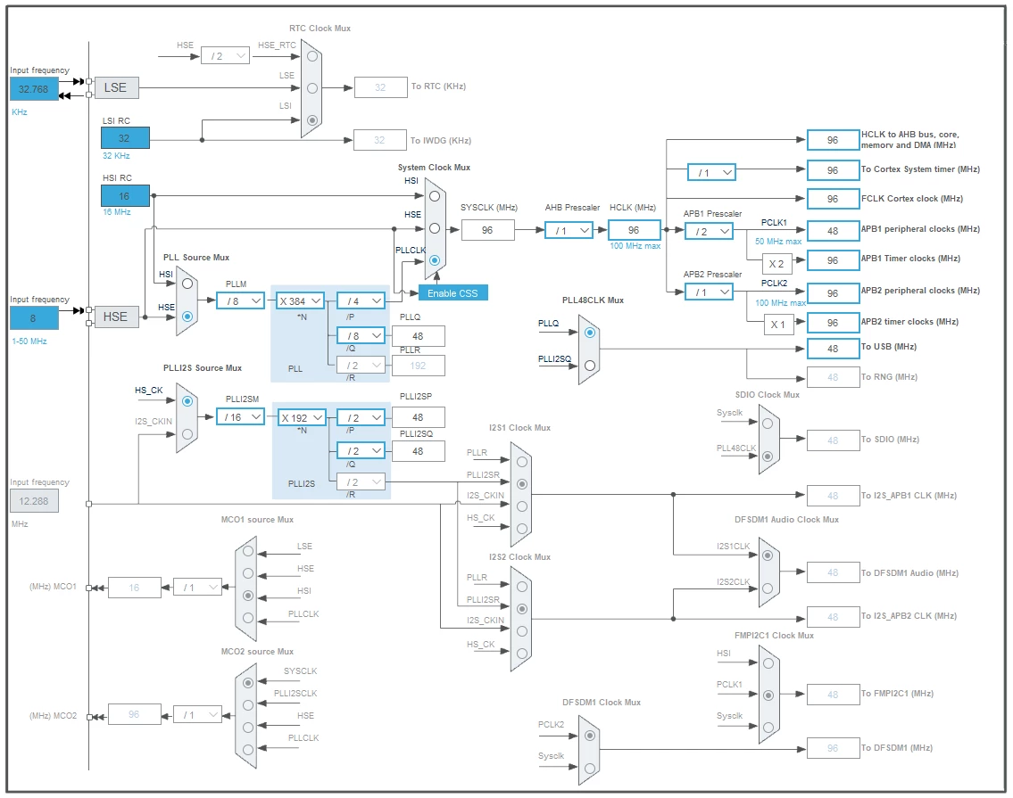

The system clock setup is below.

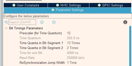

The ABP1 clock rate is 48MHz, not 96MHz.
Try these values to get 250kbit/s
