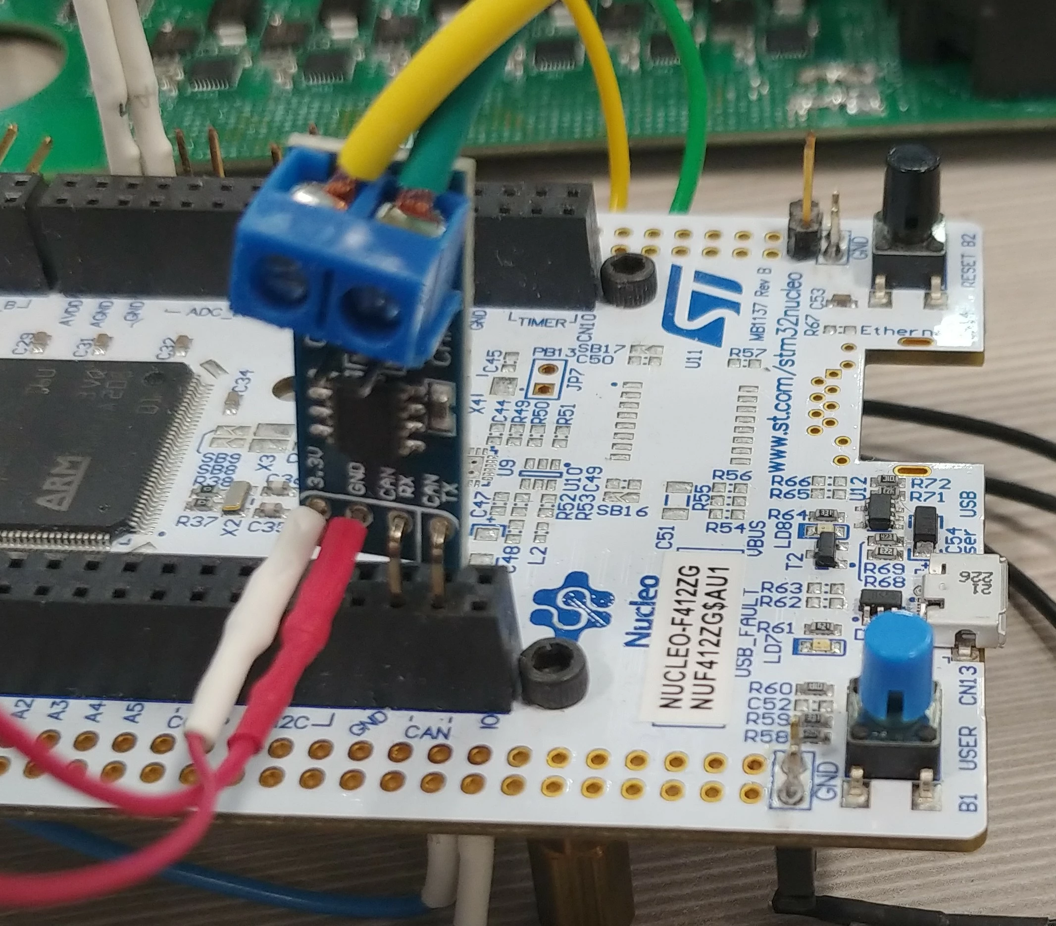

I am using CAN1 pins to Connect to the driver board (SN65HVD230).
All Voltages are good.

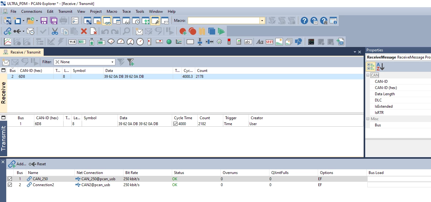

I am using 2 PCAN dongles with 120 Ohm terminations at both ends of the BUS with the Nucleo CAN shown above in the middle of the bus.

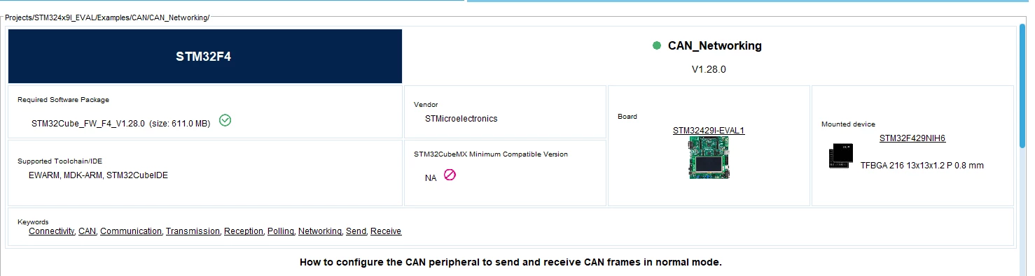

I ported the code from the following project;

The Tx message is not getting out.
Also I have a PCAN message being transmitted on one PCAN dongle and the other PCAN Dongle is receiving the message fine.
The Nucleo pcb does not see the message at all.

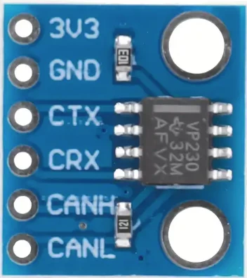

1- Silent mode?
hcan1.Init.Mode = CAN_MODE_SILENT; //CAN_MODE_NORMAL;
2- You need to check your GPIOs: are you sure about the correct GPIOs connected to the transceiver (correct alternate functions)?
3- Are you sure about your bitrate?
4- You need to validate your tranceiver module:

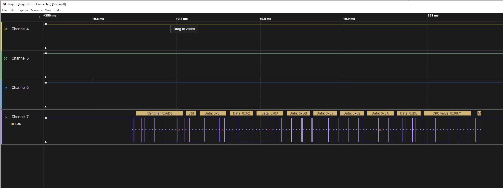

Are you seeing frames on CAN_TX and CAN_RX? If not, you have an issue with your module. Are you sure the transceiver is power supplied? check the voltage on its pins.

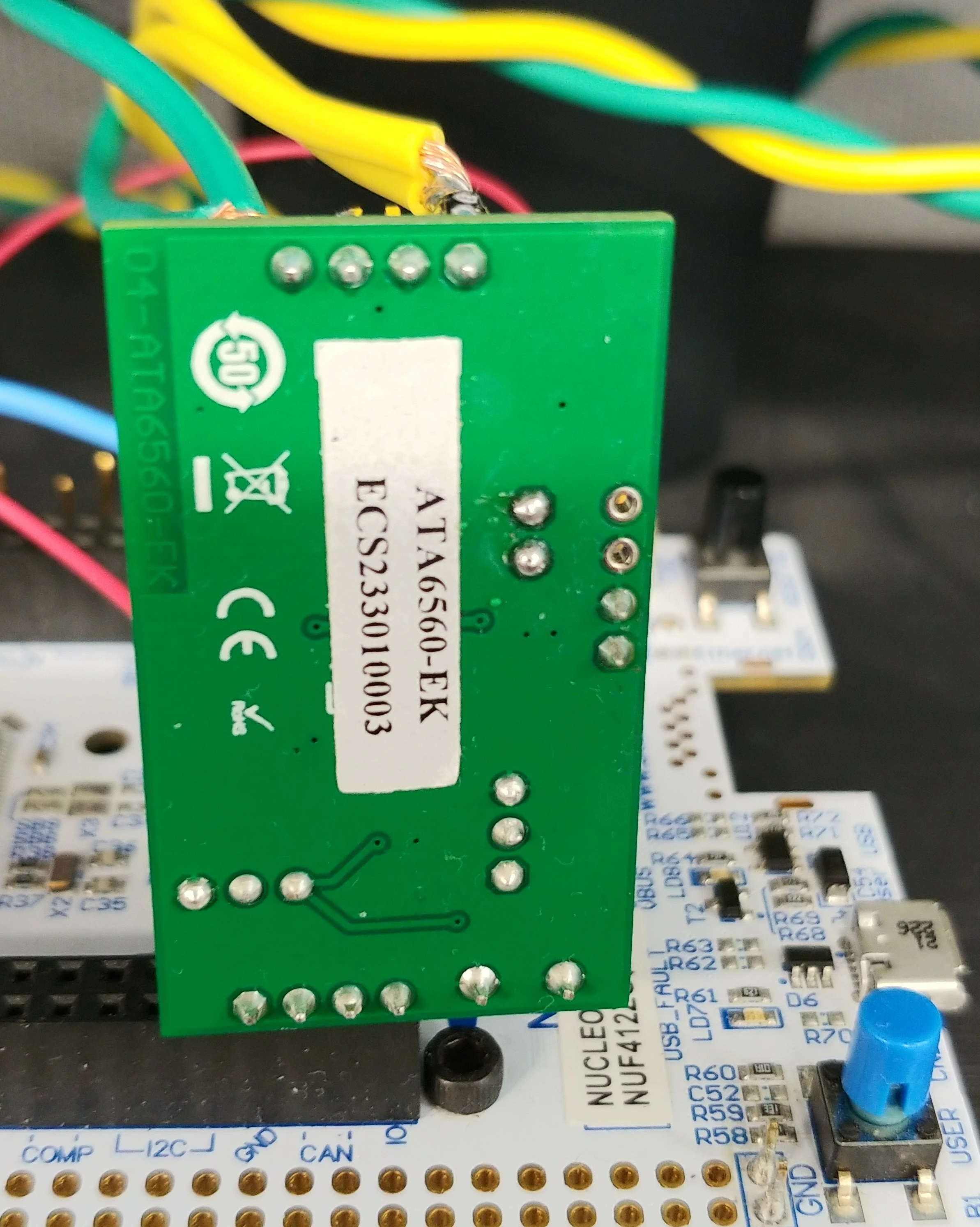

I changed to different transceiver and fixed the Port Pin selection on the CAN_TX and CAN_RX. I had Pin 0 and Pin 1 configured to the alternate selection but it was on port G instead of port D. I also had the CAN_H and CAN_L swapped. I am now working great. Thanks SoftLit and Karl for your help.
