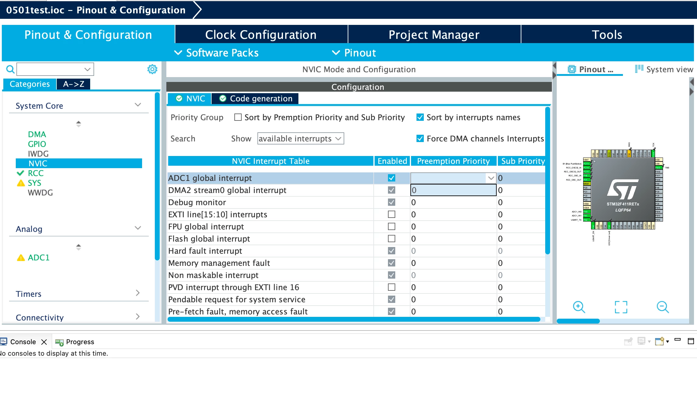

I am trying to set up a multichannel ADC and following YouTube tutorials to create it.
However, the STM32 IDE will not allow me to set preemption priority to 1.

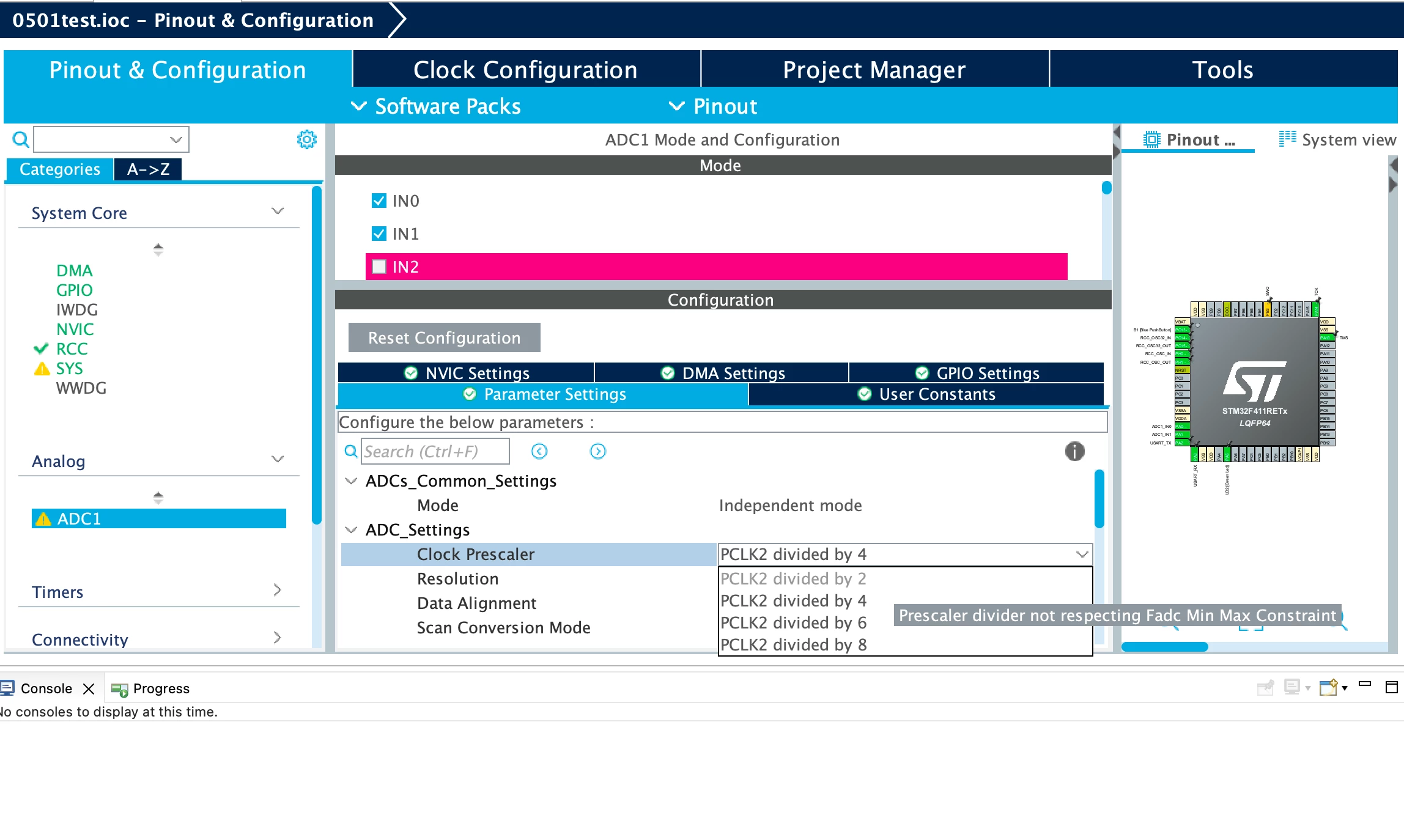

Similarly, I cannot set the clock prescaler as divided by 2.

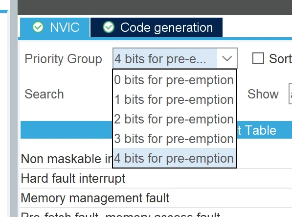

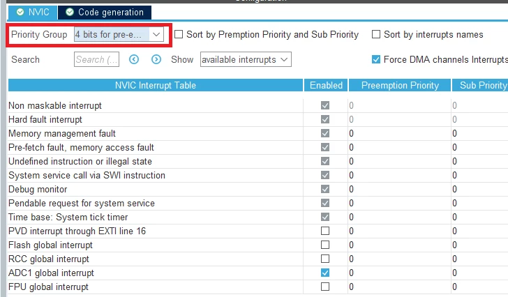

Perhaps you don't have any bits available for preemption priority. What priority group are you using? It's not shown in your screenshot, perhaps it needs resized to fit.
The ADC prescaler can't be 2 based on your clock settings. There are limits on the maximum ADC speed. CubeMX is probably correct to disallow this, but it might be a bug. Impossible to know without seeing your clock settings.

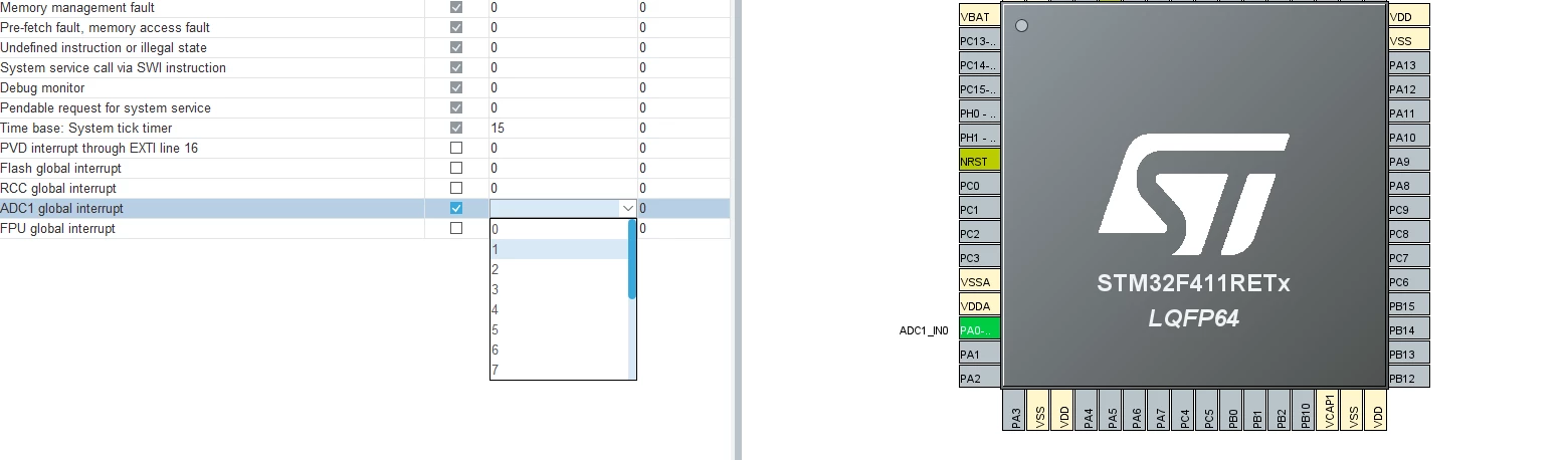

on F411 , i tried nvic -> dma priority to 3 :
and ADC to 5:
no problem. (just mouse click on the field ..)
the greyed out divider 2 :  Cube prevents you to set it to a speed too high for this ADC.

Which CubeMx you're using?
I didn't reproduce the first issue with CubeMx V6.10.0:
For the second question, the popup provides you the answer. You're not respecting Fadc min max constraints. So you need to select the value 4 or more.

What is the Priority Group you've selected for NVIC?
