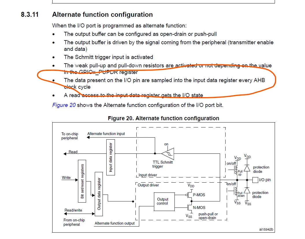

I have Nucleo F401RE board.
I want to Turn On Led When Usart Tx pin high and Turn Off When Usart Tx pin is low.

 The code is above and I always read Tx Pin low...
Is there any other way or solution?

if you use a mask to check a bit you must compare against 0 not 1: if ((GPIOA->ODR & mask) != 0)
If the bit you check is not the LSB the result will not be 1...

Actually I change like below just a test . But GPIOA-> ODR data always zero doesnt change.
USART1 TX pin is connnected PA9... And it transmit data. But GPIOA-> ODR value doesnt change.
I think GPIO ode in AF mode doesnt change ODR register status. Is there any way to read Pin state in AF Mode ????

ilyaz yilmaz
May 9, 2020 12:32 PM UTC
In the Referance manual , it 's written . Below code Works For Nucleo F401RE
	 if((GPIOA->IDR & GPIO_PIN_9)!= 0)
		 HAL_GPIO_WritePin(LD2_GPIO_Port, LD2_Pin , 0);
	 }else
		 HAL_GPIO_WritePin(LD2_GPIO_Port, LD2_Pin , 1);
