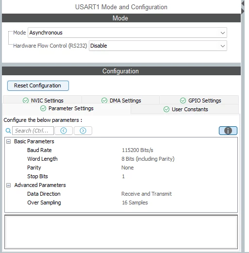

I am using huart1 so the transmit is on PA9 and receive is on PA10. I've hooked up the logic analyzer to PA9 and PA10. To ground the logic analyser i am using pin number 7 on the CN6 connector.

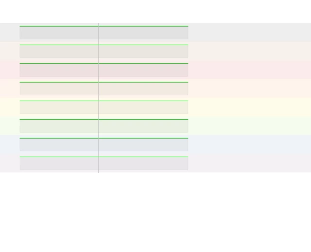

Below is what the logic analyzer is showing. It seems like it is very intermittent. When i am debugging it and get to the stage where it needs to send a signal out, nothing shows up. If i run it continuously i can see the pin fluctuate.

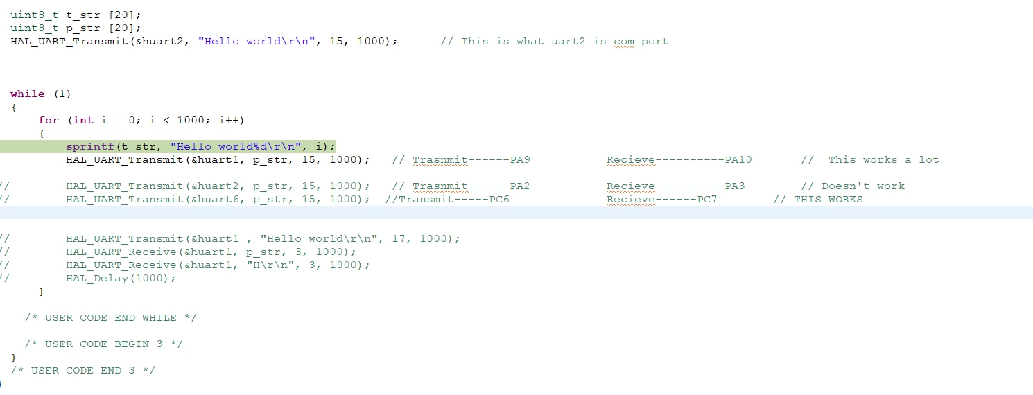

My Code is rather simple.

It looks like a basic transmit. Though you should be using strlen((char*)p_str) instead of hardcoding the number 15 because the string length changes.
If you use the VCP( UART2), do you see your string using something like Putty or Docklight?

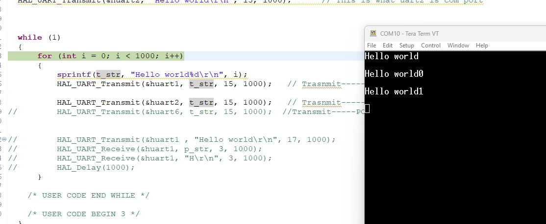

Hi Karl,
So i've taken on board what you have said and i am not transmitting it to huart2 aswell. I can see that hello world is being transmitted onto tera term.
However the signals from huart1 are still not showing up when running it through debug
My code and tera term communication

Your code shows a comment that UART2 doesn't work. However Tera Term shows that it is working. So it looks like it's an issue with your logic analyzer?
Maybe try a basic blinking LED or GPIO pin at 1 KHz and see if the logic analyzer works picking up that signal?

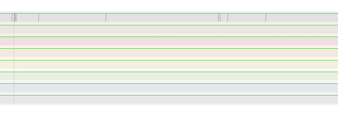

Need to fine tune the timings of your logic analyzer (decrease the time scale) an set a trigger on the falling edge

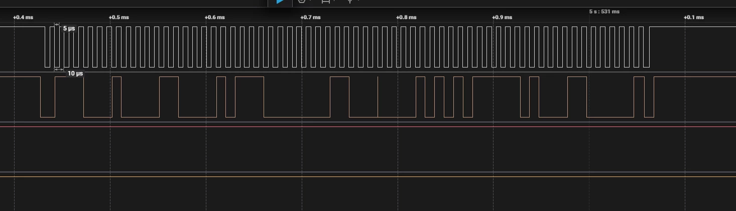

Hi SofLit,
