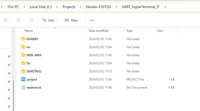

The Document you referred to did not help, but In the directory of the project I want to import
I have multiple sub-directories. When I import do I select the whole folder called UART_Hyperterminal_IT or do I select the sub-folderSW4STM32?
When I import, it does not as if I want to convert the files.

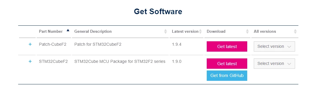

For that, could you please try to download the STM32CubeF2 from this link

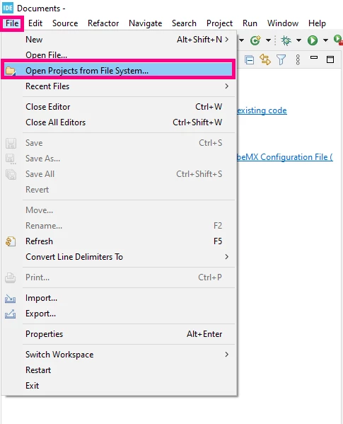

2- Click File-->Open Projects from File System as shown in the below figure

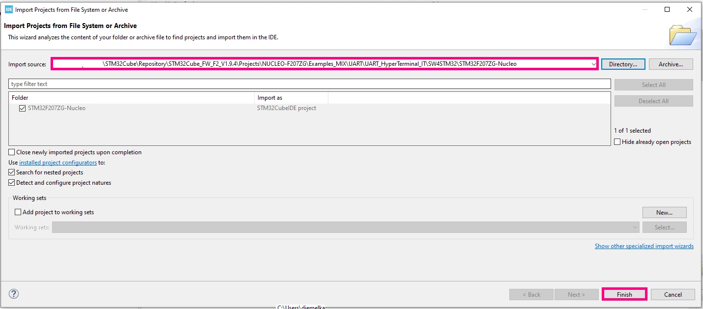

3- Browse the Demonstrations\STM32CubeIDE project file located in this path "\STM32Cube_FW_F2_V1.9.4\Projects\NUCLEO-F207ZG\Examples_MIX\UART\UART_HyperTerminal_IT\SW4STM32\STM32F207ZG-Nucleo" as shown in the below figure

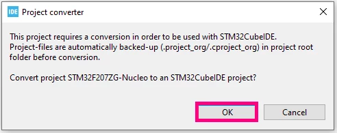

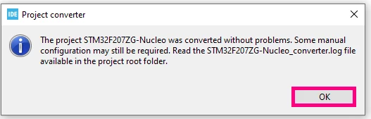

4-Click on OK to import convert the project
5- Build the project
