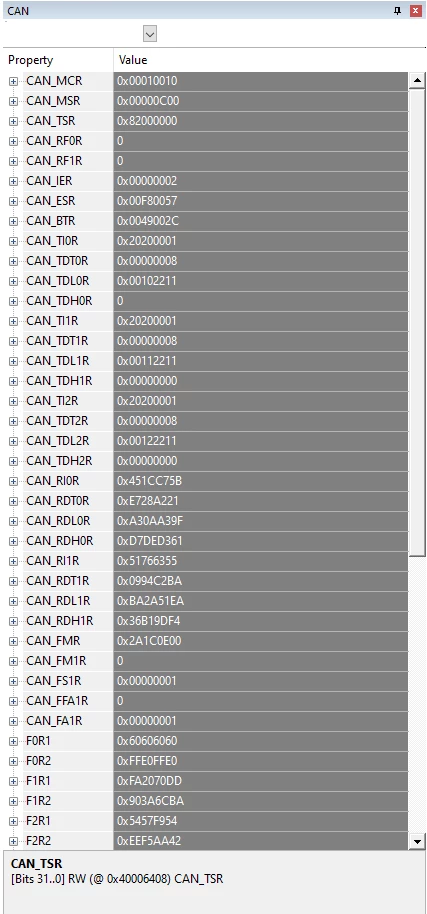

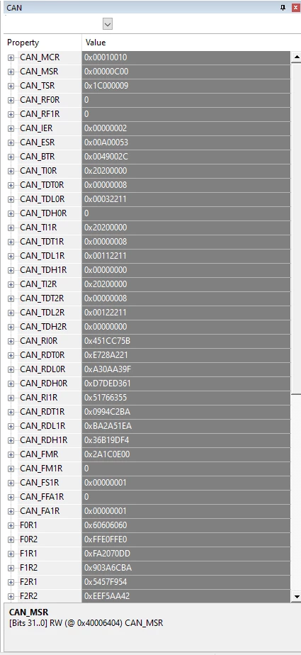

I have a problem with canbus on nucleo-f103rb. When I start the debug the registers look like before.png. After a while its look like after.png. But i cannot send any data to peak pcan in both cases. Here my code;

Visitor II
November 19, 2023
You've set the filter to accept messages with the ID 0x303. Make sure this matches the ID of the messages you're trying to receive. In your callback function (HAL_CAN_RxFifo0FullCallback), you're incrementing datacheck. After incrementing, consider adding some breakpoints or print statements to verify if the callback is being triggered and if the received data is correct.
