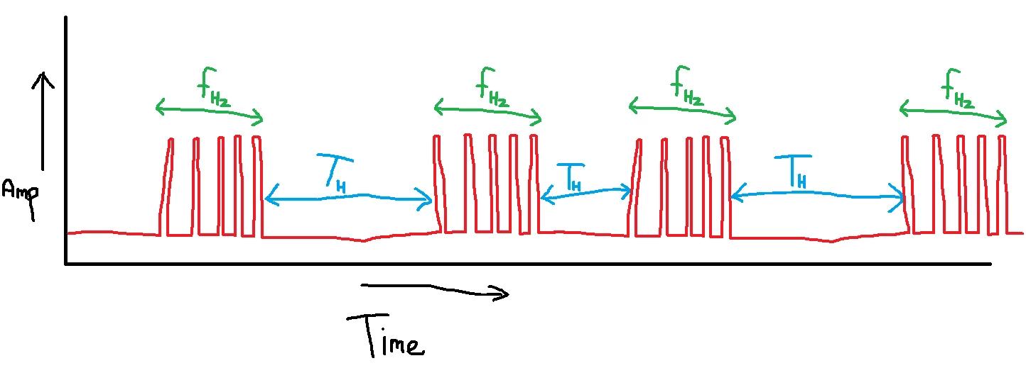

Hello All,
I want to generate a different type of PWM along with its phase shift PWM as well. Below is the diagram for the output waveform. I am using the NUCLEO-F030R8 board as of now.
Where Fhz and Th are the same for all instances as shown on the image, they also need to be changed on run time.
Waiting for assistance.
Thanks

I don't know what's "phase shift" in this waveform, but one way how to generate such waveform is to run two timers in master-slave interconnection - slave would generate output using PWM at the higher fHz frequency; master would generate PWM (without outputting it to a pin - unless you want to check it) which determines the "envelope"; slave would have set the slave-mode controller in TIMx_SMCR in Gated mode.

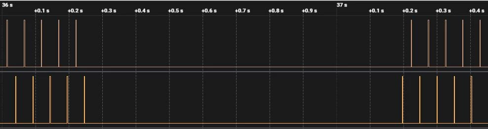

_legacyfs_online_stmicro_images_0693W00000dJvcfQAC.pngSo actual wave which I am trying to generate is similar to this.
Where the frequency and duty cycle are the same only difference is a phase shift.
waclawek.jan
June 2, 2023
I still don't understand: you want to generate both signals on two pins of the STM32? And the phase shift is variable somehow? Also, there lower signal on the left-hand side is shifted to the right, whereas on the right-hand side is shifted to the left, or there is one more pulse within the bunch, can you comment on that?

June 2, 2023
@Community member the image which i attached is cropped and is just to represent what i ment by phase shift. Let me clearify that yes it is just shifted a bit.
Nop I am not able to generate the any of the single. But i am able to generate a continuous PWM that's it.
(Note: it is just a cropped image and just for representing purpose it is not the exact one.

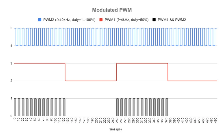

What i came across is that to generate the wave form (as similar to question - just a single wave form as per image) We need two pwm which can be logically & to get the resultant out put.
Is that true?
Is there any other way to do it without using any addon timer. Like combine pwm output?
I came across post where something similar is required. I need help to understand the same. Putting refrence link and image.
Link
https://community.st.com/s/feed/0D50X0000C4PPGhSQO
Image is just for reference and not represent exact requirements of frequency and duty cycle.

Final output waveform need to be similar as black color waveform in PinX and 180° phase shift of same wave form in PinY. Thats what the final goal is.
Sorry if it is not proper here or in any of the above comment.
HA.5
June 5, 2023
ok i got it now, so you need sth like the black color, for example on PA9 a signal, and on PA10 with 180°phase shift another one. as i see on the picture you need a pasue(delay) between them too.
so as said before you can use one Timer (as i wrote the code) with phase shift what you want(but 2 different duty cycles) to reach that, but if you want to have the same duty cycle too, you should use 2 timers and not only one(as far as I know).
i can write you the code with 2 Timers if it is what you help
HA.5
June 5, 2023
there is also another way to produce that with only one timer, you can use bit patterns and interrupt. so in this way you can generate the pulses by set and reset the pins and not using HAL_PWM_START functions.
