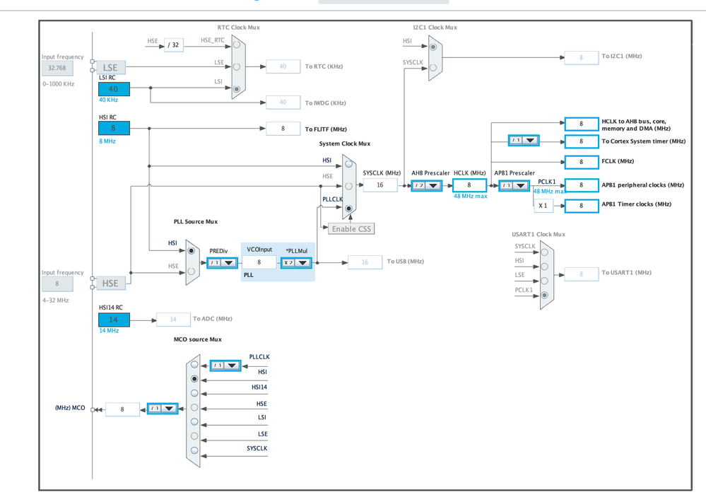

Hi 'I am using STM32 Nulceo Board Nucleo-F070RB .
I tried some projects but the output of the project is not as expected ,shows some wrong calculation out .
So I checked everything ,And found out the Crystal frequancy is not correct .
I checked the Master Clock Output But here i am not getting the clock frequency ,
May i get the accurate frequency there ?
I  tried the internal HSI also But nothing gain
When I select HSI is 8MHZ i am getting in MCO out is 1.724KHz  is it board problem ?
what wrong i am with ,
please help me
10 replies
AScha.3
April 27, 2024
How you know ?

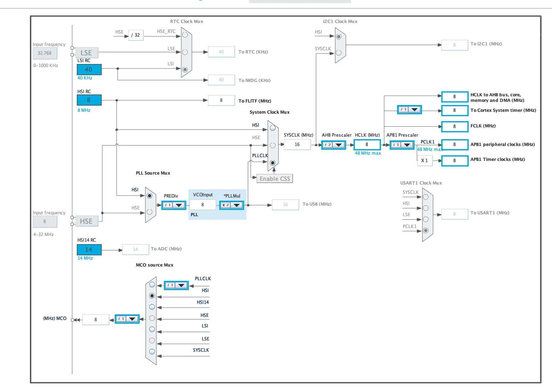

Show your clock tree , so i can see something ... !
thannara123
April 27, 2024
see the clock tree I am checking on logic 2 logic analyzer
AScha.3
April 27, 2024
Ok, you want the cpu run at only 8 MHz ? why ?
>HAL_GPIO_TogglePin(GPIOC, GPIO_PIN_8); // this pin is used as output signal
This is just toggle the pin in software - has nothing to do with any timer !
MCO is set to HSI - not pllclk .

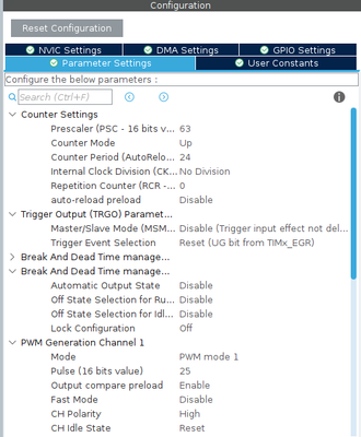

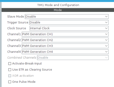

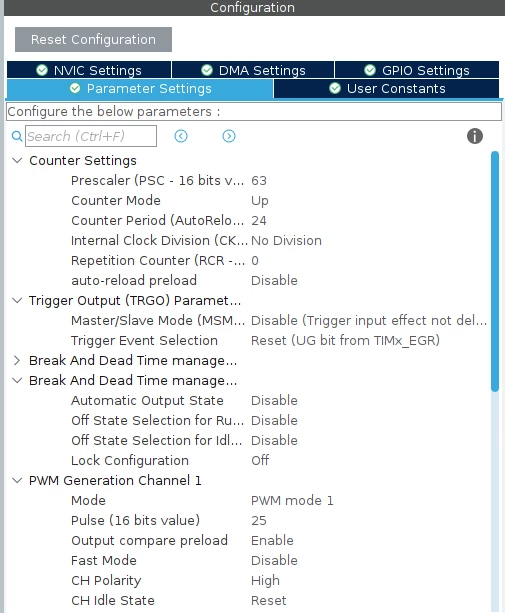

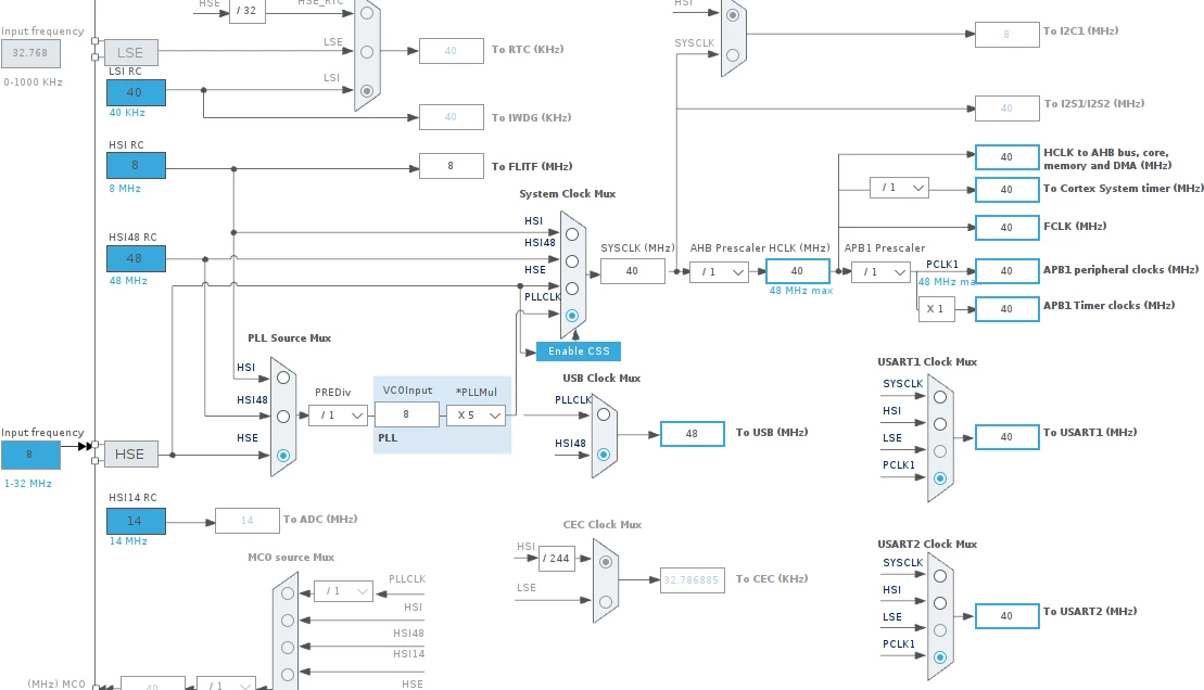

so for 40MHz set clock tree:

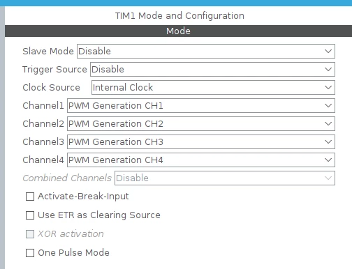

To do some timer output, set any output active : or all ->
here my setting, as example:

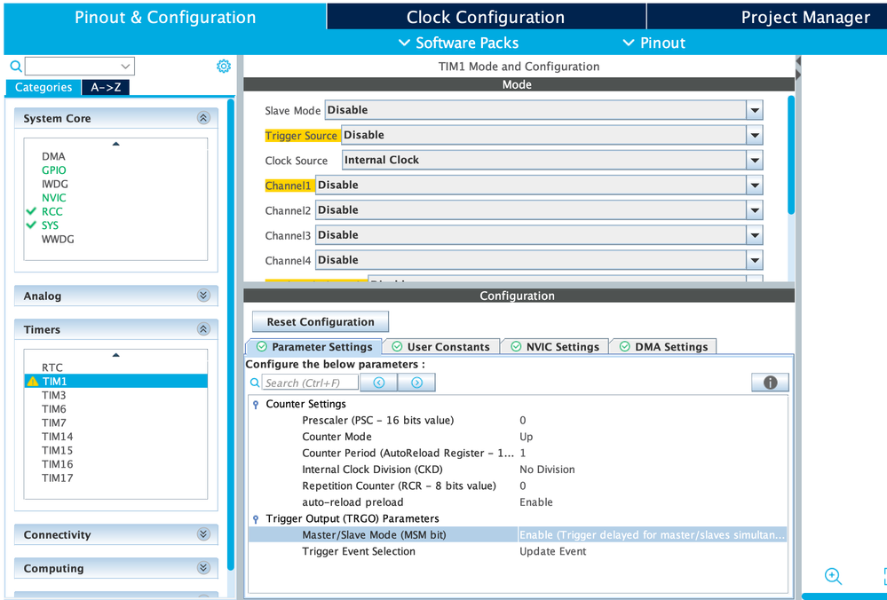

thannara123
April 27, 2024

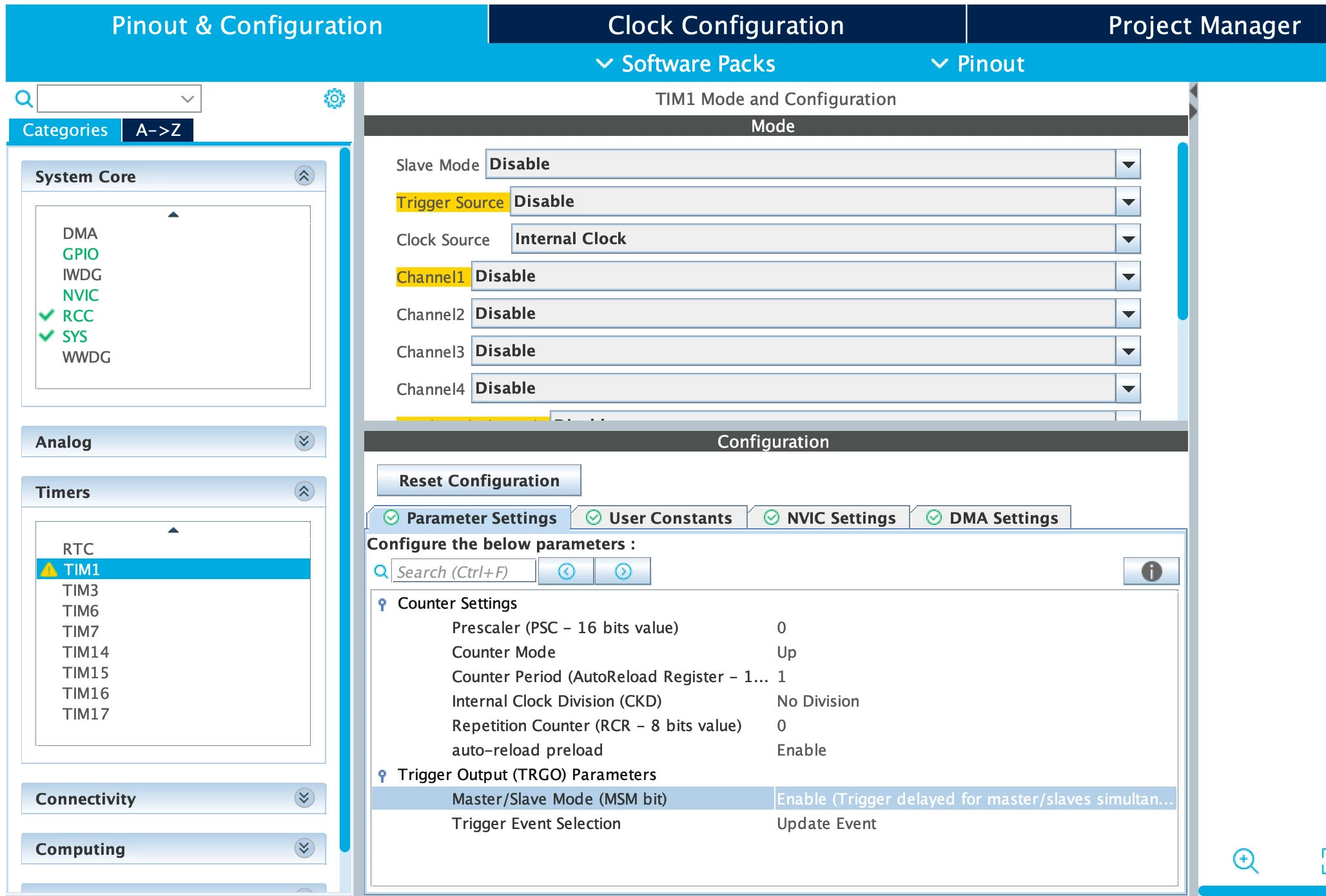

When I try TIM1 to generate a siganl
Here Timer Clk is 8MHZ no prescalar
ARR is 1
so it will be the half of the signal will be timer output ie,4Mhz but here i am getting 11.08 khz
void HAL_TIM_PeriodElapsedCallback(TIM_HandleTypeDef *htim)
{ if (htim->Instance == TIM1)
at diffrent ARR value nothing happen 11.08khz is the out .is this cub ide bug ? or what is the problem ?
