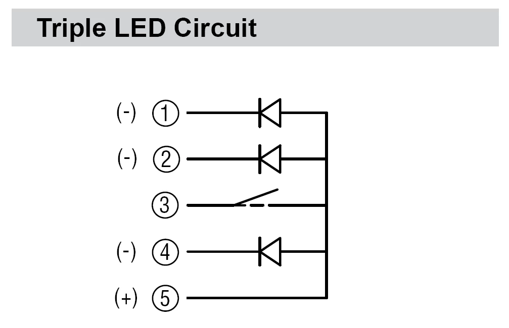

I have been looking to power some LEDs which require 25mA supply at 3.3V. This is above the capabilities of this Nucleo-64 board as it is stated that the maximum GPIO supplied current is 20mA per pin (100mA total across all pins).
For reference, this is the circuit I would like to connect which is part of the Bourns PEL12T rotary encoder. Pin 5 is supplied a 3v3 source and all other LED pins are held high. When the LEDs need to light, the GPIO pins should go low allowing current to flow.
Would it be better to use an external 3V3 power supply to power pin 5 only, or desolder SB5 (which disconnects internal 3V3 regulator) and power the whole board by plugging the external 3V3 supply to the 3V3 pin on the arduino or morpho header.

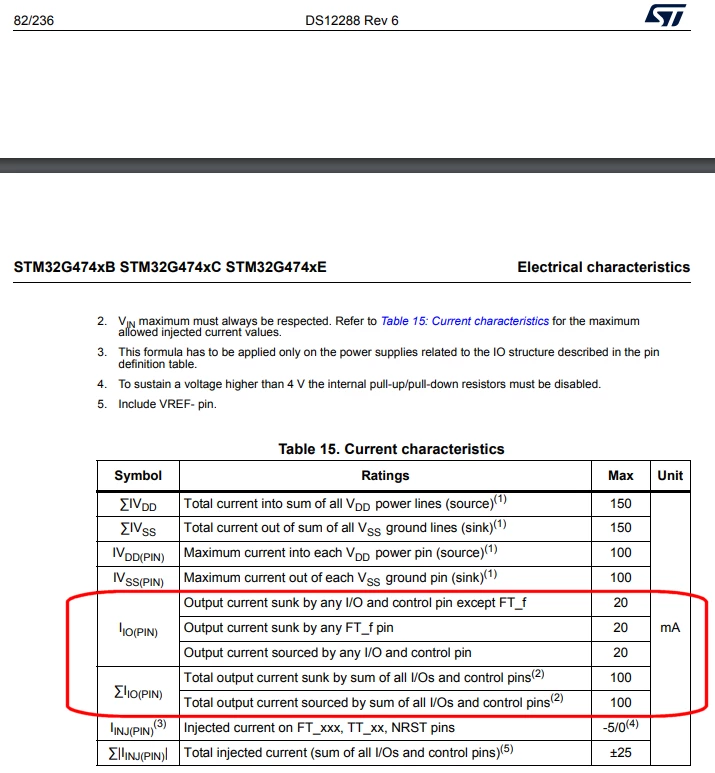

Are you sure that's a Nucleo board specification ?
It sounds like a specification (limit) for the STM32G474RE chip ?

hmcbAuthor
July 1, 2024
Thank you for the speedy reply!
It looks like you're right, so I guess this means that no matter the supply, no more than 20mA can be supplied by or to the GPIO pins?
Meaning I need to use a transistor based solution to drive and switch the LEDs.
Andrew Neil
July 1, 2024
Correct.
