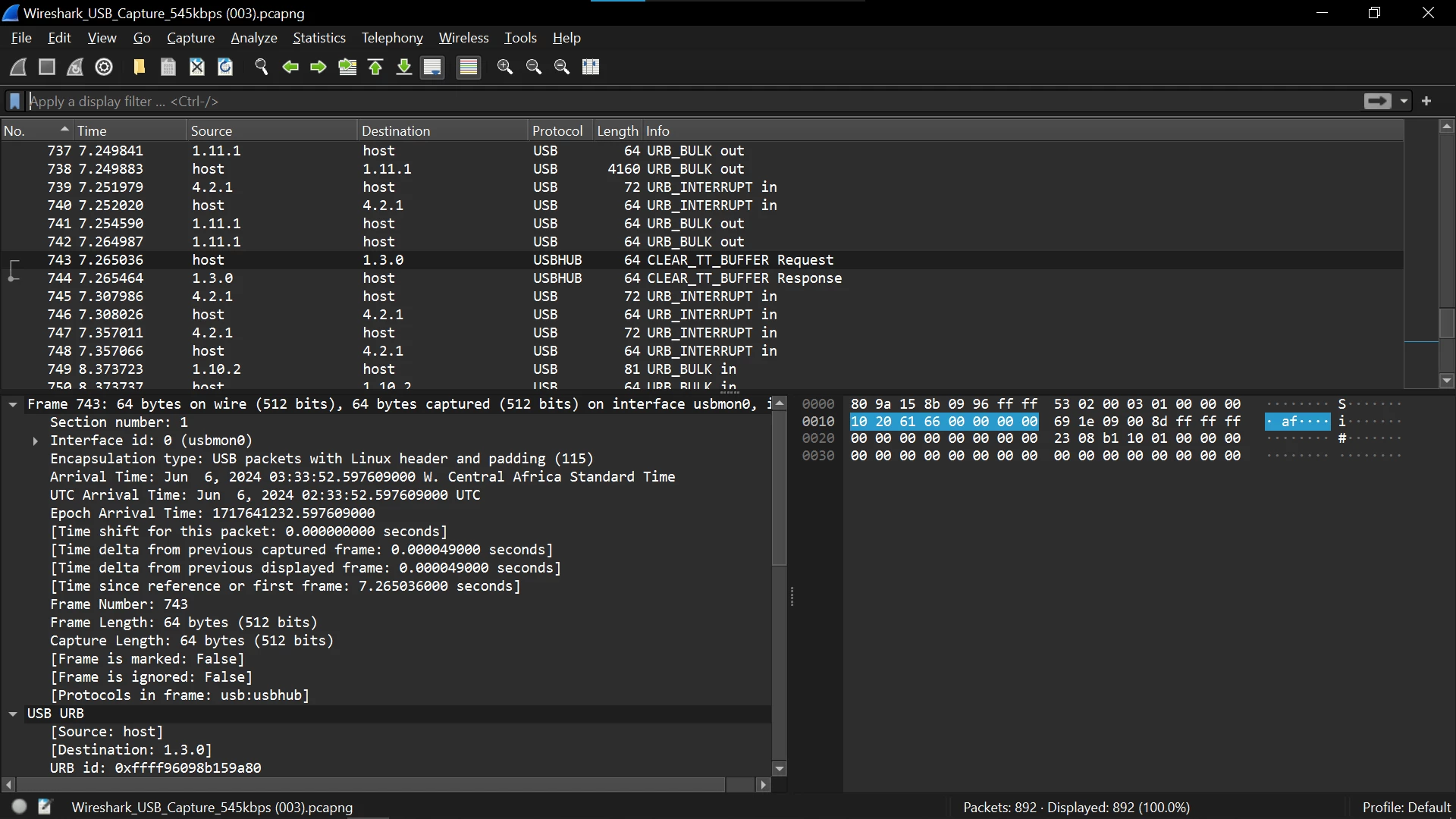

7. Since dd achieves good OUT throughput, I looked at what's going on the USB bus using wireshark
(which can anazlyze USB traffic at the URB level). What I saw is that here too, a few pending
IN transfers are initiated at the start of the application and never complete. even though dd
transfers data in strictly one direction. So there must be something about this that's required

See attached 7z file. Your forum for some reason believes that zip files are a security risk, but rar and 7zip are not. Crazy.
I can't tell you what's happening on the wire, but the two wireshark capture files therein show you what's happening at the URB level (and their timestamps). There's not much to see. One of them (the fast one) has an IN URB submitted at the start of the communications, and the other - doesn't. This small difference causes throughput for one case (with IN request) to be 950kpbs  but only 545kbps for the other version (no IN request) .
Both captures are of a small libusb based host-side application I adapted from some online code, which runs in libusb async mode (if you're familiar). Essentially, I have an API call which sends an IN request before starting the HOST->DEVICE continuous transmission. I can comment out the line or not, and this causes the difference.
The "fast" version overall corresponds to what wireshark captures when I use dd to send data to the device. for some reason, dd also submits a phantom IN request before starting. I've searched high and low, and asked on the libusb mailing list, and found no evidence that the USB spec requires this odd behavior.
I did these test on an old linux box which has an ICH9 controller. The STM32 code is just the basic code generated one (as far as I can remember).  main is just an empty loop. Here is the callback code. As you can see the receive callback does nothing but acknowledge the packet. If I recall correctly, the transmt calback never gets called anyway (since my firmware never sends anything).

Hi @BarryWhit
> when there are no IN transfers pending, please let me know. Is it a USB spec requirements?
 IN transfers (device to host) should not impact OUT transfers (host to device) in terms of functionality
If you are not using transmitting data or status information back to the host, you might be considering disabling the IN direction (disable the TX).
but apparently, with the STM32 USB stack - they do.
> For the OUT direction (host to device), you can use cat to send a file to /dev/ttyACM0
That's not helpful. I already mentioned tests performed with dd. I know that dd gets better throughput, and I've achieved the same throughput if I send a "useless" IN request before starting the transfer. My problem is not how to achieve better throughput, but to figure out why the STM32 USB behaves so strangely in this respect. You  say yourself IN requests should have no impact on OUT transfers - but they do and i've given you the mens to reproduce this yourself.
> This method is efficient because it does not involve any additional processing of the data;
Irrelevent. As I stated, I get 1mbps with my host application if I send an "unnecessary" IN request at the start of comms, so it's clear this is not an efficiency/overhead issue (on the host side). This 3Ghz CPU can easily keep up with 1mbps, and so can libusb.
I was hoping for a more informative answer then "It shouldn't happen. But since it does, just have your windows users use `cat`". Come on.

June 28, 2024
But@BarryWhit USB is half duplex, it achieves bidirectional communication over the single differential pair by switching between sending and receiving data, but it cannot do both simultaneously.
When you are referring to having a pending IN transfer to achieve good OUT throughput is confusing. Maybe there is something else I'm missing.
