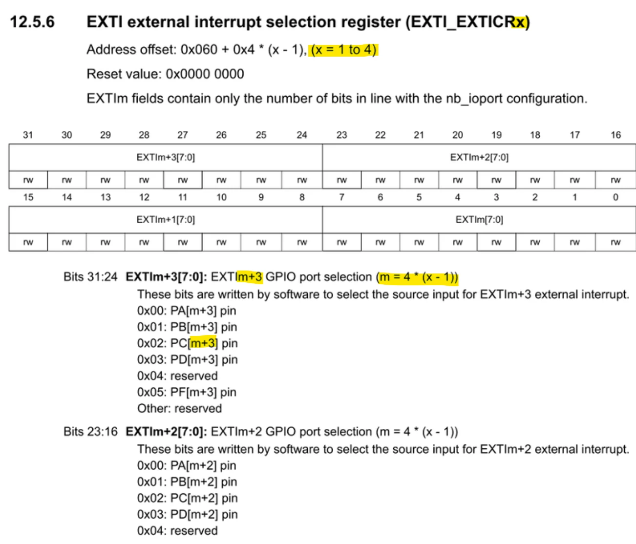

Is the LED off if you comment out BSP_ledOn()? Your code only turns the LED on, not off. If it's on to begin with, pressing the button won't do anything.
Need to set port C in EXTI_EXTICRx register.
in the interrupt, you should check for and clear the EXTI flag for pin 13 in EXTI_FPR1, and only turn on the LED if it's set. Don't need to do anything with NVIC functions or register.

Thank you TDK, I should've clarified, the interrupt is always on,  when I set a breakpoint at the interrupt, it breaks all the time, hence the LED is always on.
I added code for FPR1 to clear that bit and the LED now blinks very fast that it is barely on, looks like d flicker.
I haven't figured out how to use EXTI_EXTICRx yet. Looks aweful convoluted and will take more time.

The RM is a little confusing, but I think it's all written correctly.
> I need help with figuring out what x and m are and what exactly is nb_ioport?
For the EXTICR4 register, x=4. m = 4 * (x - 1) per the manual, so m=12 for this register.
nb_ioport is the pin number. It's 13 for PC3.
EXTICR1 configures pins 0-3, EXTICR2 configures pins 4-7, etc, so EXTICR4 configures pins 12-15.
x=4 in EXTICR4, so m = 4 * (x - 1) = 12, so you want to configure the EXTIm+1 register, which is bits 8-15. Write a 0x2 there.
EXTI_EXTICR1_EXTI0_0 is bit 0 of the EXTI_EXTICR1_EXTI0 field, and so on. This is the standard convention with all the CMSIS register defines.
Does that help?

See the highlighted regions. (EXTIm+1 is on the next page, same idea though.)

How was that supposed to be helpful? What is m and what is x? I already copied and posted the manual gibrish.

This code is for PA8 on a C011:
void EXTI4_15_IRQHandler(void) {
 if(EXTI->FPR1 & EXTI_FPR1_FPIF8) {
 // do something
 EXTI->FPR1 |= EXTI_FPR1_FPIF8; // clear pending bit
// make PA8 EXTI interrupt
void init_EXTI() {
 RCC->IOPENR |= RCC_IOPENR_GPIOAEN; // enable peripheral clock
 (void)RCC->IOPENR; // read back to make sure that clock is on
 GPIOA->MODER = (GPIOA->MODER & ~GPIO_MODER_MODE8_Msk) | (0 << GPIO_MODER_MODE8_Pos); // input mode
 EXTI->FTSR1 |= EXTI_FTSR1_FT8; // enable falling edge of Px8 (x=any port), we use it for PA8
 EXTI->EXTICR[3] |= 0 << EXTI_EXTICR3_EXTI8_Pos; // set port to A for PA8
 EXTI->IMR1 |= EXTI_IMR1_IM8; // EXTI CPU wakeup with interrupt mask register
 //EXTI->EMR1 |= EXTI_EMR1_EM8; // EXTI CPU wakeup with event mask register
 NVIC_EnableIRQ(EXTI4_15_IRQn);
What you have found (12.5.6 EXTI external interrupt) plus Table 47. EXTI controller register register map and reset values explains it. Yes, each 8-bit block in a EXTI_EXTICRx is a bitmap of the enableds ports.
hth

> Doesn't that mean that x1 is for bit 0-7
No, these are the GPIO port selection bits.
